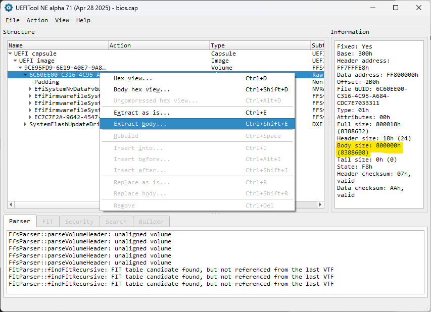

              #47
              Easier method:
              Extract the downloaded .exe from Lenovo website with innoextract
              https://github.com/dscharrer/innoextract
              If you only have the first .exe and nothing else (like the BIOS on 1st post), follow the step on 1st post to extract it
              Code:
              5PCN20WW.exe /ext
              Note: On newer BIOSes you'll get to the bios.cap after extracting with innoextract
              Once you get to the bios.cap, open it with UEFITool NE A72
              https://github.com/LongSoft/UEFITool/releases
              Expand the UEFI capsule -> UEFI image -> (GUID) => (another GUID)
              You'll see something like this:
              Click image for larger version  Name:	lenovo phoenixtdk uefitool.png Views:	0 Size:	63.1 KB ID:	3733752
              Notice the Body size section, it should be the same size as the BIOS region (for Intel, open the BIOS dump with UEFITool), or the dumped BIOS from the chip (for AMD)
              Right click on the second GUID (pictured above for reference) -> Extract body, you'll have your BIOS region* (Intel), or the full BIOS ready to flash (AMD), DMI can be added to it later
              * On Intel platforms, use UEFITool 0.28 to replace BIOS region on the BIOS dump from flash chip, regular procedure for cleaning ME region applies (if needed)
