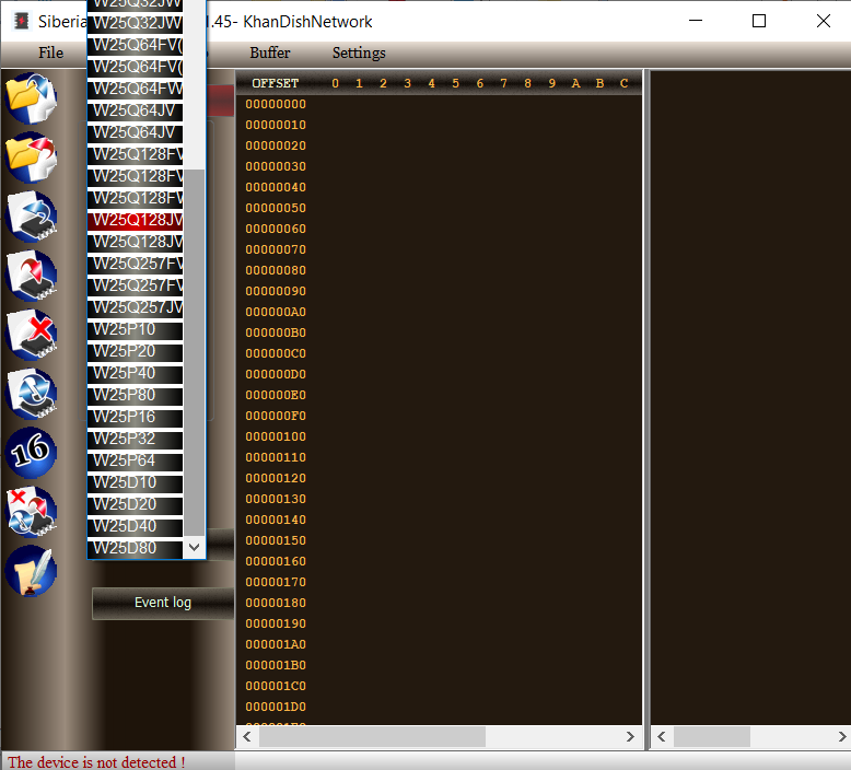

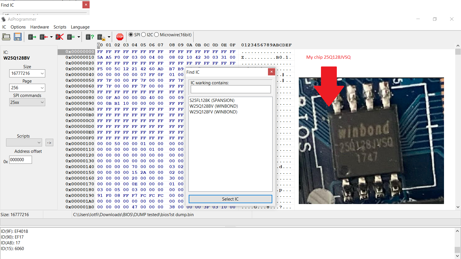

                  • Moonstone2438
                    • Feb 2023
                    • 4
                    • Brasil
                    Re: RCUnlocker
                    Hello friends,
                    I'm trying to unlock my bios, I lost the password of my HP Probook 440 G5 Laptop. But my problem is when I try to dump my BIOS AsProgrammer gives me two chips options in "Find IC" but my BIOS chip is Winbond 25Q128JVSQ
                    W25Q128BV (WINBOND)
                    W25Q128FV (WINBOND)
                    Wich option should I choose to unlock?
                    Thank you screenshots below
                    Sorry if the question isn't in the correct thread
                    • Moonstone2438
                      • Feb 2023
                      • 4
                      • Brasil
                      Re: RCUnlocker
                      The program "SiberiaProg CH341A v1.45" seems to list chips closer to mine but the text seems to cut out. In any case dumps seem to unlock whatever IC I choose so is it crucial? I'd like someone's input before I try to not kill my bios.
                      Thank you

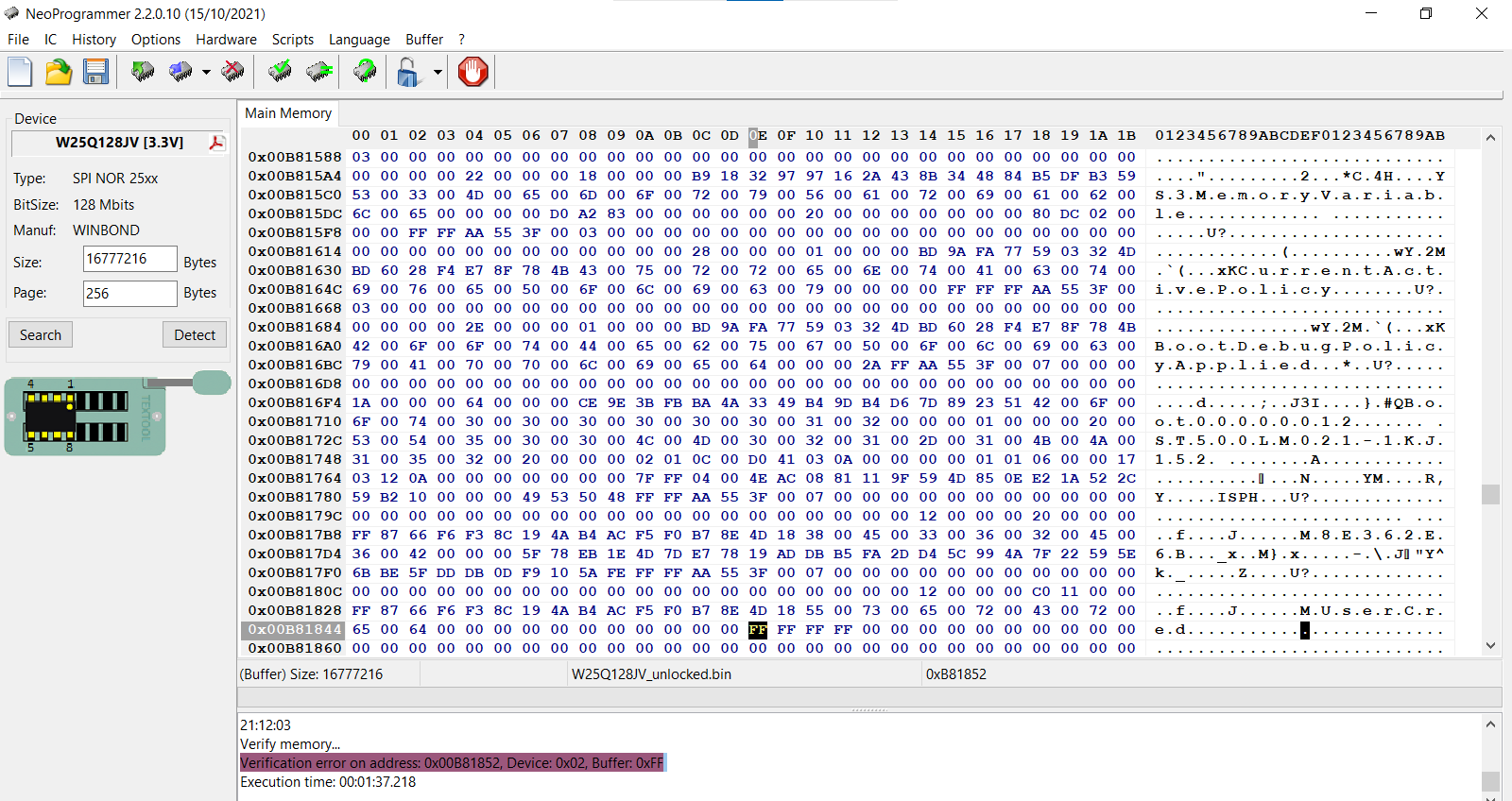

                        • Moonstone2438
                          • Feb 2023
                          • 4
                          • Brasil
                          Re: RCUnlocker
                          Originally posted by Vesko356
                          Thank you for your reply, so W25Q128JV works for 25Q128JVSQ? It gave me a validation error
                          • Vesko356
                            VIP Moderator
                            • Aug 2018
                            • 4386
                            • Bulgaria 🇧🇬
                            Re: RCUnlocker
                            Yes.
                            It's almost always happening when you have a bad contact between the chip and the programmer - clean the chip with alcohol, do not use a clamp...
                            Become a Badcaps supporter
                            Thanks to all supporters.​
                            • Moonstone2438
                              • Feb 2023
                              • 4
                              • Brasil
                              Re: RCUnlocker
                              It worked after several tries and clearing everything, thank you so much for the help man. This is my only laptop you saved me.
