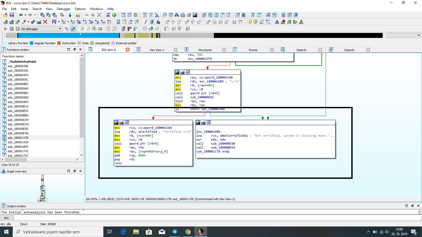

    Hello i am trying to edit toshiba bios image to accept any response code

    What's the point of this?
      If you have response code generator to share then there is no point. If not, it was to remove bios password on toshibas. Sadly it is signed code so not possible to modify like this.

        Yes correct bios cannot modified if modified laptop no give display.

          Thats why I asked. There is no point editing bios files like this. Never had luck modifying bios rom's with a hex editor or disassembler. I believe every bios has at least a checksum check.
          I'd rather flash a clean bios with code signing intact. I don't think that it is locked to a cpu serial number or something else. Correct me if I'm wrong though.
          It would be interesting to know which device checks the signing. If it is a routine in the bios file itself you could easily manipulate it. if the EC or PCH has a check for it then there is no way around it.

            Password stored in ec/kbc so flashing clean bios has no point.
            I modify bios files all the time to remove passwords. Even made a modifying tool for HP which only has positive feedback thus far

                EC/KBC can be programmable and not programmable. When it is not programmable, it might have an eeprom next to it. When it is programmable, it has internal eeprom.
                When password is stored in EC/KBC (doesnt matter what kind), it is not possible to clear it by flashing a clean bios on main eeprom. Yes, it is possible to clear password from EC/KBC by flashing that with a clean file but this is often difficult because it might not be a soic8 eeprom.

                  Start with something easy by modifying strings, but as RethoricalCheese or imranromi mentioned, it won't work as it seems that upon powering up, bios checks for firmware integrity.
                  I tried with a Tecra A9 with legacy bios, after modification it didn't give display output. With UEFI bioses seems easier to modify modules, but I haven't tried.

                    Password check: BIOS
                    out_buf = call_EC(
                    func=0x24,
                    in_buf=MD5(input)[:8] + pwd_type
                    out_buf[0] == 0 ⇒ success
                    • przemek_79
                      • Dec 2014
                      • 28
                      • Poland
                      Re: edit toshiba bios image to accept any response code
                      out_buf = call_EC(
                      func=0x24,
                      according to the author, just rewrite this code to python and you can generate the code yourself
                      https://cdn.badcaps-static.com/pdfs/...b4ab0f2e13.pdf
                      Challenge: BIOSout_buf =call_EC(func=0x1A, in_buf=rdtsc()+MD5(pc_serial)[:8])challenge = bytes_to_string(out_buf)
                      Response: BIOSout_buf =call_EC(func=0x1B, in_buf=string_to_bytes(user_input))out_buf[0]⇒ success/fail
