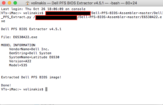

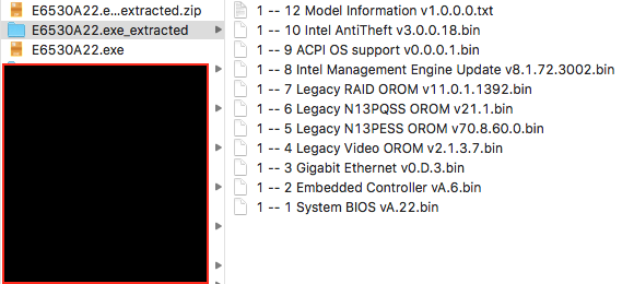

    I eventually was able to extract out a set of .bin files using a python script that was downloaded as part of the BiosUtilities collection on github. However, none of these 11 .bin files do not match the file size of my original (corrupted) dumps which should be 4MB and 8MB.

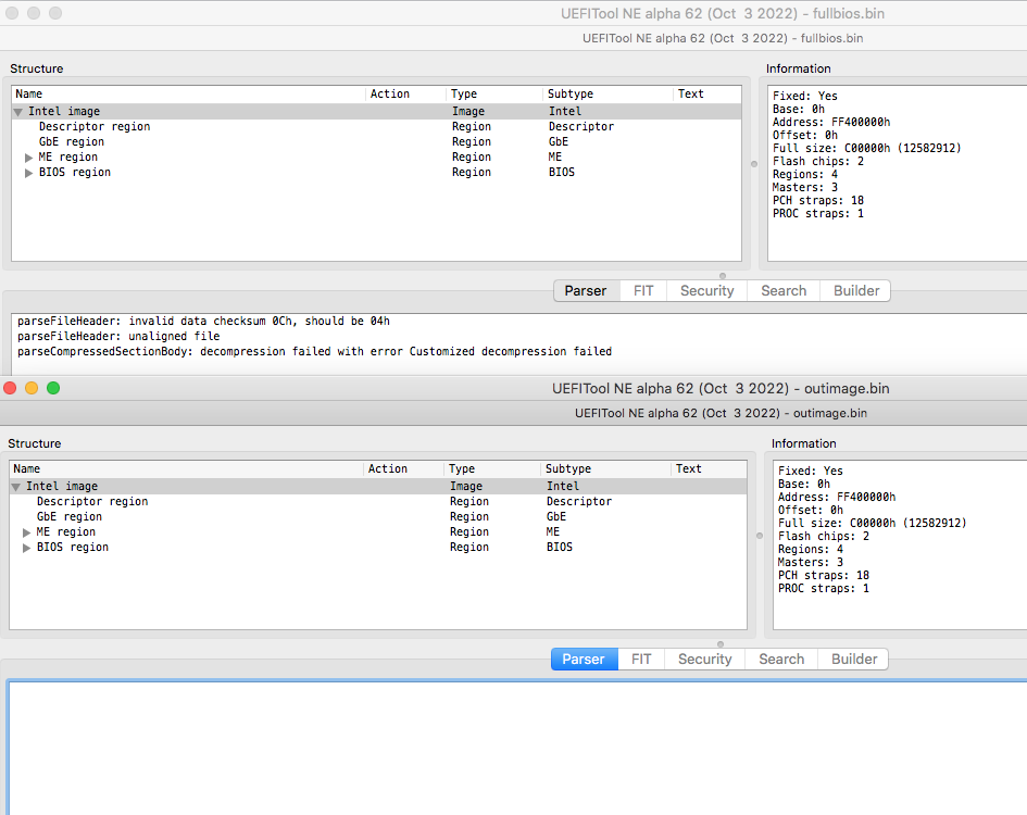

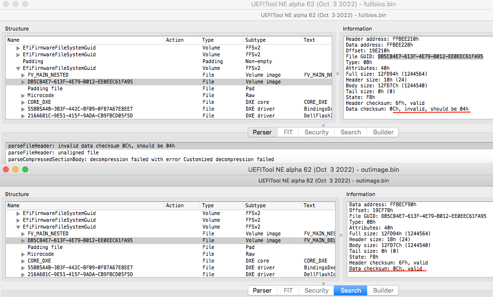

    extracted files from update exe. I used Dell-PFS-BIOS-Assembler-master from github. you have to merge both files and replace modules with UEFITool. Using FIT Tool to clean ME it will split files in right sizes.

      Hi. Thanks for the reply. Unfortunately, those files you extracted and zipped for me are the same files I was eventually able to get myself. I have no idea what to do with them to get a 4MB and 8MB file.

        I told you, merge bios files and replace modules from full bios with extracted modules with UEFITool. Then perform a clean ME to full bios and FIT will split files. I will try to do it if you van't but I am a little bit busy so after 4-5hrs I will be able to help you.

            ok, try this and let me know if works. your bios has some errors, I replaced Bios Region with extracted from update and performed a clean ME. New bios has no errors, i hope will works.

              Thank you so much! Those files worked perfectly. Everything is working as it should be now. Thanks again!!!
