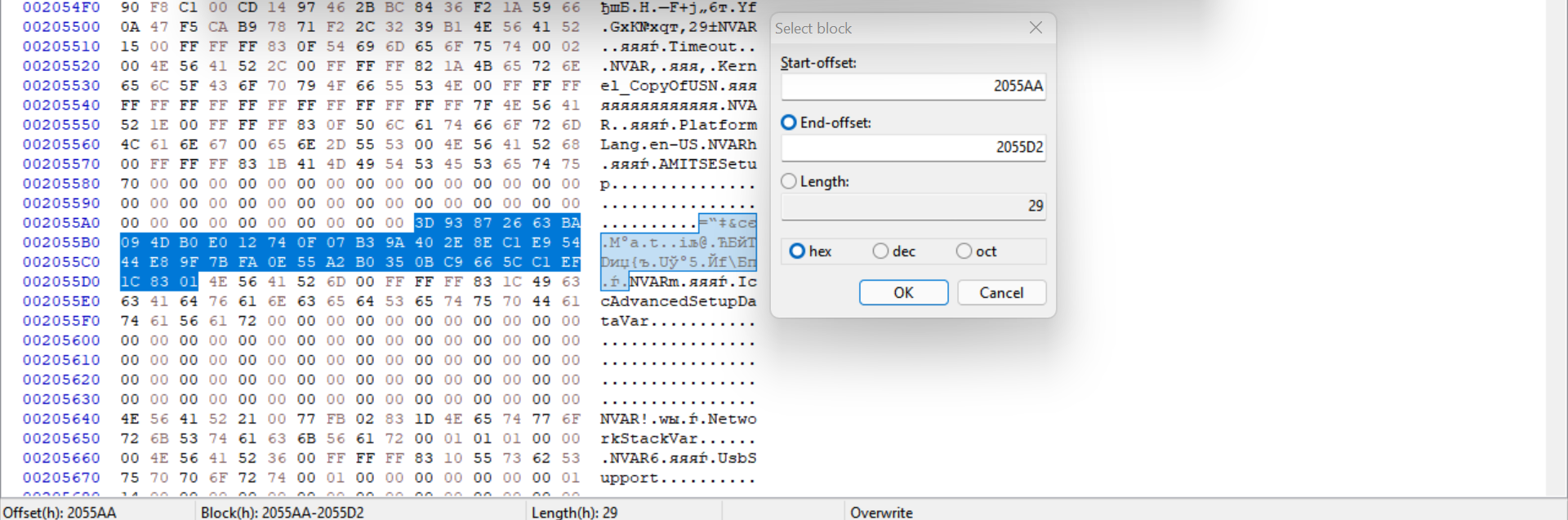

      Open your dump with Hxd or other Hexadecimal program
      Locate area with
      texte AMITSESetup or Hex 41 4d 49 54 53 45 53 65 74 75 70.
      Take the hex values in the red area (two passwords can be stored).
      Put the hex values in excel decoder.
      I try this way, but can't find texte ''AMITSESetup''
      Maybe because i have Surface Book, but this manual for Surface Pro 3?
      I make dump file with Universal bios backup toolkit 2.0

                          I have a problem with the BIOS password at my surface pro 3. I thought to remember the correct password, but it doesn't work. After a lot of reading and learning I created the dump and also found a password. By the way, it's the same I remember but this doesn't work. It seems that there is something between the 5 letters. Can someone help?
                          @Skoda352
                          Hash:
                          3693DF267FBA074DA6E022747D07D89A
                          332E8EC1E95444E89F7BFA0E55A2B035
                          0BC9665CC1EF1C83
                          Password: minka
                          m - mike ( lowercase )
                          i - india ( lowercase )
                          n - november ( lowercase )
                          k - kilo ( lowercase )
                          a - alpha ( lowercase )
                          In Laptop, type the password and press <Enter>.
