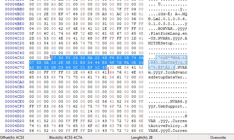

    You can do it yourself. Search through your backup with a hex editor for AMITSE, the password removal method is well know. There are at least 3 decoders and a few guides on the forum.

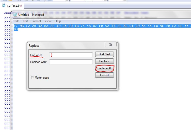

          If you want to copy the hex into notepad you can remove the spaces by selecting all text,select Edit - Replace, type a space into the top white box then click on replace all
