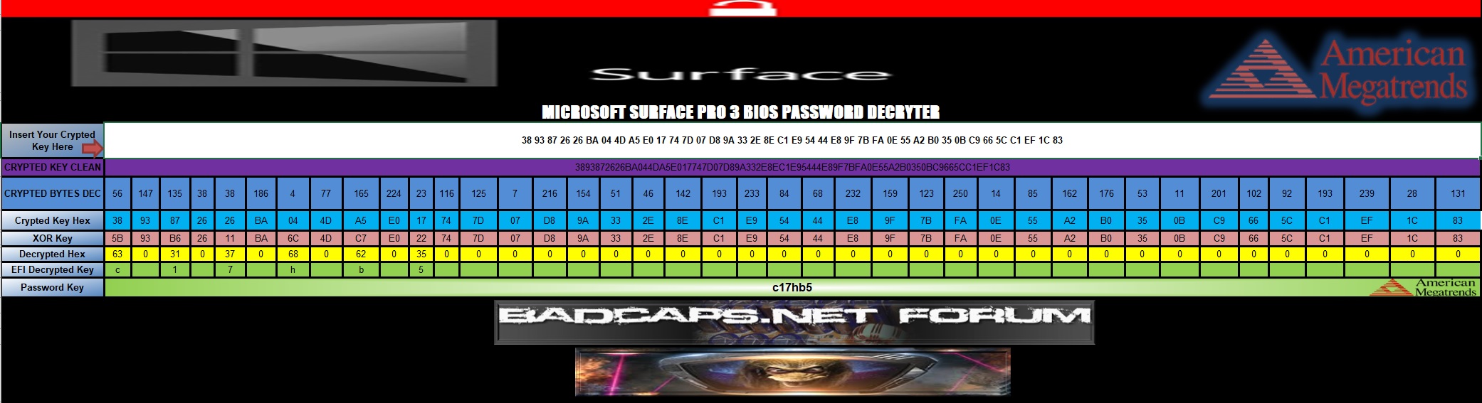

                                    #157
                                    Re: Microsoft Surface Pro 3 UEFI password
                                    Originally posted by v01t
                                    Reading this forum has been a huge help towards progress in unlocking my SP3 UEFI, however I am having issues getting the password. I attempted to locate a hex string after 'AMITESESetup' but the values I entered seemed off. Could anyone help decrypt?
                                    @v01t
                                    Encrypted string:
                                    3893872626BA044DA5E017747D07D89A
                                    332E8EC1E95444E89F7BFA0E55A2B035
                                    0BC9665CC1EF1C83
                                    Password: c17hb5
                                    c - charlie ( lowercase )
                                    1 - one ( number )
                                    7 - seven ( number )
                                    h - hotel ( lowercase )
                                    b - bravo ( lowercase )
                                    5 - five ( number )
                                    In Laptop: Type the password and press <Enter>.

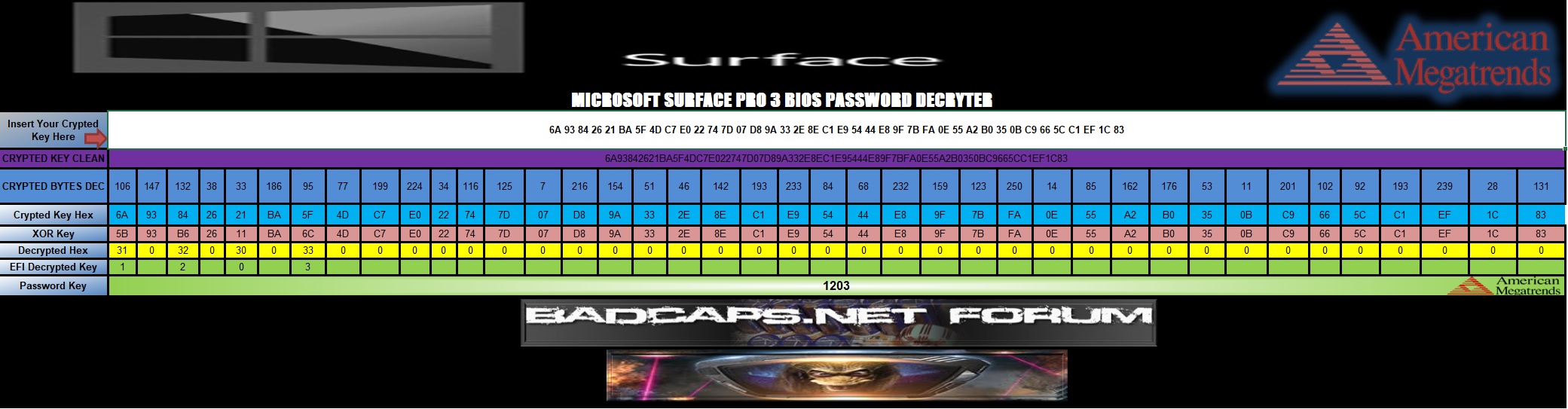

                                      Open your dump with Hxd or other Hexadecimal program
                                      Locate area with
                                      texte AMITSESetup or Hex 41 4d 49 54 53 45 53 65 74 75 70.
                                      Take the hex values in the red area (two passwords can be stored).
                                      Put the hex values in excel decoder.
                                      Great job, hats off!
