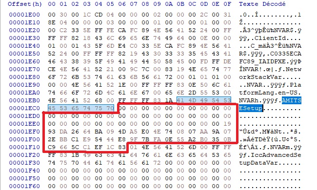

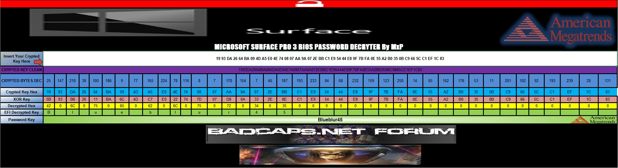

                                        Open your dump with Hxd or other Hexadecimal program
                                        Locate area with
                                        texte AMITSESetup or Hex 41 4d 49 54 53 45 53 65 74 75 70.
                                        Take the hex values in the red area (two passwords can be stored).
                                        Put the hex values in excel decoder.
