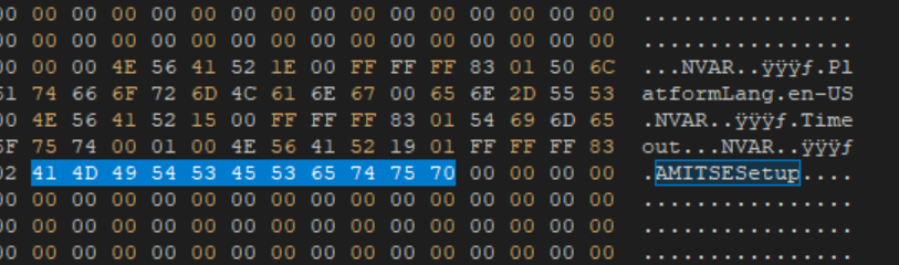

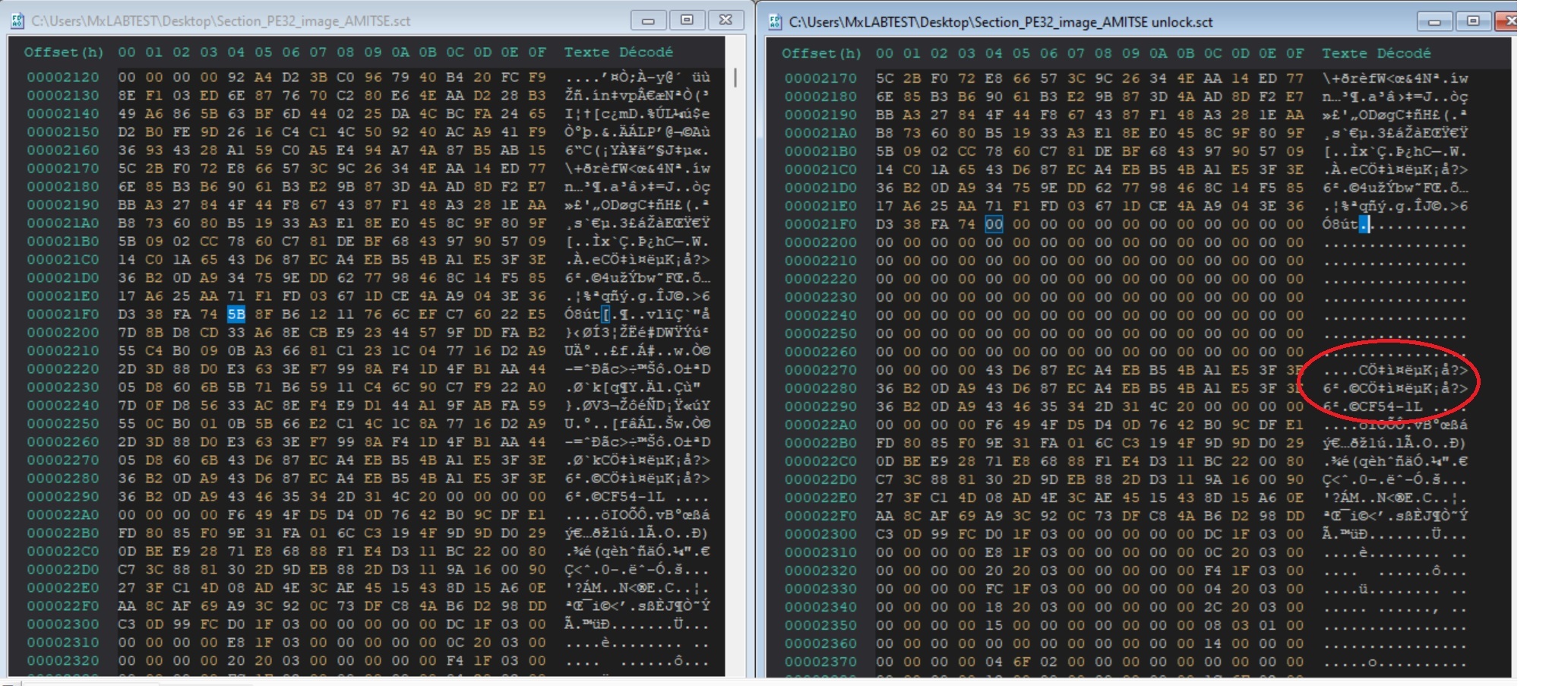

Panasonic CF-54 Bios Password
  • peste
    • Dec 2016
    • 13793
    • ROMANIA
    #501
    Originally posted by obsolete
    Ive got a cf-54 as well with a bios lock. Serial: 9CTTC23853, Model: CF-54J5886VM
    attached is the bios dump
    if anyone could help it would be appreciated.
    I found this but cannot be arsed to decipher it
    5B A1 B6 38 11 D1 6C C7 C7 05 22 E5 7D F3 D8 EA 33 22 8E B6 E9 58 44 41 9F 8B FA 8E 55 01 B0 90 0B 5C 66 66 C1 FC 1C 91 77 0C D2 CB 2D 50 88 9D E3 BE 3E 5C 99 3B F4 D1 4F 71 AA 8A 05 F8 60 10
    The bios should have 16MB, you only posted half, remove the chip from the motherboard before writing or reading.
    • obsolete
      • Jun 2024
      • 9
      #502
      I bricked the machine already, and I do not have a bios image. Panasonic site bios images are quite small and I cannot seem to extract them, does anyone have an original image?
      • obsolete
        • Jun 2024
        • 9
        #503
        I have a ch341a programmer and have simple clip on the chip, yet i cannot even get a clean erase, i get sections that do not wipe, i fill it with 00 or FF and most of it will delete but some is left over with garbage. Tried reconnecting but no good. Am I missing some secure silly section or something? Bios chip is MXIC 25L12873F. Using 1.34 software. Get the annoying Chip Main Memory with the contents are in disagreement
          • 22158
          #504
          Originally posted by obsolete
          I have a ch341a programmer and have simple clip on the chip, yet i cannot even get a clean erase, i get sections that do not wipe, i fill it with 00 or FF and most of it will delete but some is left over with garbage. Tried reconnecting but no good. Am I missing some secure silly section or something? Bios chip is MXIC 25L12873F. Using 1.34 software. Get the annoying Chip Main Memory with the contents are in disagreement
          Use NeoProgrammer software, you`ll find it posted in the forum if you search.
          • obsolete
            • Jun 2024
            • 9
            #505
            Originally posted by SMDFlea
            Use NeoProgrammer software, you`ll find it posted in the forum if you search.
            I discovered it and it worked well, however I now have realized I I want my original firmware back and only have the truncated 8mb image. I realize now I need a clean ME region apparently to fix the horrible slow post I get while using other peoples bios. Is there anything I can do with that 8mb file? I see other peoples bios give me different model serial etc, and a long boot time. Is it possible to combine my truncated image with the weird 4mb or so bios updates from panasonic?
            • obsolete
              • Jun 2024
              • 9
              #506
              Originally posted by obsolete
              I discovered it and it worked well, however I now have realized I I want my original firmware back and only have the truncated 8mb image. I realize now I need a clean ME region apparently to fix the horrible slow post I get while using other peoples bios. Is there anything I can do with that 8mb file? I see other peoples bios give me different model serial etc, and a long boot time. Is it possible to combine my truncated image with the weird 4mb or so bios updates from panasonic?
              Alright I finally got a clean ME region working, it posts fast (thanks to your guide SMDFlea), now I just have ocd about the bios showing another model number and serial. Any easy way to adjust this?
                • 22158
                #507
                Originally posted by obsolete
                Alright I finally got a clean ME region working, it posts fast (thanks to your guide SMDFlea), now I just have ocd about the bios showing another model number and serial. Any easy way to adjust this?
                post the working bios
                • obsolete
                  • Jun 2024
                  • 9
                  #508
                  Originally posted by SMDFlea
                  post the working bios
                  Serial: 9CTTC23853, Model: CF-54J5886VM
                  Clear the silly asset tag or maybe make it POOP
                  for fun operating hours maybe set to 4000 was my goal
                  If you can figure it out do let me know how you did it, i assume it is somewhere in the image and probably duplicated, hopefully not in the ME region, ill include the un-initiliazed me region version image that I made.
                  I noticed reading pre and post init that serial is pulled into the ME region, so this bin will be pre-init/configured for your convenience.
                  • obsolete
                    • Jun 2024
                    • 9
                    #509
                    Originally posted by obsolete
                    Serial: 9CTTC23853, Model: CF-54J5886VM
                    Clear the silly asset tag or maybe make it POOP
                    for fun operating hours maybe set to 4000 was my goal
                    If you can figure it out do let me know how you did it, i assume it is somewhere in the image and probably duplicated, hopefully not in the ME region, ill include the un-initiliazed me region version image that I made.
                    I noticed reading pre and post init that serial is pulled into the ME region, so this bin will be pre-init/configured for your convenience.
                    i found model number in hxd just for some reason serial i can only find the first part of it (searching the original serial from the bios i used to make this) I only find 8KTTA (rest of serial is 81421)
                    • obsolete
                      • Jun 2024
                      • 9
                      #510
                      Alright I got serial and model number corrected. For reference, serial is bizzarely written in hex, it is 3 digits summating to the last 5 digits of your serial (so when you find the first 5 letters/numbers, those 3 hex values next to it are the last 5 digits of your serial, they do not come out to ascii in readable numbers, not sure if it is some silly XOR, reversed, IDK, but it I got it.
                        • 22158
                        #511
                        Originally posted by obsolete
                        Alright I got serial and model number corrected. For reference, serial is bizzarely written in hex, it is 3 digits summating to the last 5 digits of your serial (so when you find the first 5 letters/numbers, those 3 hex values next to it are the last 5 digits of your serial, they do not come out to ascii in readable numbers, not sure if it is some silly XOR, reversed, IDK, but it I got it.
                        The serial etc is at the top of the 8MB file you posted,as you found out. The serial on most models is in full,this one is unusual, havn`t seen it done this way before.The win key is a little bit further down so make sure you copied that as well.
                        • obsolete
                          • Jun 2024
                          • 9
                          #512
                          Originally posted by SMDFlea
                          The serial etc is at the top of the 8MB file you posted,as you found out. The serial on most models is in full,this one is unusual, havn`t seen it done this way before.The win key is a little bit further down so make sure you copied that as well.
                          Yeah my ocd made me find that too, learned that 01 00 00 00 00 00 00 00 01 00 00 00 00 00 00 00 1d 00 00 are the values prior to the license key and only appear once in the bios.
                          • lapfix
                            • Mar 2020
                            • 2765
                            • my workshop
                            #513
                            Hello friends , i can 't boot i got access level : user
                            in rar files there are
                            main dump
                            my unlocked file that didn t work
                            picture of main page of bios
                            thx for your help
                              SMDFlea commented
                              Editing a comment
                              Serial number please
                          • Maxpower3
                            Bad Veteran
                            • Feb 2018
                            • 1356
                            • France
                            #514
                            Originally posted by lapfix
                            my unlocked file that didn t work
                            lack of cleaning
                            Serial 7FTCA37819 write on picture of bios and correct in Bios dump
                            try
                            SMDFlea weird this repetition here
Name:	Cf20 compressed.jpg
Views:	419
Size:	648.4 KB
ID:	3323555
                            • lapfix
                              • Mar 2020
                              • 2765
                              • my workshop
                              #515
                              lack of cleaning
                              Serial 7FTCA37819 write on picture of bios and correct in Bios dump
                              try
                              SMDFlea weird this repetition here
Name:	Cf20 compressed.jpg
Views:	419
Size:	648.4 KB
ID:	3323555
                              PERFECT...thank you
                              • tazman87
                                • Aug 2024
                                • 3
                                • Romania
                                #516
                                Hello! Can anyone help me to decrypt or remove bios password on my CF54?
                              • OIPPE
                                • Aug 2024
                                • 6
                                #517
                                Hi, Can someone help with getting the bios password for my Panasonic Toughbook CF-54?
                                I read the forum and found something on github but i couldnt find AMITSESetup with Data subtype.
                                I will attach 2 bios dumps from 2 diffrent programs.
                                Serial No. 7FTCA35762
                                Model No. CF-54D3961T2
                                Last edited by OIPPE; 08-27-2024, 05:09 PM.
                                • hoaca388
                                  Badcaps
                                  • Jan 2022
                                  • 12423
                                  #518
                                  Originally posted by OIPPE
                                  Hi, Can someone help with getting the bios password for my Panasonic Toughbook CF-54?
                                  I read the forum and found something on github but i couldnt find AMITSESetup with Data subtype.
                                  I will attach 2 bios dumps from 2 diffrent programs.
                                  Serial No. 7FTCA35762
                                  Model No. CF-54D3961T2
                                  F3 to continue.
                                  • Maxpower3
                                    Bad Veteran
                                    • Feb 2018
                                    • 1356
                                    • France
                                    #519
                                    Originally posted by hoaca388
                                    F3 to continue.
                                    or try find in hex 41 4D 49 54 53 45 53 65 74 75 70
Name:	image.png
Views:	283
Size:	96.1 KB
ID:	3338426
                                      • 22158
                                      #520
                                      or try find in hex 41 4D 49 54 53 45 53 65 74 75 70
Name:	image.png
Views:	283
Size:	96.1 KB
ID:	3338426
                                      Or just patch it
                                      • outsider
                                        Panasonic FZ-G1 MK5 - BIOS password returning
                                        by outsider
                                        Hello
                                        I removed the BIOS password thanks to the help of one of the friends of this forum.
                                        https://www.badcaps.net/forum/troubl...61#post3637661
                                        The batch from which the password was removed works correctly but... after some time, the BIOS password is set again, I reprogrammed the batch with the removed password, it's ok, there is no password, I set my password, ok, I can enter the BIOS with my password but...
                                        06-17-2025, 12:51 AM
                                      • zenius
                                        by zenius
                                        12-08-2024, 06:13 AM
                                      • traxformania
                                        TONGFANG "GM7TG7P" Bios Password Problem?
                                        by traxformania
                                        I'm using TONGFANG "GM7TG7P" model laptop for over 3 years and i'm entering the same bios administrator password everyday. My laptop has Aptio BIOS (American Megatrends, AMI).
                                        But today it's not accepting my password. I'm %100 sure i'm entering the correct password.
                                        I'm trying to reset my bios without success.
                                        I tried :
                                        -I removed the BIOS battery and main battery. Waited for a long time but it didn't work. They already stated in the user manual that the password will not be reset even if the batteries...
                                        11-15-2023, 07:32 AM
                                      • longmt1990
                                        Panasonic Cf-w5 bios password remove
                                        by longmt1990
                                        Hi, i have a Panasonic Cf-W5 with the bios password, I tried remove cmos but problem didnot solve.
                                        I uploaded the picture after remove cmos battery, It look like this is a Phoenix bios. The bios dump file in the link i attached
                                        Please help me remove bios password.
                                        Thank you so much
                                        07-06-2025, 10:50 PM
                                      • Nopslide
                                        HP Omen 15-dh0052nf power-on & bios password
                                        by Nopslide
                                        Hello everyone, I come here to tell you my problem regarding the power-on password. It is not a bios reset demand, and i can't have any access to windows. This is the bios and power-on password that is blocking all other things.
                                        My Omen 15-dh0052nf purchased second-hand was configured with the bios password upon purchase (very simple password :P ).
                                        Having decided to sell it in order to get something more powerful, I reset all BIOS settings and set a blank administrator password. But the power-on password cannot be changed to a blank one so I let the actual password set....
                                        04-01-2024, 04:27 PM
