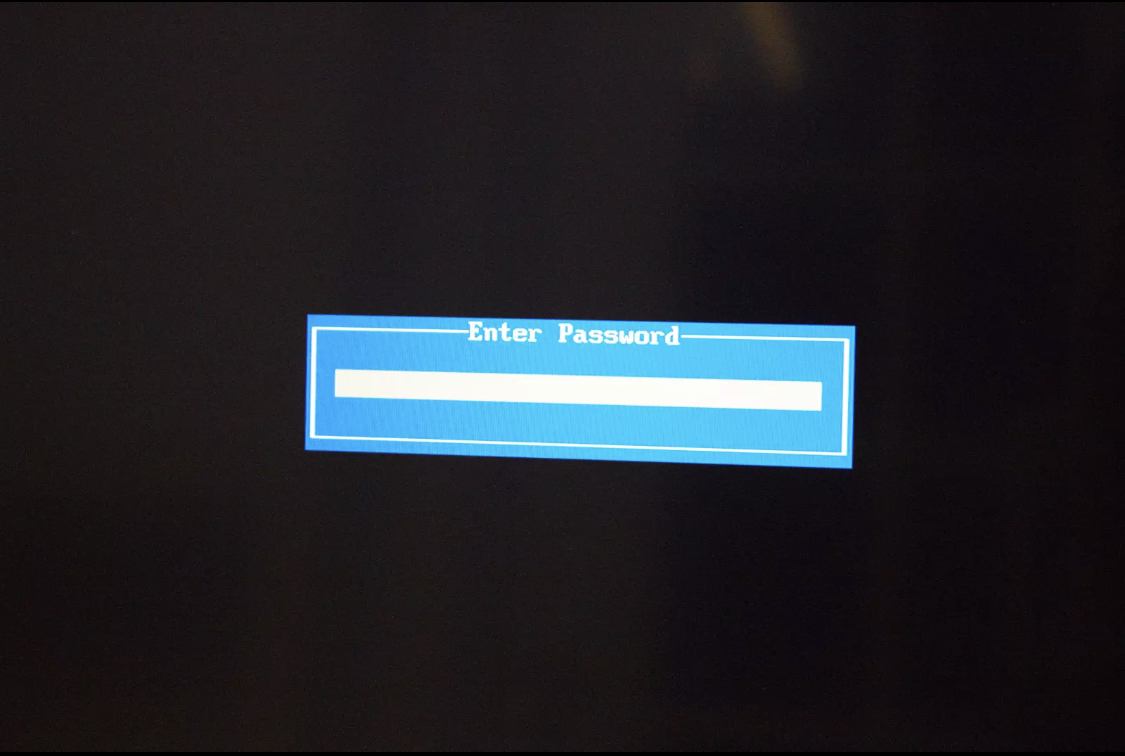

Panasonic CF-54 Bios Password
  • OIPPE
    • Aug 2024
    • 6
    #521
    Originally posted by SMDFlea
    Or just patch it
    Thank you guys!
    • tazman87
      • Aug 2024
      • 3
      • Romania
      #522
      Originally posted by tazman87
      Hello! Can anyone help me to decrypt or remove bios password on my CF54?
      Sorry I forgot to post this info:
      Serial No. 6BTCA45942
      Model No. CF-54CU005E2
      Thanks!
      • hoaca388
        Badcaps
        • Jan 2022
        • 12423
        #523
        Originally posted by tazman87
        Sorry I forgot to post this info:
        Serial No. 6BTCA45942
        Model No. CF-54CU005E2
        Thanks!
        Unlocked
        • tazman87
          • Aug 2024
          • 3
          • Romania
          #524
          Originally posted by hoaca388
          Unlocked
          Thanks! It works. Now i have another problem: my HDD is password protected in old BIOS is there a possibility to remove that password ... so can i reuse the hdd and all data stored in it?
          • Gavin Artino
            • Sep 2024
            • 4
            #525
            I have a cf-54 with locked bios can you please give password.
            CF-54C5494CM
            • peste
              • Dec 2016
              • 13809
              • ROMANIA
              #526
              Originally posted by Gavin Artino
              I have a cf-54 with locked bios can you please give password.
              CF-54C5494CM
              oh and the bios!!!???where is the bios??post the contents of the bios chip...postS/N...
              • Gavin Artino
                • Sep 2024
                • 4
                #527
                Originally posted by peste
                oh and the bios!!!???where is the bios??post the contents of the bios chip...postS/N...
                Sorry
                CF-54C5494CM
                6ATSA41662
                • Gavin Artino
                  • Sep 2024
                  • 4
                  #528
                  Here is the bios rom sorry for the wait, Thanks in advance
                  • bbanana
                    Father Land
                    • Oct 2021
                    • 164
                    • Vietnam
                    #529
                    Originally posted by Gavin Artino
                    Here is the bios rom sorry for the wait, Thanks in advance
                    here youre
                    • Gavin Artino
                      • Sep 2024
                      • 4
                      #530
                      Originally posted by bbanana
                      here youre
                      ok so do i have to flash this or something. not sure what to do with this now
                      • hoaca388
                        Badcaps
                        • Jan 2022
                        • 12423
                        #531
                        Originally posted by Gavin Artino
                        ok so do i have to flash this or something. not sure what to do with this now
                        Where did you get that .bin file originally? The programmer has two modes: Read _ backup bios. Write _ write bios back to the device.
                        • Pei-er Moo
                          • Sep 2024
                          • Taiwan
                          #532
                          Hi, I need help to the password with CF-54.
                          Thanks a lot.
                          CF-54F5-00VM
                          7HTSA56540​
                          • hoaca388
                            Badcaps
                            • Jan 2022
                            • 12423
                            #533
                            Originally posted by Pei-er Moo
                            Hi, I need help to the password with CF-54.
                            Thanks a lot.
                            CF-54F5-00VM
                            7HTSA56540​
                            Unlocked.
                            • Marcin49wp
                              • Jul 2024
                              • 28
                              • POLAND
                              #534
                              Hello
                              Hi, I need help to the password with CF-54.
                              Thanks a lot.
                              CF-54a0001MN
                              5GTCA09959
                              • shiyab
                                • Sep 2023
                                • 1674
                                • india
                                #535
                                Originally posted by Marcin49wp
                                Hello
                                Hi, I need help to the password with CF-54.
                                Thanks a lot.
                                CF-54a0001MN
                                5GTCA09959
                                hi try
                                • Marcin49wp
                                  • Jul 2024
                                  • 28
                                  • POLAND
                                  #536
                                  Thanks !!!! Its Ok !!
                                  • Little86
                                    Oleh
                                    • Nov 2024
                                    • 3
                                    • Ukraine
                                    #537
                                    Hello! Is it possible to reset the bios password for CF-54BX089CM? Thank you very much for your help
                                    • shiyab
                                      • Sep 2023
                                      • 1674
                                      • india
                                      #538
                                      Originally posted by Little86
                                      Hello! Is it possible to reset the bios password for CF-54BX089CM? Thank you very much for your help
                                      post backup bios
                                        • 22176
                                        #539
                                        Originally posted by Little86
                                        Hello! Is it possible to reset the bios password for CF-54BX089CM? Thank you very much for your help
                                        RULES UPDATE for BIOS requests/offers AVOID BANNING, READ BEFORE POSTING
                                        https://www.badcaps.net/forum/troubl...before-posting
                                        You MUST:
                                        • Provide the full machine model number, serial number (or Service tag, SNID) and the board model number (see https://www.badcaps.net/forum/showthread.php?t=88758 ) ,The serial number, make, full model number, motherboard model and revision (except QR codes) must be written/typed at your request as per the rules. Not as a picture, part of the file name and so on.
                                        • antsumy
                                          • Nov 2019
                                          • 34
                                          • Ukraine
                                          #540
                                          Hello
                                          I need help to the password with CF-54.
                                          Thanks!
                                          CF-54J5886VM
                                          s/n: 9CTTC23873
                                          Dump is attached.
                                          • outsider
                                            Panasonic FZ-G1 MK5 - BIOS password returning
                                            by outsider
                                            Hello
                                            I removed the BIOS password thanks to the help of one of the friends of this forum.
                                            https://www.badcaps.net/forum/troubl...61#post3637661
                                            The batch from which the password was removed works correctly but... after some time, the BIOS password is set again, I reprogrammed the batch with the removed password, it's ok, there is no password, I set my password, ok, I can enter the BIOS with my password but...
                                            06-17-2025, 12:51 AM
                                          • zenius
                                            by zenius
                                            12-08-2024, 06:13 AM
                                          • traxformania
                                            TONGFANG "GM7TG7P" Bios Password Problem?
                                            by traxformania
                                            I'm using TONGFANG "GM7TG7P" model laptop for over 3 years and i'm entering the same bios administrator password everyday. My laptop has Aptio BIOS (American Megatrends, AMI).
                                            But today it's not accepting my password. I'm %100 sure i'm entering the correct password.
                                            I'm trying to reset my bios without success.
                                            I tried :
                                            -I removed the BIOS battery and main battery. Waited for a long time but it didn't work. They already stated in the user manual that the password will not be reset even if the batteries...
                                            11-15-2023, 07:32 AM
                                          • longmt1990
                                            Panasonic Cf-w5 bios password remove
                                            by longmt1990
                                            Hi, i have a Panasonic Cf-W5 with the bios password, I tried remove cmos but problem didnot solve.
                                            I uploaded the picture after remove cmos battery, It look like this is a Phoenix bios. The bios dump file in the link i attached
                                            Please help me remove bios password.
                                            Thank you so much
                                            07-06-2025, 10:50 PM
                                          • Nopslide
                                            HP Omen 15-dh0052nf power-on & bios password
                                            by Nopslide
                                            Hello everyone, I come here to tell you my problem regarding the power-on password. It is not a bios reset demand, and i can't have any access to windows. This is the bios and power-on password that is blocking all other things.
                                            My Omen 15-dh0052nf purchased second-hand was configured with the bios password upon purchase (very simple password :P ).
                                            Having decided to sell it in order to get something more powerful, I reset all BIOS settings and set a blank administrator password. But the power-on password cannot be changed to a blank one so I let the actual password set....
                                            04-01-2024, 04:27 PM
