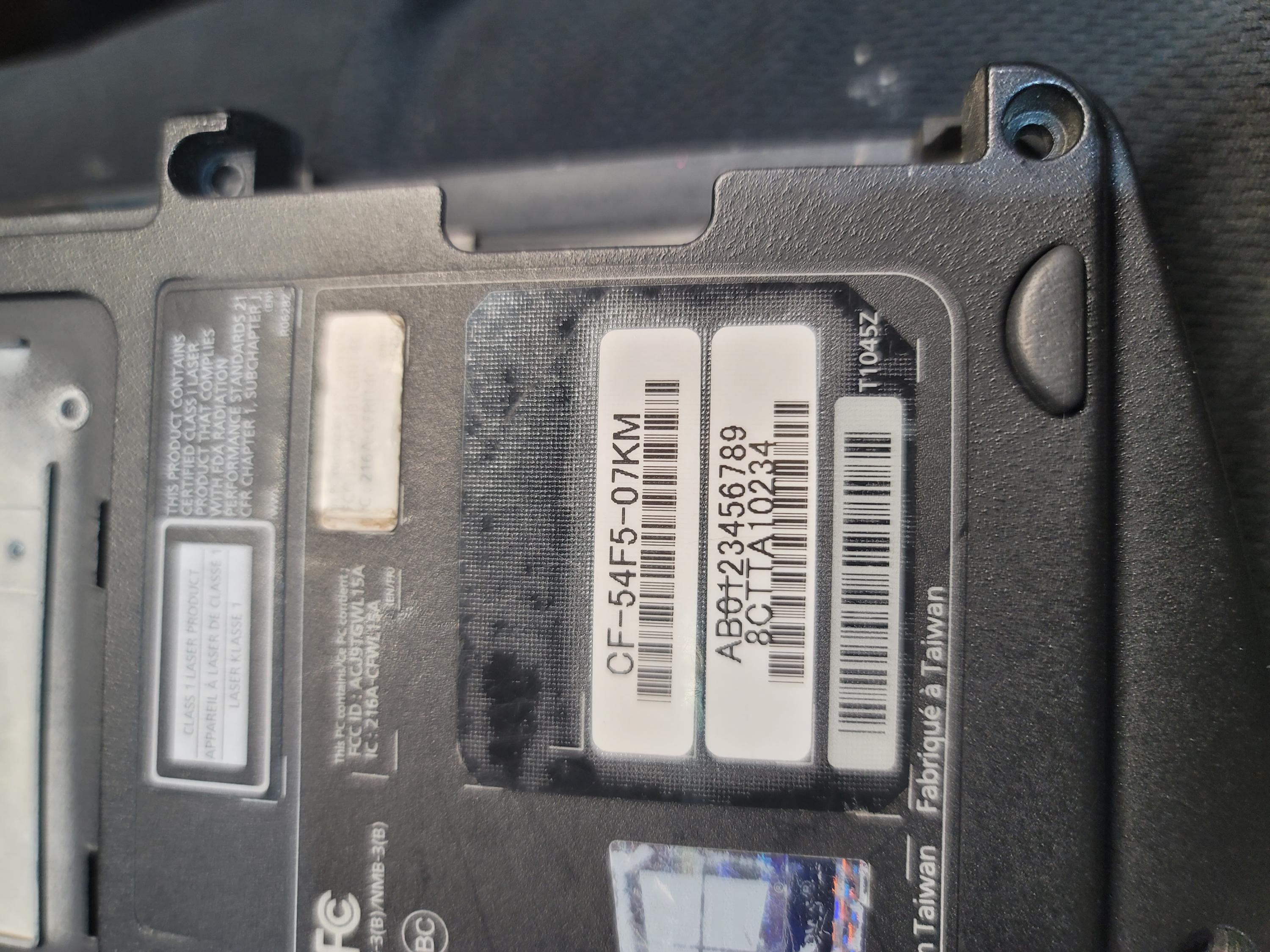

Panasonic CF-54 Bios Password
  • imran421
    • Apr 2020
    • 83
    #381
    Re: Panasonic CF-54 Bios Password
    Please remove the bios password,
    • hoaca388
      Badcaps
      • Jan 2022
      • 12423
      #382
      Re: Panasonic CF-54 Bios Password
      Originally posted by imran421
      Please remove the bios password,
      Unlocked
      ​https://www.badcaps.net/donate
      • imran421
        • Apr 2020
        • 83
        #383
        Re: Panasonic CF-54 Bios Password
        worked and denoted
        • RicoPL
          • Sep 2023
          • 13
          • poland
          #384
          Re: Panasonic CF-54 Bios Password
          Can you please remove the password from this bios.
          ps. I managed to remove the password myself and it was very easy. No need for help .
          Last edited by RicoPL; 09-23-2023, 01:52 PM.
          • volinakis
            • Jan 2021
            • 2875
            • N/A
            #385
            Re: Panasonic CF-54 Bios Password
            Originally posted by RicoPL
            Can you please remove the password from this bios.
            ps. I managed to remove the password myself and it was very easy. No need for help .
            yep, after you found ALL you needed on this forum
            • imran421
              • Apr 2020
              • 83
              #386
              Re: Panasonic CF-54 Bios Password
              please remove the bios password
              • peste
                • Dec 2016
                • 13793
                • ROMANIA
                #387
                Re: Panasonic CF-54 Bios Password
                Originally posted by imran421
                please remove the bios password
                I think you got confused in the bios and posted the same bios as in post #382, and the picture from post #381..
                • RicoPL
                  • Sep 2023
                  • 13
                  • poland
                  #388
                  Re: Panasonic CF-54 Bios Password
                  yep, after you found ALL you needed on this forum
                  That is correct. Dowloaded 2 files and compared together to see what was removed.
                  • imran421
                    • Apr 2020
                    • 83
                    #389
                    Re: Panasonic CF-54 Bios Password
                    Originally posted by RicoPL
                    That is correct. Dowloaded 2 files and compared together to see what was removed.
                    They look two different serial numbers
                    serial number: 8FTTA41486
                    serial number: 8CCTTA10234
                    File is correctr for bios. Can I use the last file that has no bios password.
                    • peste
                      • Dec 2016
                      • 13793
                      • ROMANIA
                      #390
                      Re: Panasonic CF-54 Bios Password
                      Originally posted by imran421
                      They look two different serial numbers
                      serial number: 8FTTA41486
                      serial number: 8CCTTA10234
                      File is correctr for bios. Can I use the last file that has no bios password.
                      post the original bios of the second one..
                      • imran421
                        • Apr 2020
                        • 83
                        #391
                        Re: Panasonic CF-54 Bios Password
                        bin file attached
                        • peste
                          • Dec 2016
                          • 13793
                          • ROMANIA
                          #392
                          Re: Panasonic CF-54 Bios Password
                          Originally posted by imran421
                          bin file attached
                          try..
                          • laptopdude3
                            • Sep 2023
                            • 5
                            #393
                            Re: Panasonic CF-54 Bios Password
                            CF-54 toughbook
                            used CH341 with neoprogrammer to attach to the MX25L12873F chip on motherboard,
                            bin file is 16MB and has the AMITSE area i was looking for
                            Is this correct?
                            How to get unlock? ty!
                            • hoaca388
                              Badcaps
                              • Jan 2022
                              • 12423
                              #394
                              Re: Panasonic CF-54 Bios Password
                              Originally posted by laptopdude3
                              CF-54 toughbook
                              used CH341 with neoprogrammer to attach to the MX25L12873F chip on motherboard,
                              bin file is 16MB and has the AMITSE area i was looking for
                              Is this correct?
                              How to get unlock? ty!
                              Unlocked
                              ​https://www.badcaps.net/donate
                              • laptopdude3
                                • Sep 2023
                                • 5
                                #395
                                Re: Panasonic CF-54 Bios Password
                                Originally posted by hoaca388
                                Unlocked
                                thank you so much!! You are the best!
                                • laptopdude3
                                  • Sep 2023
                                  • 5
                                  #396
                                  Re: Panasonic CF-54 Bios Password
                                  Hello beautiful friends, can help with this bios?
                                    • 22158
                                    #397
                                    Re: Panasonic CF-54 Bios Password
                                    Originally posted by laptopdude3
                                    Hello beautiful friends, can help with this bios?
                                    You MUST:
                                    • laptopdude3
                                      • Sep 2023
                                      • 5
                                      #398
                                      Re: Panasonic CF-54 Bios Password
                                      Sorry, I forgot to include
                                      full machine model number: CF-54C
                                      serial number: 5JTCA29001
                                      the board model number: is this the Bios chip? (MXIC MX 25L12873F)
                                      Attached is read from bios
                                      • volinakis
                                        • Jan 2021
                                        • 2875
                                        • N/A
                                        #399
                                        Re: Panasonic CF-54 Bios Password
                                        Originally posted by laptopdude3
                                        Sorry, I forgot to include
                                        full machine model number: CF-54C
                                        serial number: 5JTCA29001
                                        the board model number: is this the Bios chip? (MXIC MX 25L12873F)
                                        Attached is read from bios
                                        try
                                        • laptopdude3
                                          • Sep 2023
                                          • 5
                                          #400
                                          Re: Panasonic CF-54 Bios Password
                                          try
                                          It worked! Thank you! one less e-waste for the world
                                          • outsider
                                            Panasonic FZ-G1 MK5 - BIOS password returning
                                            by outsider
                                            Hello
                                            I removed the BIOS password thanks to the help of one of the friends of this forum.
                                            https://www.badcaps.net/forum/troubl...61#post3637661
                                            The batch from which the password was removed works correctly but... after some time, the BIOS password is set again, I reprogrammed the batch with the removed password, it's ok, there is no password, I set my password, ok, I can enter the BIOS with my password but...
                                            06-17-2025, 12:51 AM
                                          • zenius
                                            by zenius
                                            12-08-2024, 06:13 AM
                                          • traxformania
                                            TONGFANG "GM7TG7P" Bios Password Problem?
                                            by traxformania
                                            I'm using TONGFANG "GM7TG7P" model laptop for over 3 years and i'm entering the same bios administrator password everyday. My laptop has Aptio BIOS (American Megatrends, AMI).
                                            But today it's not accepting my password. I'm %100 sure i'm entering the correct password.
                                            I'm trying to reset my bios without success.
                                            I tried :
                                            -I removed the BIOS battery and main battery. Waited for a long time but it didn't work. They already stated in the user manual that the password will not be reset even if the batteries...
                                            11-15-2023, 07:32 AM
                                          • longmt1990
                                            Panasonic Cf-w5 bios password remove
                                            by longmt1990
                                            Hi, i have a Panasonic Cf-W5 with the bios password, I tried remove cmos but problem didnot solve.
                                            I uploaded the picture after remove cmos battery, It look like this is a Phoenix bios. The bios dump file in the link i attached
                                            Please help me remove bios password.
                                            Thank you so much
                                            07-06-2025, 10:50 PM
                                          • Nopslide
                                            HP Omen 15-dh0052nf power-on & bios password
                                            by Nopslide
                                            Hello everyone, I come here to tell you my problem regarding the power-on password. It is not a bios reset demand, and i can't have any access to windows. This is the bios and power-on password that is blocking all other things.
                                            My Omen 15-dh0052nf purchased second-hand was configured with the bios password upon purchase (very simple password :P ).
                                            Having decided to sell it in order to get something more powerful, I reset all BIOS settings and set a blank administrator password. But the power-on password cannot be changed to a blank one so I let the actual password set....
                                            04-01-2024, 04:27 PM
