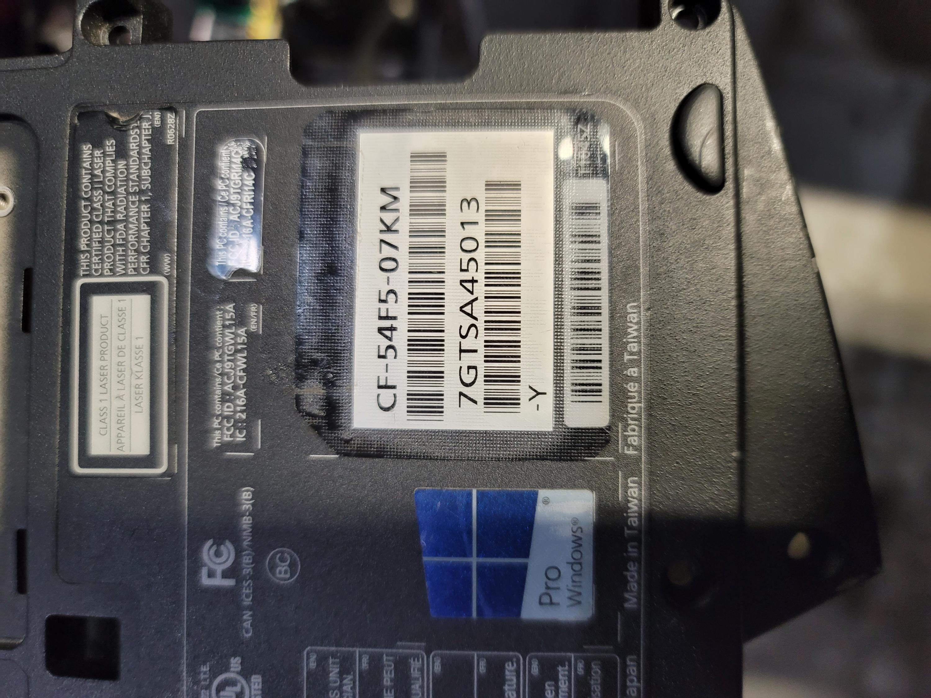

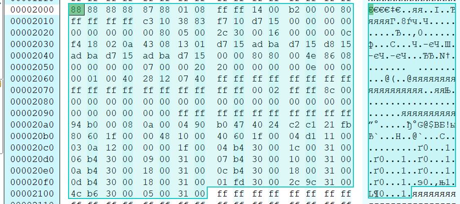

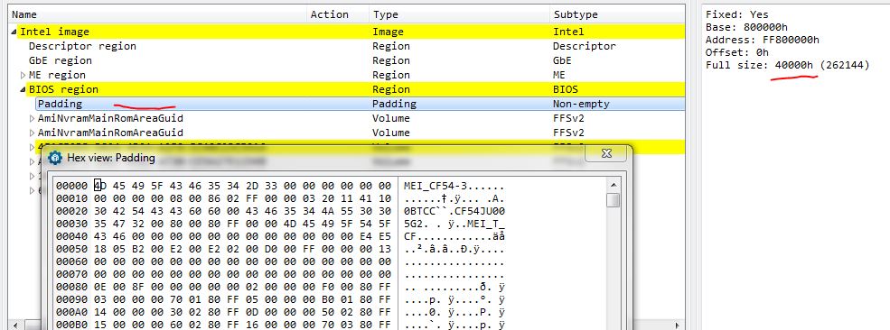

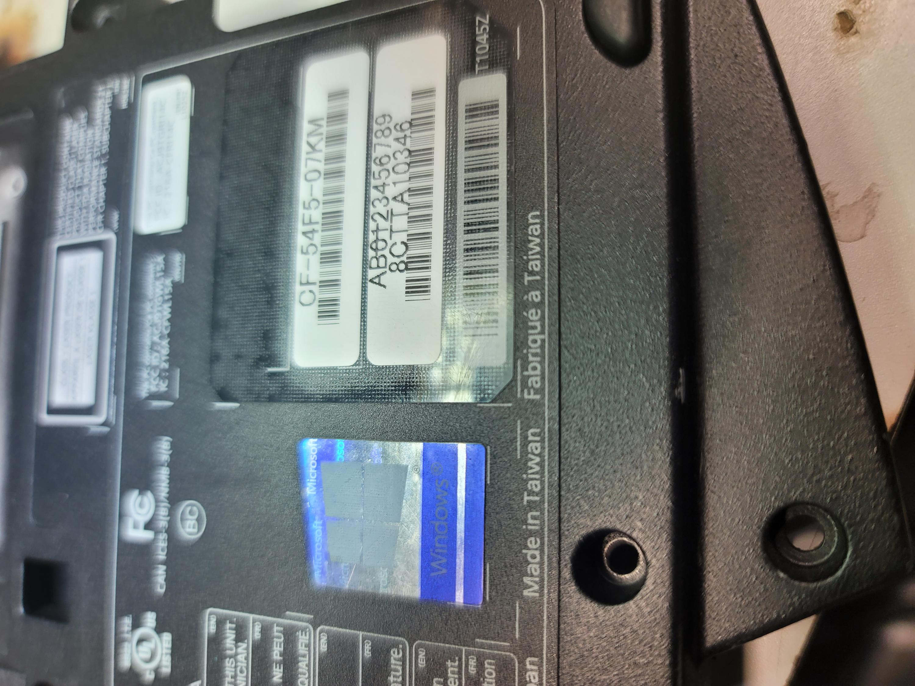

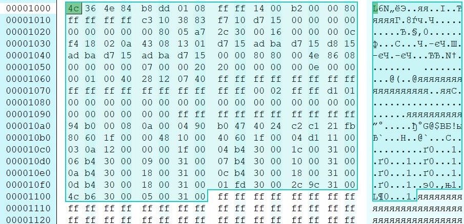

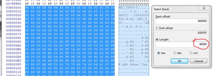

Panasonic CF-54 Bios Password
  • imran421
    • Apr 2020
    • 73
    #401
    Re: Panasonic CF-54 Bios Password
    Please remove the bios password
    • hoaca388
      Badcaps
      • Jan 2022
      • 11640
      #402
      Re: Panasonic CF-54 Bios Password
      Originally posted by imran421
      Please remove the bios password
      Unlocked
      • AWENA
        • Sep 2020
        • 28
        • Polska
        #403
        Re: Panasonic CF-54 Bios Password
        Hello
        I need help with password reset on panasonic cf-54C. I tried to remove the password myself. But I couldn't do it (I can go into the BIOS and change the settings there, but after rebooting the laptop asks for the old password again). I've attached the bios dumps in the archive.
        Please help me what am I doing wrong?
        MODEL: CF-54CU005H2
        SERIAL: 7CTCA22737
        • hoaca388
          Badcaps
          • Jan 2022
          • 11640
          #404
          Re: Panasonic CF-54 Bios Password
          Originally posted by AWENA
          Hello
          I need help with password reset on panasonic cf-54C. I tried to remove the password myself. But I couldn't do it (I can go into the BIOS and change the settings there, but after rebooting the laptop asks for the old password again). I've attached the bios dumps in the archive.
          Please help me what am I doing wrong?
          MODEL: CF-54CU005H2
          SERIAL: 7CTCA22737
          Go to settings and set your password.
          • AWENA
            • Sep 2020
            • 28
            • Polska
            #405
            Re: Panasonic CF-54 Bios Password
            Thank you for your reply
            I tried to set my password. But when I do "Factory Default", the password I set doesn't work anymore. It seems that the laptop somehow remembers the old password and sets it again.
            I also tried changing different security settings, but nothing helped.
              • 20674
              #406
              Re: Panasonic CF-54 Bios Password
              Originally posted by AWENA
              Thank you for your reply
              I tried to set my password. But when I do "Factory Default", the password I set doesn't work anymore. It seems that the laptop somehow remembers the old password and sets it again.
              I also tried changing different security settings, but nothing helped.
              Try this one.
              • AWENA
                • Sep 2020
                • 28
                • Polska
                #407
                Re: Panasonic CF-54 Bios Password
                Thank you very much. It works. If it's not a secret, how did you do it? Did you use a dump from another laptop as a basis?
                • imran421
                  • Apr 2020
                  • 73
                  #408
                  Re: Panasonic CF-54 Bios Password
                  Please remove the bios password.
                    • 20674
                    #409
                    Re: Panasonic CF-54 Bios Password
                    Originally posted by imran421
                    Please remove the bios password.
                    You didn`t leave any feedback for the previous one that was unlocked at post #402
                    • imran421
                      • Apr 2020
                      • 73
                      #410
                      Re: Panasonic CF-54 Bios Password
                      I got no display with original bin and modified bin. So issue with motherboard.
                      • freeflight
                        • Feb 2019
                        • 10
                        • UA
                        #411
                        Re: Panasonic CF-54 Bios Password
                        Hello, I have a Panasonic CF-54J with a password. Deleting the code (in a hex editor) after the line "AMITSESetup" did not help. Can anyone help me?
                        Model: CF-54JU005G2
                        Serial Number: OBTCC24672
                        • freeflight
                          • Feb 2019
                          • 10
                          • UA
                          #412
                          Re: Panasonic CF-54 Bios Password
                          I managed to make a bios dump without a password. I used the dumps from this thread and cleared the ME region. All that remains is to transfer the DMI information. If I understand correctly, it starts at address 0x00800000.
                            • 20674
                            #413
                            Re: Panasonic CF-54 Bios Password
                            Originally posted by freeflight
                            I managed to make a bios dump without a password. I used the dumps from this thread and cleared the ME region. All that remains is to transfer the DMI information. If I understand correctly, it starts at address 0x00800000.
                            Yes it starts at 800000h .Its in the first padding area.
                            Offsets 800000 - 83FFFF
                            • freeflight
                              • Feb 2019
                              • 10
                              • UA
                              #414
                              Re: Panasonic CF-54 Bios Password
                              Thank you very much
                              • imran421
                                • Apr 2020
                                • 73
                                #415
                                Re: Panasonic CF-54 Bios Password
                                Originally posted by imran421
                                Please remove the bios password.
                                Any help please?
                                • hoaca388
                                  Badcaps
                                  • Jan 2022
                                  • 11640
                                  #416
                                  Re: Panasonic CF-54 Bios Password
                                  Originally posted by imran421
                                  Any help please?
                                  You must resolve the issue of hardware damage that arises.
                                  • imran421
                                    • Apr 2020
                                    • 73
                                    #417
                                    Re: Panasonic CF-54 Bios Password
                                    This is a different laptop.
                                    • freeflight
                                      • Feb 2019
                                      • 10
                                      • UA
                                      #418
                                      Re: Panasonic CF-54 Bios Password
                                      I am very grateful for help. But have one more small problem. How can I transfer the mac address from an old bios dump? Transferring the mac address (from 0x00001000) in the hex editor didn't help.
                                      • hoaca388
                                        Badcaps
                                        • Jan 2022
                                        • 11640
                                        #419
                                        Re: Panasonic CF-54 Bios Password
                                        Originally posted by freeflight
                                        I am very grateful for help. But have one more small problem. How can I transfer the mac address from an old bios dump? Transferring the mac address (from 0x00001000) in the hex editor didn't help.
                                        Tìm HxD editor. Copy and Paste ( Ctrl + B )
                                        • freeflight
                                          • Feb 2019
                                          • 10
                                          • UA
                                          #420
                                          Re: Panasonic CF-54 Bios Password
                                          I got it. Looking through other bios dumps in this thread, I saw that the mac address is often found here 0x1000 and here 0x2000.
                                          I copied these lines of code from the backup bios and it didn't change anything. Then I realized that the problem was probably with the Windows system. It had somehow memorized the Mac's address and didn't change it. After reinstalling Windows, the problem was solved, and the Mac address changed to the one in the original bios.
                                          • outsider
                                            Panasonic FZ-G1 MK5 - BIOS password returning
                                            by outsider
                                            Hello
                                            I removed the BIOS password thanks to the help of one of the friends of this forum.
                                            https://www.badcaps.net/forum/troubl...61#post3637661
                                            The batch from which the password was removed works correctly but... after some time, the BIOS password is set again, I reprogrammed the batch with the removed password, it's ok, there is no password, I set my password, ok, I can enter the BIOS with my password but...
                                            06-17-2025, 12:51 AM
                                          • zenius
                                            by zenius
                                            12-08-2024, 06:13 AM
                                          • traxformania
                                            TONGFANG "GM7TG7P" Bios Password Problem?
                                            by traxformania
                                            I'm using TONGFANG "GM7TG7P" model laptop for over 3 years and i'm entering the same bios administrator password everyday. My laptop has Aptio BIOS (American Megatrends, AMI).
                                            But today it's not accepting my password. I'm %100 sure i'm entering the correct password.
                                            I'm trying to reset my bios without success.
                                            I tried :
                                            -I removed the BIOS battery and main battery. Waited for a long time but it didn't work. They already stated in the user manual that the password will not be reset even if the batteries...
                                            11-15-2023, 07:32 AM
                                          • longmt1990
                                            Panasonic Cf-w5 bios password remove
                                            by longmt1990
                                            Hi, i have a Panasonic Cf-W5 with the bios password, I tried remove cmos but problem didnot solve.
                                            I uploaded the picture after remove cmos battery, It look like this is a Phoenix bios. The bios dump file in the link i attached
                                            Please help me remove bios password.
                                            Thank you so much
                                            07-06-2025, 10:50 PM
                                          • Nopslide
                                            HP Omen 15-dh0052nf power-on & bios password
                                            by Nopslide
                                            Hello everyone, I come here to tell you my problem regarding the power-on password. It is not a bios reset demand, and i can't have any access to windows. This is the bios and power-on password that is blocking all other things.
                                            My Omen 15-dh0052nf purchased second-hand was configured with the bios password upon purchase (very simple password :P ).
                                            Having decided to sell it in order to get something more powerful, I reset all BIOS settings and set a blank administrator password. But the power-on password cannot be changed to a blank one so I let the actual password set....
                                            04-01-2024, 04:27 PM
