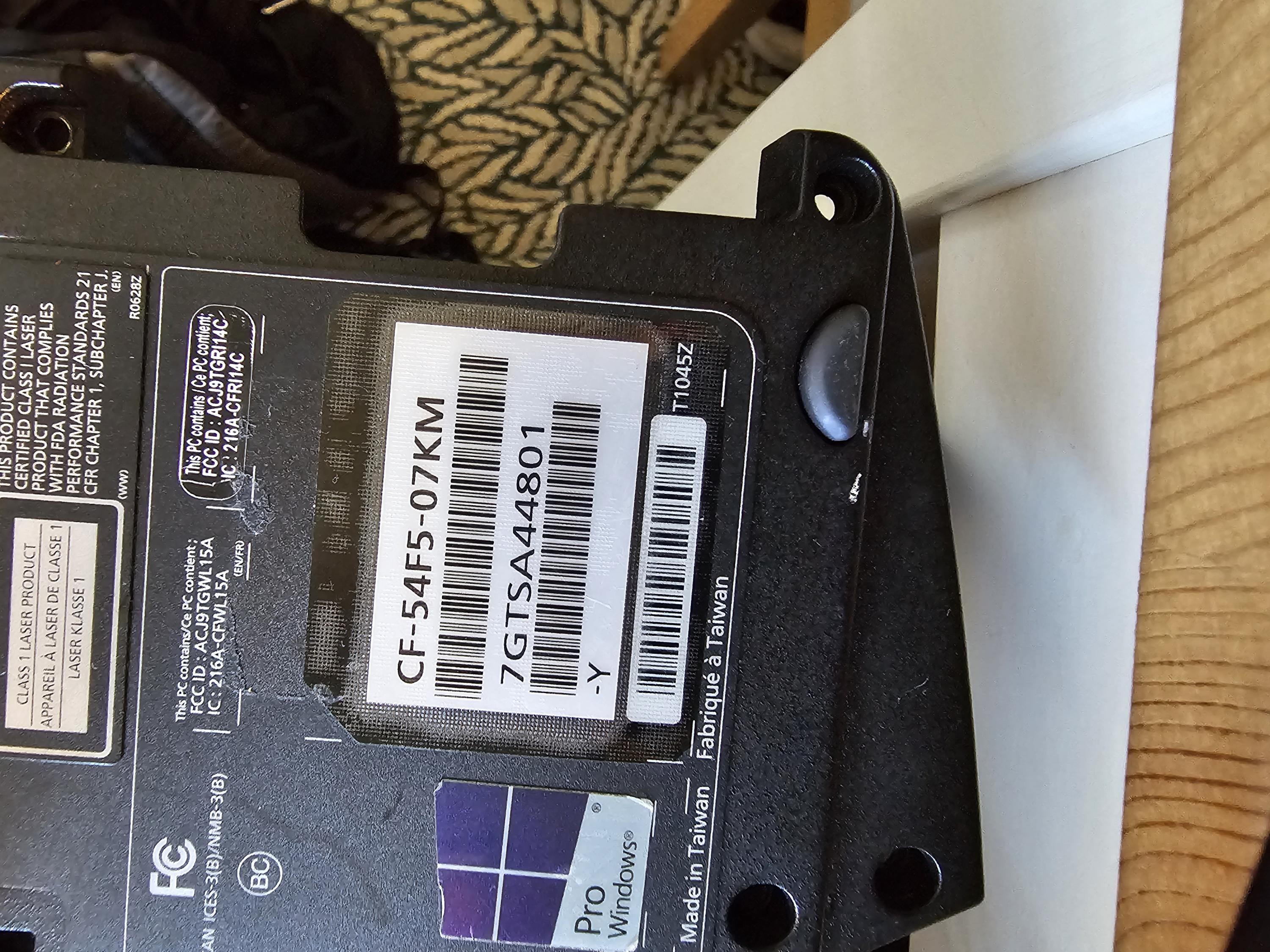

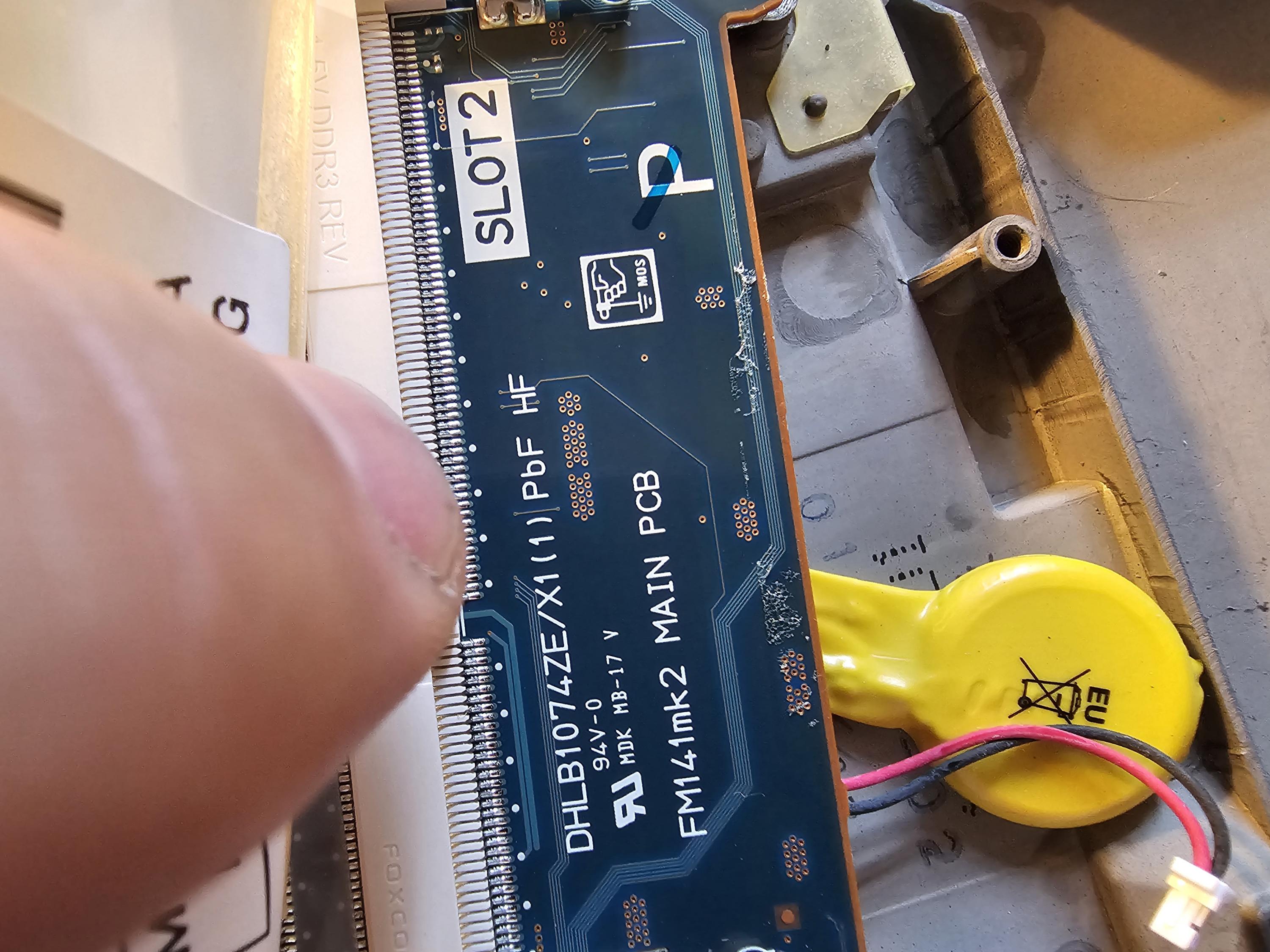

Panasonic CF-54 Bios Password
  • volinakis
    • Jan 2021
    • 2733
    • N/A
    #361
    Re: Panasonic CF-54 Bios Password
    you're probably right, just a silent start indicator.
    The main thing is that it is successful
    well, he reported that after writing vesko's file "no power" , with or without flag laptop should start. Most probably he didn't solder well chipset or failed to read chipset properly.
    • imran421
      • Apr 2020
      • 75
      #362
      Re: Panasonic CF-54 Bios Password
      Please remove the bios password
      • hoaca388
        Badcaps
        • Jan 2022
        • 11733
        #363
        Re: Panasonic CF-54 Bios Password
        Originally posted by imran421
        Please remove the bios password
        Unlocked
        • imran421
          • Apr 2020
          • 75
          #364
          Re: Panasonic CF-54 Bios Password
          Originally posted by hoaca388
          Unlocked
          No go. powers on with black screen
          • volinakis
            • Jan 2021
            • 2733
            • N/A
            #365
            Re: Panasonic CF-54 Bios Password
            Originally posted by imran421
            Please remove the bios password
            try. Thanks go to MaxPower3.
            • Vesko356
              VIP Moderator
              • Aug 2018
              • 4386
              • Bulgaria 🇧🇬
              #366
              Re: Panasonic CF-54 Bios Password
              Originally posted by imran421
              No go. powers on with black screen
              Try again, erase the chip before programming and use verification, after programing read the chip again and compare the content, because I have a feeling you have some issues with your programmer. Ch341a + clip probably?
              Become a Badcaps supporter
              Thanks to all supporters.
              • volinakis
                • Jan 2021
                • 2733
                • N/A
                #367
                Re: Panasonic CF-54 Bios Password
                Originally posted by Vesko356
                Try again, erase the chip before programming and use verification, after programing read the chip again and compare the content, because I have a feeling you have some issues with your programmer. Ch341a + clip probably?
                I think is that "01" flag MaxPower3 was talking about ...
                • Vesko356
                  VIP Moderator
                  • Aug 2018
                  • 4386
                  • Bulgaria 🇧🇬
                  #368
                  Re: Panasonic CF-54 Bios Password
                  I think is that "01" flag MaxPower3 was talking about ...
                  No, it's not (as I said already). Read some old post back the thread and you'll find out. There are many examples of the unlocked dumps with completely zeroed hash blocks reported perfectly working, so I don't think we need to discuss this further - it's just a waste of time.
                  Become a Badcaps supporter
                  Thanks to all supporters.
                  • imran421
                    • Apr 2020
                    • 75
                    #369
                    Re: Panasonic CF-54 Bios Password
                    Originally posted by Vesko356
                    Try again, erase the chip before programming and use verification, after programing read the chip again and compare the content, because I have a feeling you have some issues with your programmer. Ch341a + clip probably?
                    you are absolutely righ. I changed the programmer and it worked. donated as well.
                    Thanks for all your help
                    • Vesko356
                      VIP Moderator
                      • Aug 2018
                      • 4386
                      • Bulgaria 🇧🇬
                      #370
                      Re: Panasonic CF-54 Bios Password
                      Originally posted by imran421
                      you are absolutely righ. I changed the programmer and it worked. donated as well.
                      Thanks for all your help
                      You're welcome.
                      Thanks for your support, really appreciated it.
                      Become a Badcaps supporter
                      Thanks to all supporters.
                      • onlyzilvis
                        • Sep 2023
                        • 3
                        • Lietuva
                        #371
                        Re: Panasonic CF-54 Bios Password
                        Hello everybody!
                        Can someone help to clear Bios Password for CF-54F
                          • 20888
                          #372
                          Re: Panasonic CF-54 Bios Password
                          Originally posted by onlyzilvis
                          Hello everybody!
                          Can someone help to clear Bios Password for CF-54F
                          Provide the full machine model number, serial number (or Service tag, SNID) and the board model number (see https://www.badcaps.net/forum/showthread.php?t=88758 )
                          • onlyzilvis
                            • Sep 2023
                            • 3
                            • Lietuva
                            #373
                            Re: Panasonic CF-54 Bios Password
                            Originally posted by onlyzilvis
                            Hello everybody!
                            Can someone help to clear Bios Password for CF-54F
                            Sorry, added photo with board and S.N.
                            • hoaca388
                              Badcaps
                              • Jan 2022
                              • 11733
                              #374
                              Re: Panasonic CF-54 Bios Password
                              Originally posted by onlyzilvis
                              sorry, added photo with board and s.n.
                              fffffff
                              • onlyzilvis
                                • Sep 2023
                                • 3
                                • Lietuva
                                #375
                                Re: Panasonic CF-54 Bios Password
                                Originally posted by hoaca388
                                fffffff
                                Working, thanks
                                • imran421
                                  • Apr 2020
                                  • 75
                                  #376
                                  Re: Panasonic CF-54 Bios Password
                                  please remove the bios password
                                  • Vesko356
                                    VIP Moderator
                                    • Aug 2018
                                    • 4386
                                    • Bulgaria 🇧🇬
                                    #377
                                    Re: Panasonic CF-54 Bios Password
                                    Originally posted by imran421
                                    please remove the bios password
                                    Read post #372
                                    Become a Badcaps supporter
                                    Thanks to all supporters.
                                    • imran421
                                      • Apr 2020
                                      • 75
                                      #378
                                      Re: Panasonic CF-54 Bios Password
                                      Originally posted by Vesko356
                                      Read post #372
                                      Serial number attached.
                                      • Vesko356
                                        VIP Moderator
                                        • Aug 2018
                                        • 4386
                                        • Bulgaria 🇧🇬
                                        #379
                                        Re: Panasonic CF-54 Bios Password
                                        Originally posted by imran421
                                        Serial number attached.
                                        Unlocked:
                                        Become a Badcaps supporter
                                        Thanks to all supporters.
                                        • imran421
                                          • Apr 2020
                                          • 75
                                          #380
                                          Re: Panasonic CF-54 Bios Password
                                          worked and donated as well. I am having battery draning issue. It drains with in 10 min from 100% to zro. Any one has any sugestions. I tried quite a few battries.
                                          • outsider
                                            Panasonic FZ-G1 MK5 - BIOS password returning
                                            by outsider
                                            Hello
                                            I removed the BIOS password thanks to the help of one of the friends of this forum.
                                            https://www.badcaps.net/forum/troubl...61#post3637661
                                            The batch from which the password was removed works correctly but... after some time, the BIOS password is set again, I reprogrammed the batch with the removed password, it's ok, there is no password, I set my password, ok, I can enter the BIOS with my password but...
                                            06-17-2025, 12:51 AM
                                          • zenius
                                            by zenius
                                            12-08-2024, 06:13 AM
                                          • traxformania
                                            TONGFANG "GM7TG7P" Bios Password Problem?
                                            by traxformania
                                            I'm using TONGFANG "GM7TG7P" model laptop for over 3 years and i'm entering the same bios administrator password everyday. My laptop has Aptio BIOS (American Megatrends, AMI).
                                            But today it's not accepting my password. I'm %100 sure i'm entering the correct password.
                                            I'm trying to reset my bios without success.
                                            I tried :
                                            -I removed the BIOS battery and main battery. Waited for a long time but it didn't work. They already stated in the user manual that the password will not be reset even if the batteries...
                                            11-15-2023, 07:32 AM
                                          • longmt1990
                                            Panasonic Cf-w5 bios password remove
                                            by longmt1990
                                            Hi, i have a Panasonic Cf-W5 with the bios password, I tried remove cmos but problem didnot solve.
                                            I uploaded the picture after remove cmos battery, It look like this is a Phoenix bios. The bios dump file in the link i attached
                                            Please help me remove bios password.
                                            Thank you so much
                                            07-06-2025, 10:50 PM
                                          • Nopslide
                                            HP Omen 15-dh0052nf power-on & bios password
                                            by Nopslide
                                            Hello everyone, I come here to tell you my problem regarding the power-on password. It is not a bios reset demand, and i can't have any access to windows. This is the bios and power-on password that is blocking all other things.
                                            My Omen 15-dh0052nf purchased second-hand was configured with the bios password upon purchase (very simple password :P ).
                                            Having decided to sell it in order to get something more powerful, I reset all BIOS settings and set a blank administrator password. But the power-on password cannot be changed to a blank one so I let the actual password set....
                                            04-01-2024, 04:27 PM
