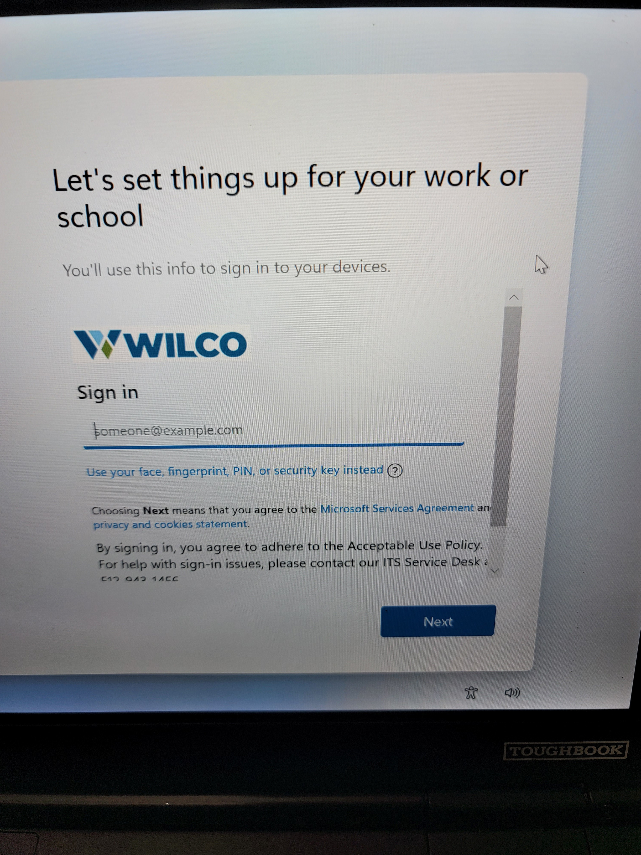

Panasonic CF-54 Bios Password
  • scan world
    • Mar 2025
    • usa
    #581
    Hello can you reset my password please Thank you
    Model cf-54j2
    Last edited by scan world; 03-29-2025, 03:16 PM.
  • swimllamaswim
    • May 2016
    • 11
    #582
    Hello all, recently acquired a CF-54 MK2 with a locked bios. I dumped it and attempted to edit it, zeroing out the region under AMITSESetup that corresponded to a few of the dumps I compared here, but after flashing and booting back up, it says bad cmos (probably since the battery was removed) and then asks for a password again.
    Model: CF-54F5518KM
    S/N: 8BTTA03278
    I've attached both the initial dump, made with NeoProgrammer, and my attempted edit. I'd love to learn what exactly I did wrong if anyone has pointers! Thank you!
    Initial Dump:
    https://files.catbox.moe/0mvixr.bin
    Mod Attempt:
    https://files.catbox.moe/xndusr.bin
    • peste
      • Dec 2016
      • 12698
      • ROMANIA
      #583
      Originally posted by swimllamaswim
      Hello all, recently acquired a CF-54 MK2 with a locked bios. I dumped it and attempted to edit it, zeroing out the region under AMITSESetup that corresponded to a few of the dumps I compared here, but after flashing and booting back up, it says bad cmos (probably since the battery was removed) and then asks for a password again.
      Model: CF-54F5518KM
      S/N: 8BTTA03278
      I've attached both the initial dump, made with NeoProgrammer, and my attempted edit. I'd love to learn what exactly I did wrong if anyone has pointers! Thank you!
      Initial Dump:
      https://files.catbox.moe/0mvixr.bin
      Mod Attempt:
      https://files.catbox.moe/xndusr.bin
      try..
      • swimllamaswim
        • May 2016
        • 11
        #584
        Originally posted by peste
        try..
        Thank you, that worked! I think mine may have as well, turns out I was having issues flashing the chip, had to erase the chip before writing and move it to a USB 2.0 port from the 3.0 it was plugged in to, but it's password free now nonetheless! Cheers!
        • Pat1980123
          • Apr 2025
          • 2
          • Deutschland
          #585
          Hello, can you help me pls?
          Can you remove the PW from this file?
          Panasonic CF-54
          CF-54G2284TG
          SN: 8DTCA20620
          MK3
          Thanks!
          Last edited by Pat1980123; 04-04-2025, 03:46 AM. Reason: Serial
          • hoaca388
            Badcaps
            • Jan 2022
            • 11673
            #586
            Originally posted by Pat1980123
            Hello, can you help me pls?
            Can you remove the PW from this file?
            Panasonic CF-54
            CF-54G2284TG
            SN: 8DTCA20620
            MK3
            Thanks!
            Unlocked
            • Pat1980123
              • Apr 2025
              • 2
              • Deutschland
              #587
              Originally posted by hoaca388
              Unlocked
              Work! Thanks!
              • Chesh
                • Apr 2025
                #588
                Hi, I have a CF-54 toughbook that has a locked bios. Whats the process to getting the password to unlock?
                cheers
                • hoaca388
                  Badcaps
                  • Jan 2022
                  • 11673
                  #589
                  Originally posted by Chesh
                  Hi, I have a CF-54 toughbook that has a locked bios. Whats the process to getting the password to unlock?
                  cheers
                  Post model + Serial number + Your bios dump.
                  • dan_189
                    • Apr 2021
                    • 4
                    #590
                    Hoping you can please help - BIOS locked CF-54
                    Model: CF-54C3001CM
                    Serial number: 6BTSA44498
                    BIOS dump attached
                    Thanks!​
                    • hoaca388
                      Badcaps
                      • Jan 2022
                      • 11673
                      #591
                      Originally posted by dan_189
                      Hoping you can please help - BIOS locked CF-54
                      Model: CF-54C3001CM
                      Serial number: 6BTSA44498
                      BIOS dump attached
                      Thanks!​
                      Unlocked.
                      • dan_189
                        • Apr 2021
                        • 4
                        #592
                        Originally posted by hoaca388
                        Unlocked.
                        Brilliant - thank you!!
                        • dan_189
                          • Apr 2021
                          • 4
                          #593
                          Just to report back - worked!! Thank you so much
                          • pb9300
                            • May 2025
                            • België
                            #594
                            i bought a touchbook cf-54 with a locked bios. How to unlock this ? QH
                            • peste
                              • Dec 2016
                              • 12698
                              • ROMANIA
                              #595
                              Originally posted by pb9300
                              i bought a touchbook cf-54 with a locked bios. How to unlock this ? QH
                              post S/N, full name and model, motherboard model, etc.
                              post the contents of the bios chip even if it is corrupted..
                              The bios chip must be unsoldered from the board before writing or reading..
                              do not use the clip, you may have errors..if you do not have anything to unsolder it with,
                              solder wires between the programmer and the bios chip..
                              you need an SPI programmer...here is a video for example..https://www.youtube.com/watch?v=DWWi...l=ThisIsHow​
                              • imran421
                                • Apr 2020
                                • 74
                                #596
                                please remove the bios password. I was not able to remove it
                                Cf-54F5-07KM
                                sno: 8CTTA10213
                                • Maxpower3
                                  Bad Veteran
                                  • Feb 2018
                                  • 1224
                                  • France
                                  #597
                                  Originally posted by imran421
                                  please remove the bios password. I was not able to remove it
                                  Cf-54F5-07KM
                                  sno: 8CTTA10213
                                  try
                                  • imran421
                                    • Apr 2020
                                    • 74
                                    #598
                                    There is no password on the bios. But has a school lock. Any please help to remove the college info.
                                    cf-54J2-06VM
                                    SNO:9CTTC22027
                                    • hoaca388
                                      Badcaps
                                      • Jan 2022
                                      • 11673
                                      #599
                                      Originally posted by imran421
                                      There is no password on the bios. But has a school lock. Any please help to remove the college info.
                                      cf-54J2-06VM
                                      SNO:9CTTC22027
                                      Here
                                      • Aliencomputres
                                        • Aug 2019
                                        • 203
                                        • România
                                        #600
                                        Originally posted by medinfo
                                        Re: Panasonic CF-54 Bios Password
                                        Problem fixed
                                        How?
                                        • outsider
                                          Panasonic FZ-G1 MK5 - BIOS password returning
                                          by outsider
                                          Hello
                                          I removed the BIOS password thanks to the help of one of the friends of this forum.
                                          https://www.badcaps.net/forum/troubl...61#post3637661
                                          The batch from which the password was removed works correctly but... after some time, the BIOS password is set again, I reprogrammed the batch with the removed password, it's ok, there is no password, I set my password, ok, I can enter the BIOS with my password but...
                                          06-17-2025, 12:51 AM
                                        • zenius
                                          by zenius
                                          12-08-2024, 06:13 AM
                                        • traxformania
                                          TONGFANG "GM7TG7P" Bios Password Problem?
                                          by traxformania
                                          I'm using TONGFANG "GM7TG7P" model laptop for over 3 years and i'm entering the same bios administrator password everyday. My laptop has Aptio BIOS (American Megatrends, AMI).
                                          But today it's not accepting my password. I'm %100 sure i'm entering the correct password.
                                          I'm trying to reset my bios without success.
                                          I tried :
                                          -I removed the BIOS battery and main battery. Waited for a long time but it didn't work. They already stated in the user manual that the password will not be reset even if the batteries...
                                          11-15-2023, 07:32 AM
                                        • longmt1990
                                          Panasonic Cf-w5 bios password remove
                                          by longmt1990
                                          Hi, i have a Panasonic Cf-W5 with the bios password, I tried remove cmos but problem didnot solve.
                                          I uploaded the picture after remove cmos battery, It look like this is a Phoenix bios. The bios dump file in the link i attached
                                          Please help me remove bios password.
                                          Thank you so much
                                          07-06-2025, 10:50 PM
                                        • Nopslide
                                          HP Omen 15-dh0052nf power-on & bios password
                                          by Nopslide
                                          Hello everyone, I come here to tell you my problem regarding the power-on password. It is not a bios reset demand, and i can't have any access to windows. This is the bios and power-on password that is blocking all other things.
                                          My Omen 15-dh0052nf purchased second-hand was configured with the bios password upon purchase (very simple password :P ).
                                          Having decided to sell it in order to get something more powerful, I reset all BIOS settings and set a blank administrator password. But the power-on password cannot be changed to a blank one so I let the actual password set....
                                          04-01-2024, 04:27 PM
