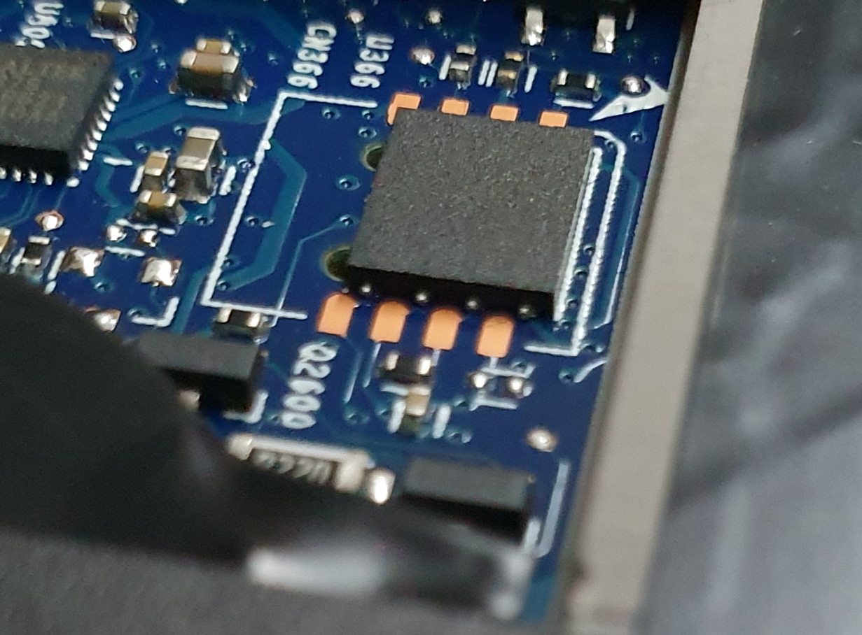

                          Re: Hp elitebook 745 g3 (AMD) bios password
                          hello chip contains the password ?? u365 or u366??

                            BIOS Password Reset HP Elitebook 745 G3
                            HI All,
                            Recently bought a laptop (as above) can log in as administrator but can't open up BIOS as password protected. The seller doesn't know the password and HP support seem to think the answer is a new board (its not).
                            Pretty frustrating that HP believe they don't need to support customers and have added features that they wont support when they go wrong...Anyhow.
                            If anyone could advise what I need to do? I've read I need a BIOS dump? but not sure how to do that? I have downloaded one from Lab one - not sure if this is reputable or not.
                            Have some time on hands at the moment, so would love to get access to BIOS. Can someone help? Or point me towards a thread that can show me the process?
                            THe reason I need access is I want to upgrade and check the mouse mat is not turned off in BIOS (it doesn't work despite all software and hardware supposedly checking out OK in Windows)

                                  Re: BIOS Password Reset HP Elitebook 745 G3
                                  Just saying that you need to program an unlocked bios using an SPI programmer. And before that you need to read your bios using that same programmer.
                                  • jeremy1982
                                    • Mar 2020
                                    • 12
                                    So I'm best getting a programmer from Ebay or the like to read the BIOS?
                                    • RethoricalCheese
                                      • Mar 2013
                                      • 1518
                                      • Estonia
                                      Exactly. And a soic8 clip aswell.
                                      • jeremy1982
                                        • Mar 2020
                                        • 12
                                        Appreciated. On it's way...although not sure how long that might take at the moment.
