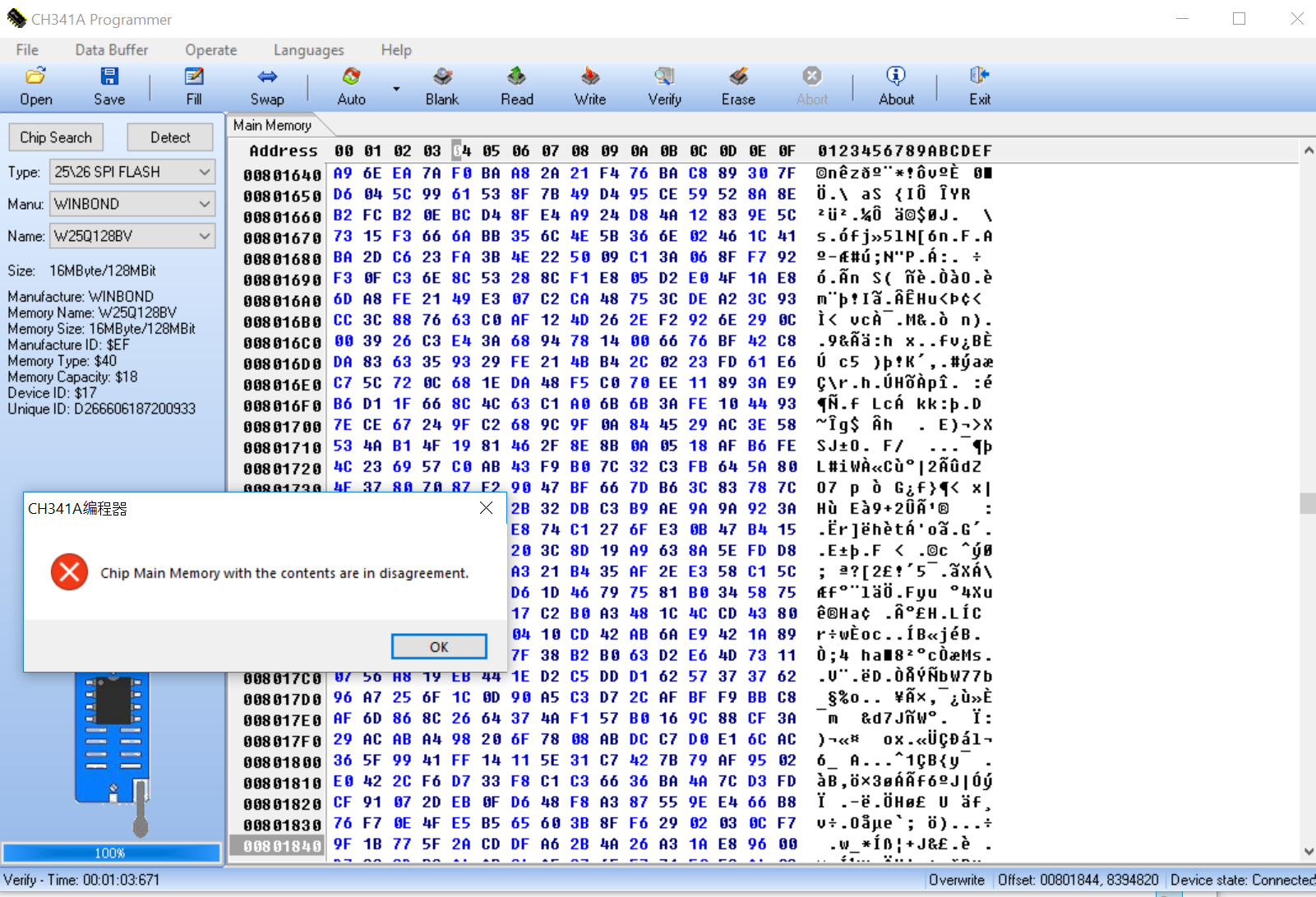

    Hi
    I want to unlock the bios password of my HP 840 G3.I dumb the BIOS with ch341a (USB_Black Edition).If i verify the original Dumb Bios , it show "Chip Main Memory with the contents are in disagrements".Please helps me.I use a lot of Version of the Programm but its same Problem.

    Re: Problem with CH341A
    write the original dump on another Bios chip of the same model. then verify it. probably your old Bios chip is faulty or it is not properly connected to the programmer.
      i does it but its the same Problem.I do its with auto an on verify there stay "Chip Main Memory with the contents are in disagrements"
        I can detect the chip successfull but the verify its fault
          If the programmer cannot write properly on another chip too, then the programmer has some problem. A programmer has resistors, capacitors, and ICs inside. So they may fail too. I use another model of programmer. Members who have experiences with CH341A will help you find what is wrong with this programmer.

                    • 21692
                    Its the CH341A software thats at fault. You can find different software versions in this thread https://www.badcaps.net/forum/showthread.php?t=47246 ,or you can try flashrom on windows
                    https://winraid.level1techs.com/t/gu...rammer/32948/3
                    EDIT: don`t bother trying to use a sop8 clip with the CH341A they don`t work properly , desolder the bios.
                      I too had some problems with this 341A programmer.In the end , I desoldered the bios chip from the motherboard.
                      And then it all worked well .....
                      You cannot use the clip with the cable , and leave the chip soldered onto the MB ...
                      The CH341A may fool you , that it is doing something , while in fact , the results are not good ....
                      At least that is what I have experienced ...
                      You can solder the chip on the small pcb that came with the 341A
                      Good luck
                          @TATA ,
                          Sometimes it is easier to desolder the chip with a hot air station.Put some solid flux on the contacts or pre-solder the contacts with some 60/40 solder (this contains more lead)
                          It is a bit difficult to desolder these small chips with a soldering iron.The leadfree solder is not melting so well ... so you have chance to damage the chip (too much heat)
                          When you have the chip off the MB you don't really need the crocodile clip and cable.
                          You can solder the chip onto the 341A unit on the underside - take very good care of where the dot on the chip must go !!!!
                          The dot indicates Pin number 1 from the chip.I used the socket that I bought from Ali :
                            The Chip is desoldering.I do it with the desoldering Chip.I think the CH341a cant`t flash wson-8 Chip.I buy a TL866 II Plus.I will be come on 01.12.2018 and i try it again.
                              Originally posted by macrepair
                              Hi
                              Your ch341a Black edition looks design for 5v,,,
                              check voltage pin28 ch341a
                              https://www.eevblog.com/forum/repair...er-supply-fix/
                              i fix my self by cut 5v supply bottom board, and connect 3.3v and 5v with a jumper..
                                @rioreno ,
                                Are you sure ??The bios chip that I was flashing was a Winbond W25Q16VB if I remember correctly.
                                It runs on 3.3 Volts ( I measured this voltage when checking things)
                                And I had no problems with flashing the chip - everything went well ...
                                Just take care to put the chip in the correct position and in the right place in the zif socket.
                                If it recognizes the chip it should be fine ..
                                  Originally posted by pecrie
                                  @rioreno ,
                                  yes i am sure..
                                  1.Before mod my programmer can r/w but not all chip, especially 3.3v chip.
                                  2.The meaning 5v fix are ch341a running at 5v, so checked pin28 ch341a..for SPI mode ch341a chip should be 3.3v...,
                                  2.Now after mod my ch341a cannot r/w properly for I2C(5v) ...but for I2C(3.3v) r/w with properly...
                                    Ok i mod it today and try it again.My Chip ist "w25q128fveig"
                                      goodluck, btw you can try using with another software...
                                      Asprogrammer v.1.4
                                        Well I haven't try to flash I2C chips.I only had to reprogram this Winbond bios chip.
                                        I have the black edition and I downloaded the software from the video link from this guy NSC
                                        Like I said , it is not working when you use a clip and cable.Better to take the chip off the board.
                                        I also dld the software update.I have for the SETUP_EXE version 1.5.3.0
                                        and for the CH341A_EXE version 1.18.0.0
                                        I had no problems to reprogram the chip - and the software did detect the chip.
                                        Also R/W was no problem -
