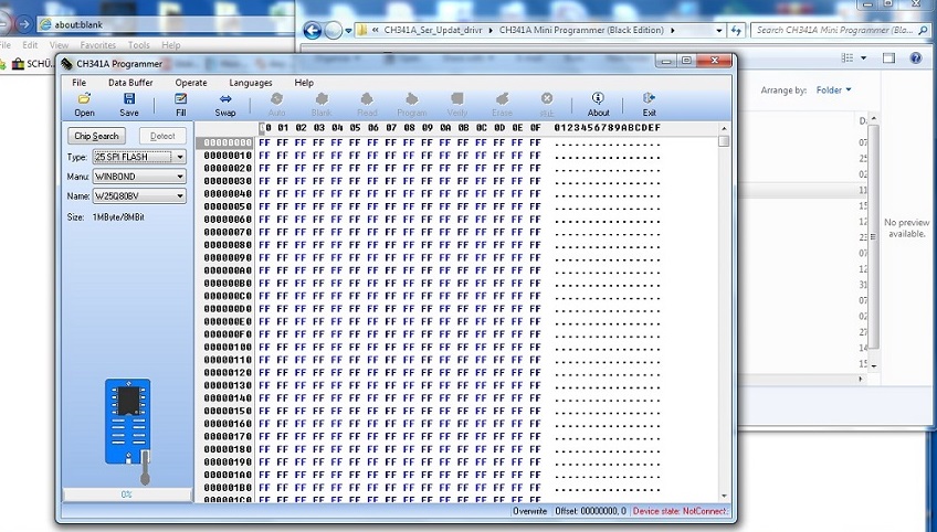

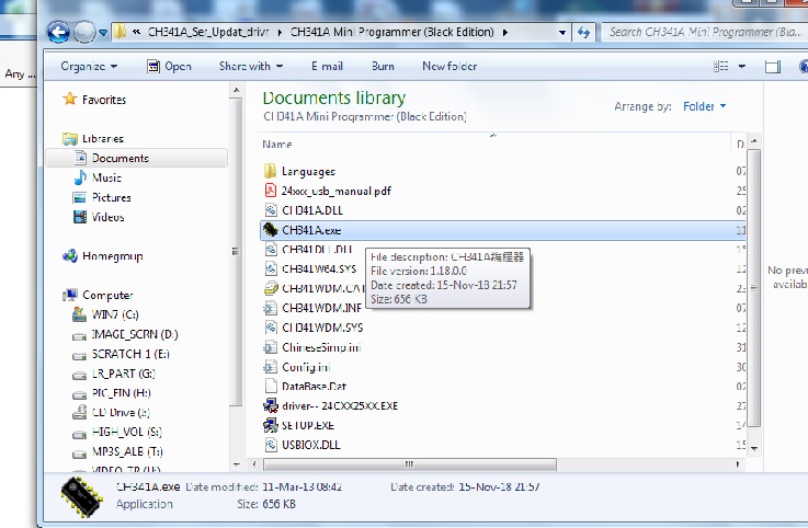

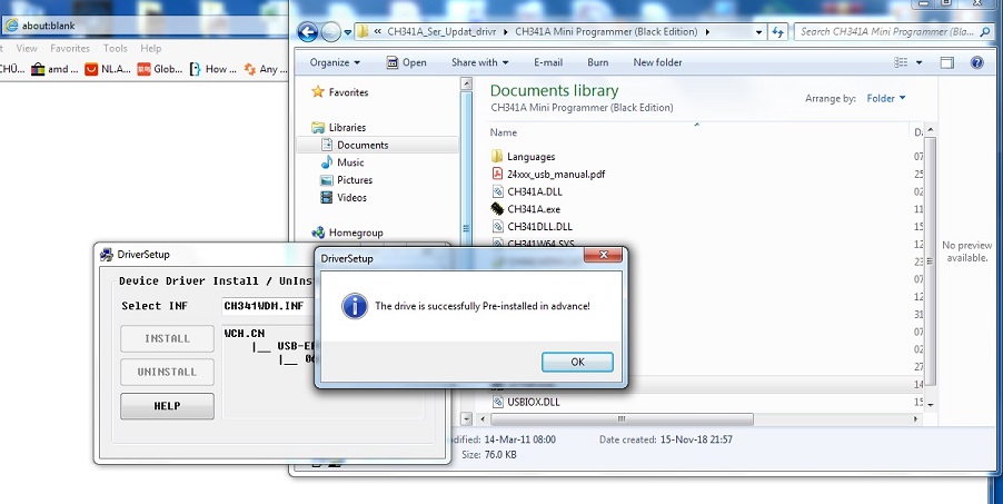

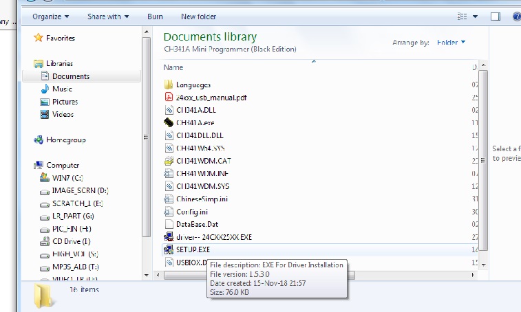

      Re: Problem with CH341A
      Hi ,
      I believe it is the latest , but I'm not really sure.Anyway it worked for me.
      Also I will attach some pictures - printscreens.
      You can download the software for free.
      Furthermore it doesn't make a great difference if you choose the serial driver setup- you will get the same installation files
      That is as far as I could see.
      When you connect 341 to your pc the power led will lit.It means that it gets the 5 Volts.
      In the lower right corner of the flash program screen you will see : connected
      This does not mean , that it has seen a bios chip.When you put a bios chip , the other led (RUN) will lite up.
      The software has noticed the chip.When you press the "detect" button , the Run led will blink 1 time and continues to lite up.
      If it has detected the right brand and model chip , you should be good to go.
      When reading/writing or erasing , the run led will blink with a certain speed.

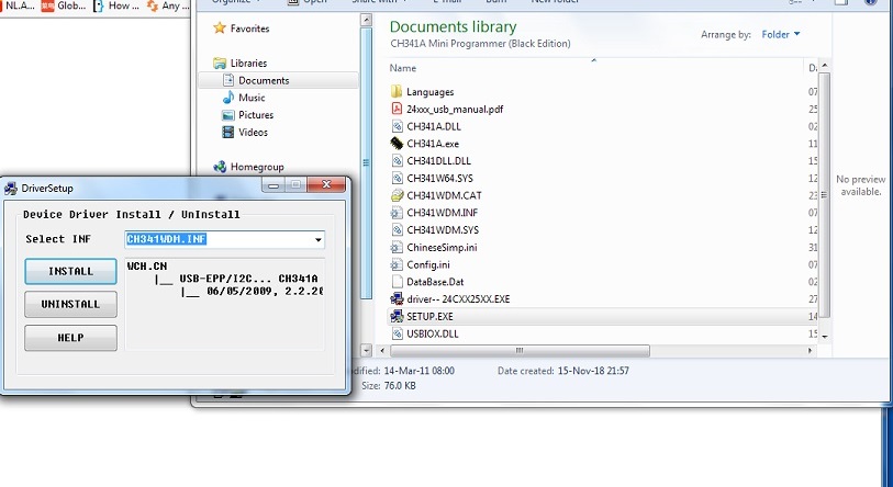

      Of course , first you should run the setup_exe to install the usb driver files.
      Then you can run the reprogram software - 341A_exe
      I have Win 7 Ultimate 32 bits
      HTH
