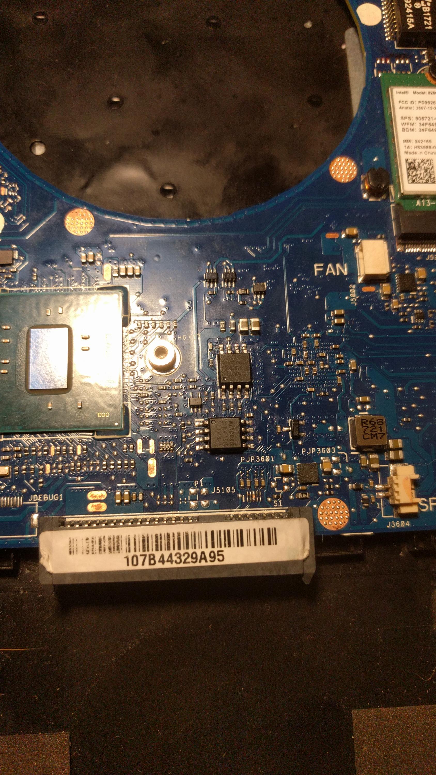

                Hello sorry I'm just home! So there are 2 bios chips from winbond 1x 25Q64FVS1Q (the top)
                and
                25Q80DVS1G (the lower one)
                d
                initially the notebook was still on but the cpu and gpu remained cold and there was no picture! after I have deleted the chip and new bios have packed on it is nothing more, no picture no led no power!
                Does anyone have a solution for me?! I'm desperate

                      Re: Asus GL702VM BIOS dumb?! And Boardview?!
                      Foto

                        Since you said the CPU is cold, the problem is probably related to power rails. But I hope it is not, because there is no schematics/boardview available so that repairing it will be really difficult and time consuming.
                        Probably, someone has got this Bios dump and will upload it here for you.
                        I recommend you fix the Bios first. then, you can continue fixing power problems if there is any.

                              So I only have the 2 chips from Winbond! I take that that is a EC chip? or is the EC on an SIO chip? Unfortunately, I deleted both chips from Winbond! and now it does not make any noise No Power! I dont find the bi bios only the main bios! by ************ o Vina

                                  If it is a Bios problem, at least the power LED should be on. Now find the model of the SIO chip on the mainboard.
                                  I hope someone upload a bios dump of this laptop here soon.
                                  I recommend you do not do any repair on this laptop before finding a Bios dump, because the problems may get worse.
