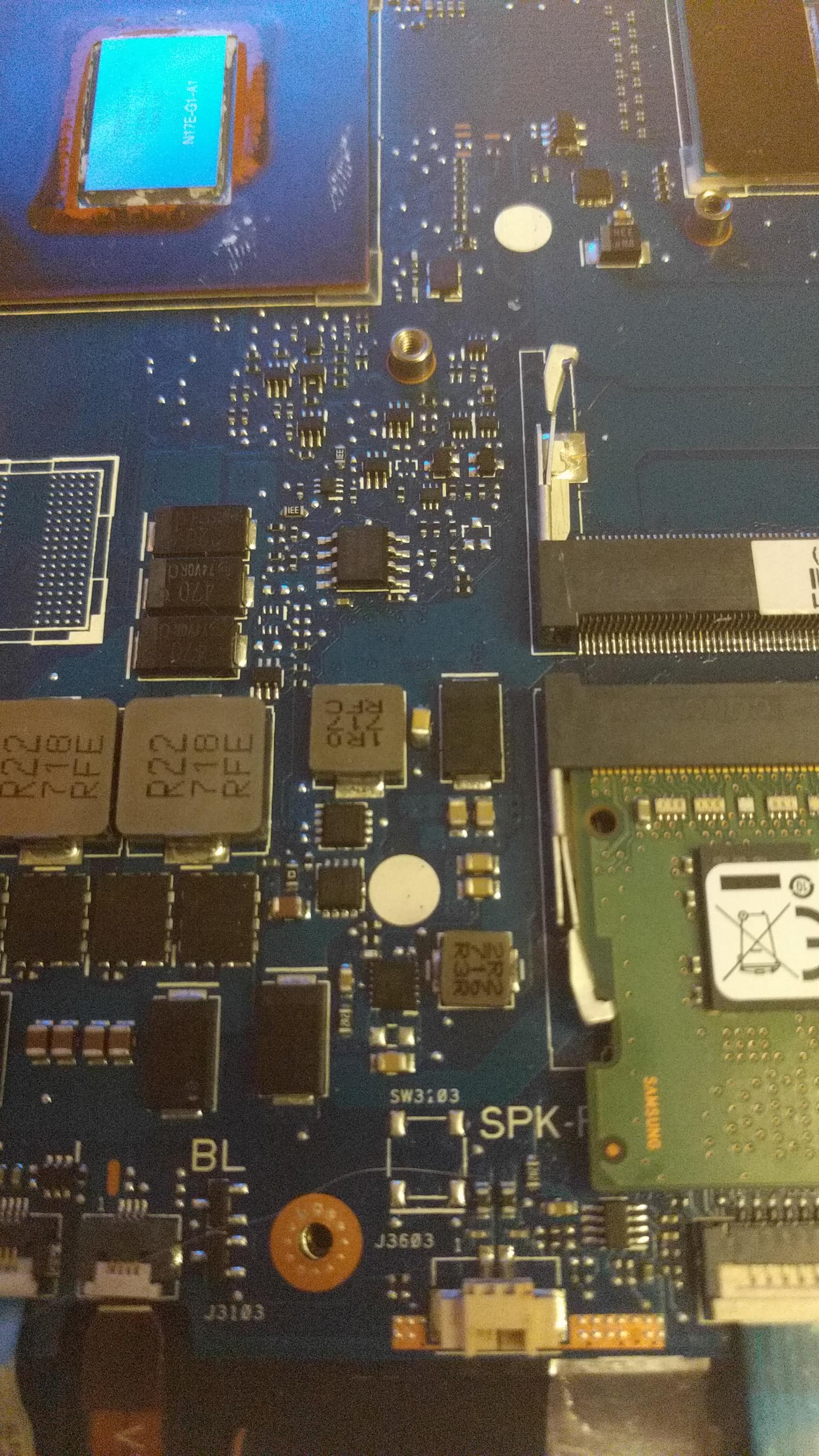

                        I asked the previous owner once again, and ee said the device went off while the bed sieves! and then he angacjt it and had black screen only you power led lights! normally sond ddr4 240hz ram in it, but I have only ddr4 2144mhz teotzd should be compatible?
                        I hane seen that the previous owner soldered to an amd part, a small capacitor near the RAM memory! (photo) but if that is a primordial guard? Hmmm

                          In the middle from the coil 1r0

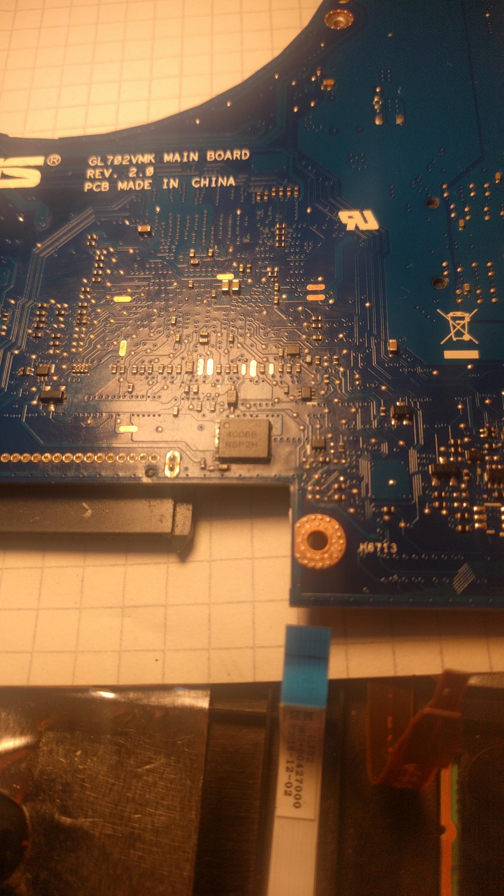

                                Re: Asus GL702VM BIOS dumb?! And Boardview?!
                                Hello, the full name of the model is: GL702VM - BA252T and that is the name of the mainboard: 60nb0dq0-mb1630 The RAM memory is okay, other synonymous have tested the same error! The bios can be natural, the question is only where I get the other ?!

                                    Thanks for the file, unfortunately, is still the same problem. CPU gets hot, GPU gets warm, fan does not turn and also the HDD does not go on (so does not spin) (no storm?) is it vllt but the Sio? or vllt genuinely the BIOS?
                                    On the mainboard is also gl702vmk on the notebook but GL702VM
                                    I'm sorry, I have no idea what it can be.

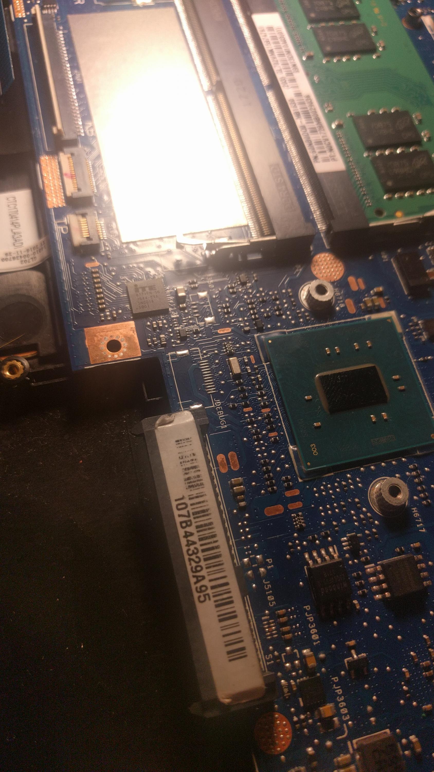

                                      can someone tell me something about this chip? what is the task? ite 8171fn-56! Thank you

                                        maybe I found a broken part! name: 4c06b rgp2h! it has no passage with the multimeter
                                        The Others give me a beep by messure
