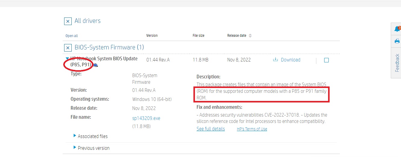

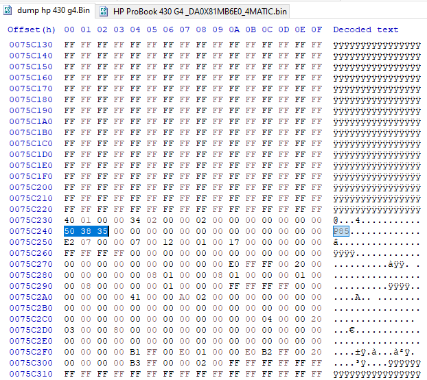

                                      I'm a little confused, why his original file is (P85) and your file is (P91)?

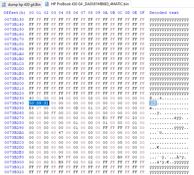

                                          i was confuse also when i check Original dump and try to find it in HP Support even in older version but P85 was not available accept P91
                                          than i start to read given information by HP and they said P91 supported as well so i build with that
                                          .........lets see
                                          NOTE :- IMAGE ATTACHED
