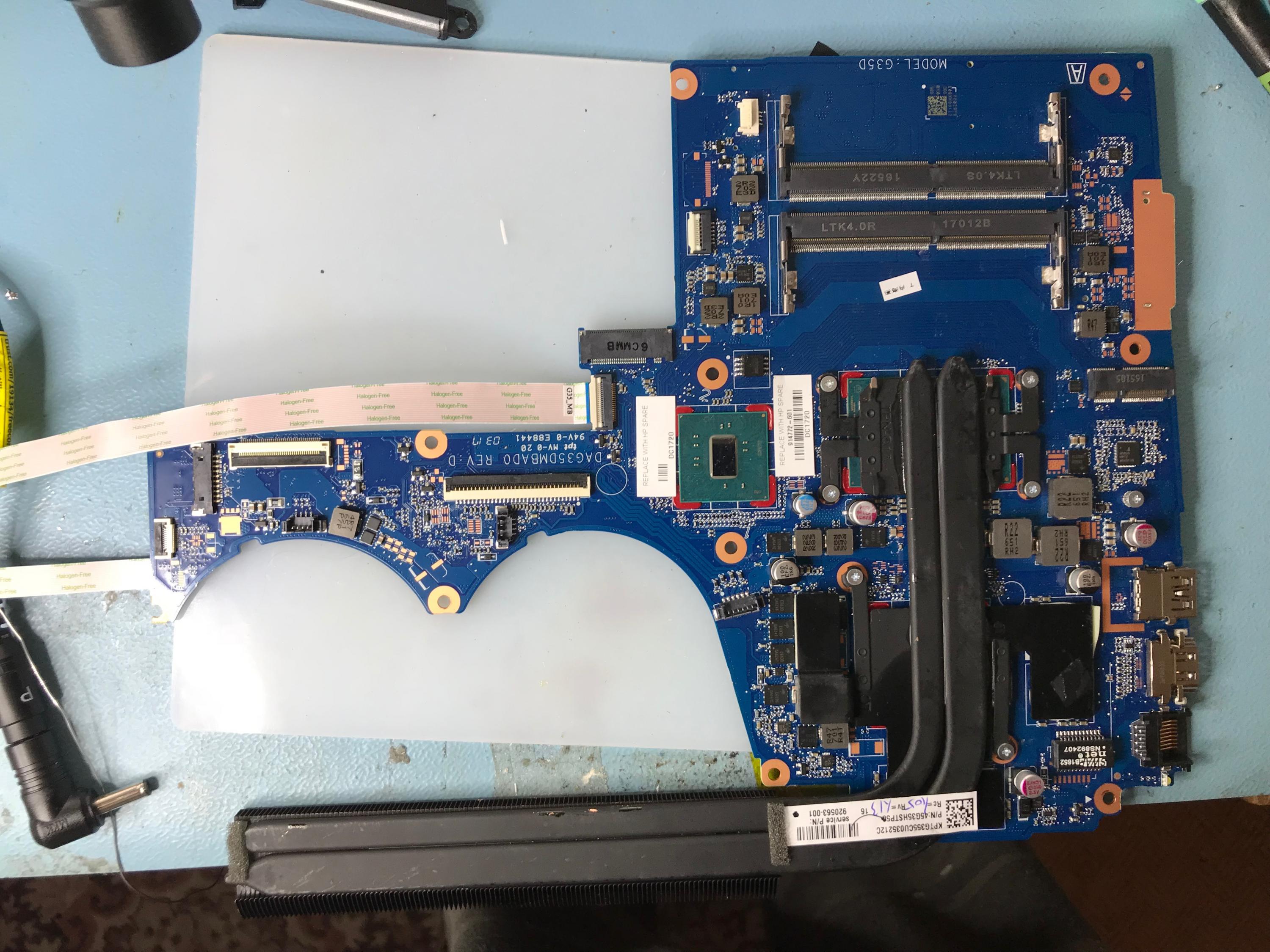

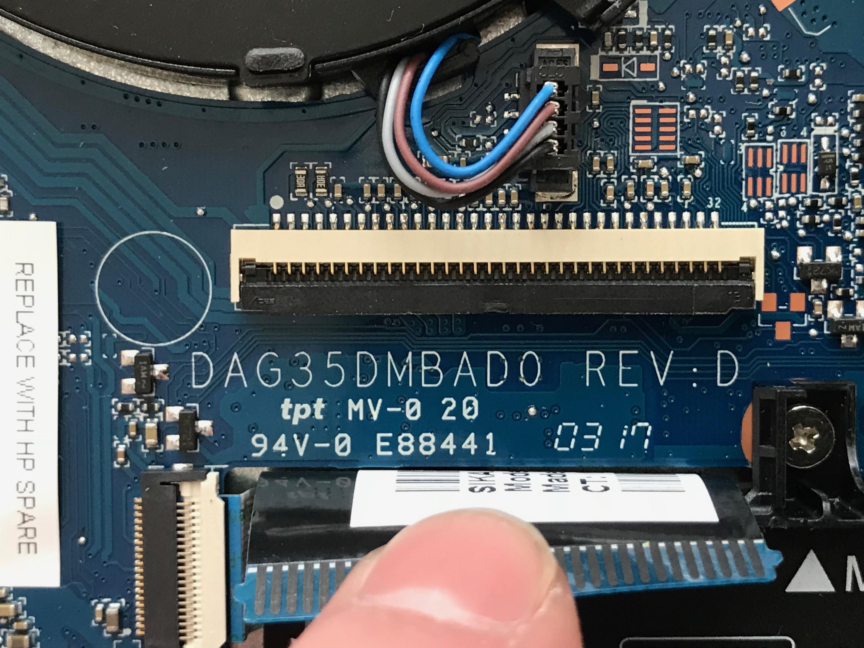

    I need bios dump for this mobo: dag35dmbad0 rev: d
    I attached backuped bios file.
    Thanks.

    Re: HP Omen 15-ax201ns bios dump
    I check your bios and bid, so this is your bios coming from a paid forum but i want to share here your BID 08217

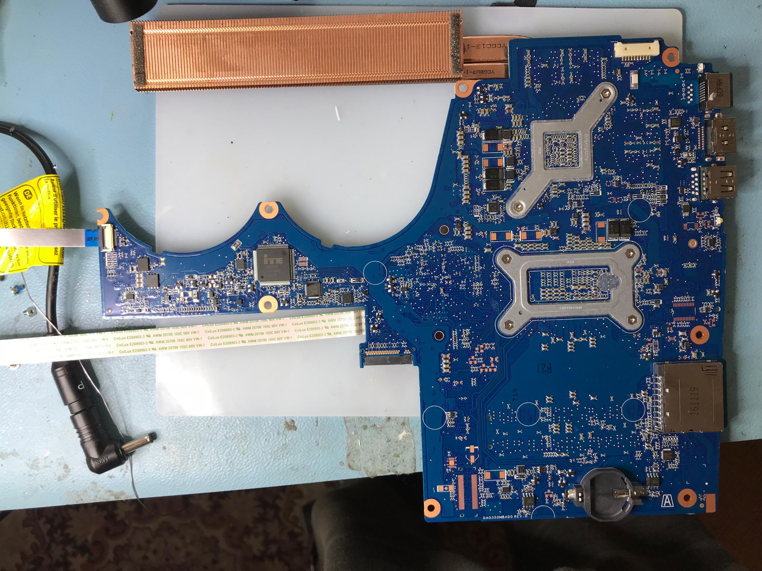

      Thank you very much for bios files. Where is EC bios located on board? I thought only one main bios chip is there ,but u send me also EC bios. Have someone schematic?
        128kb is for ITE chip try flashing the main bios first
          I flashed main bios, but notebook is totaly dead as before . No lights, nothing. I don't have any voltages , only 19V rail..
          What are these ic's?
          7J-3L
          Z22610
          MT608
          95829 hrtz
          4e=3k
            maybe your problem is not bios issue you need schematic for this maybe someone here in this forum can give you
              Thanks.
              and 7J is RT8816AGQW. No voltages on IC's.. only 19V is on mosfet near DC IN connector. I need schematic..Does anyone have it?
                here is bios for every version of HP Omen 15-ax201ns
                check you BID or try until you match bios
                those are virgin bios, not dumps from boards, so me is clean
