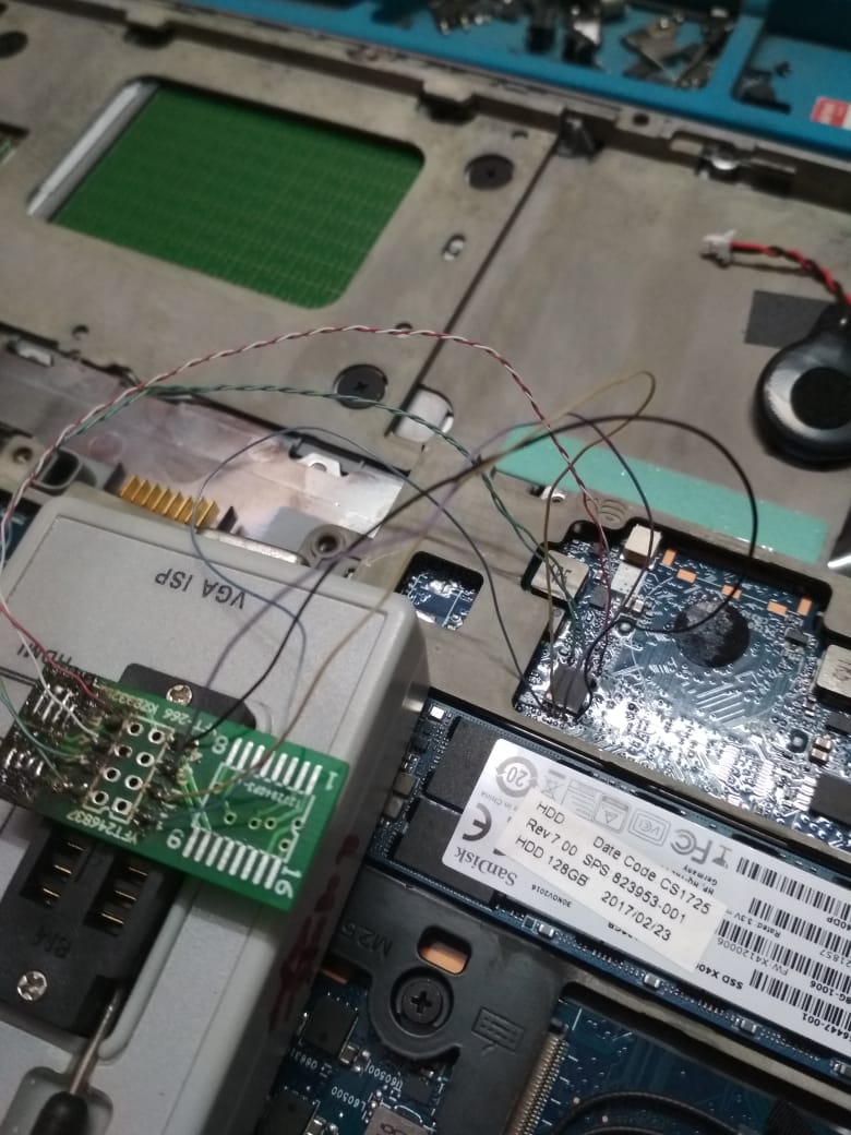

                                      • LVLO
                                        • Dec 2019
                                        • 4
                                        • France
                                        #299
                                        Re: bios dump elitebook 840 g3
                                        Hello, some of us have tried and achieved to clip 25Q128FVPQ or the only way is to de-solder the ship ?
                                        Thkx
                                        • Rupesh
                                          • Aug 2013
                                          • 13
                                          • India
                                          #300
                                          no u can easily solder some wires to side by side chip for soic20 ic pins and program it see the pic which i worked
