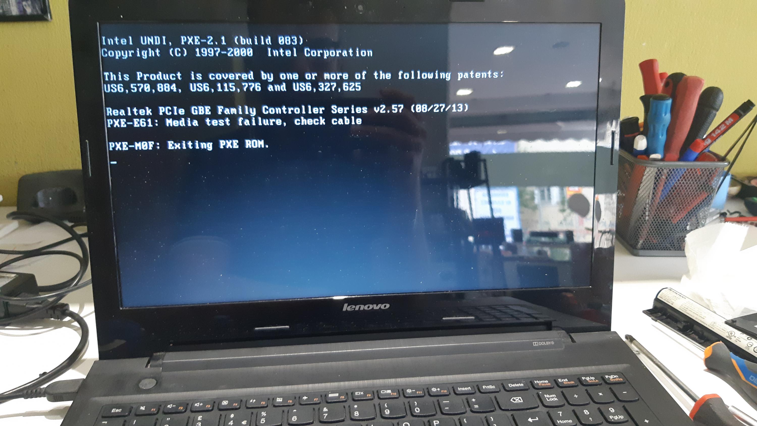

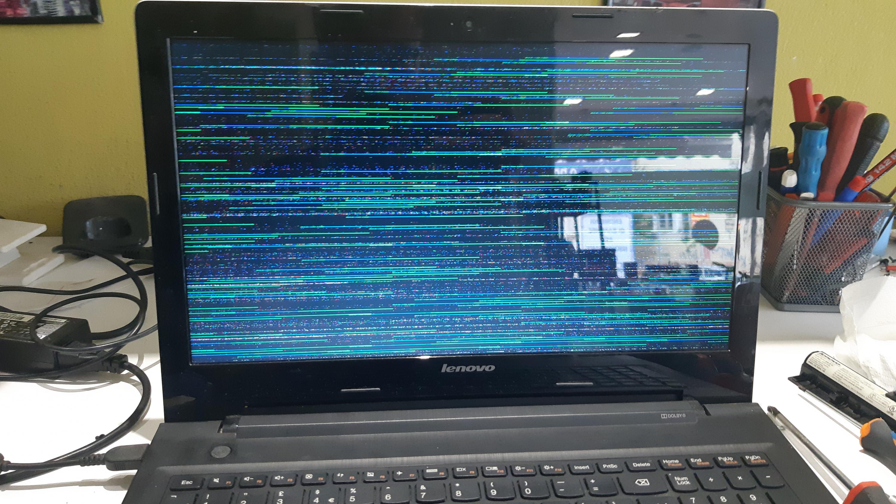

            Re: Lenovo G50-80 tested ec and main bios needed
            Guys i need help. I have a NM-A361 board. I had black screen. I updated the bios from user p7comuter. His bios was for i7 cpu. My cpu is i3.
            After the successful update i have this issue. Look at the pictures. I have particles when it starts but after that without the hard disk, the DOS mode works good. But it can't proceed in windows.
            I have changed also ram..
              Hi you can't just take a bios from another machine FIRST it will have a dirty ME REGION Once a computer boot it's marred to that computer unless it a full new downloaded bios from lenovo or you rebuild ME REGION. Unplug internal cmos battery for like a min plug back in see if it boots . Or put original firmware bios back see if it boots to an external monitor if yes either go to dell download and do the update with in windows if no boot you need use a external programmer and i will upload you a new clean file.
                @memoslar, have you checked bios settings for Legacy and UEFI?? Hdd not detecting may be a bios setup issue as well. @techman1025 is right about me-region issue ,so do flash a lenovo virgin bios for your mb or make a request at bios section(A working clean me bios will be equally good). But the garbage display in the pic at post#9 worries me-is that indicating some other problem?? MB is discrete or UMA??
                  It is discrete graphics...
