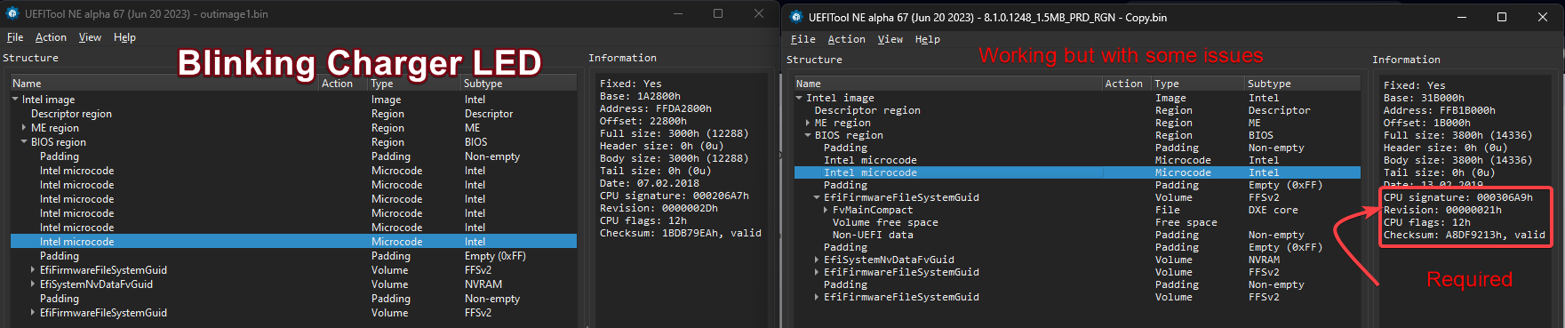

      Re: HP Probook 4540s - BIOS
      Originally posted by peste
      try this..
      Hi @peste. Thanks for your reply and the bin image you attached. I appreciate it very much indeed.
      I flashed your outimage1.bin on the 8MB chip (which is currently soldered to the board) after a full erase and I got a "blinking charger" LED. I did not get any display. CPU did not seem to POST.
      Gentle Reminder : I am using a 4540s's BIOS on HP Probook 4530s to get IvyBridge Support with i7-3840QM processor on 4530s chipset (HM65) - which works fine but with some issues . For context see OLD post here with screenshots:
      https://www.badcaps.net/forum/showpo...&postcount=139

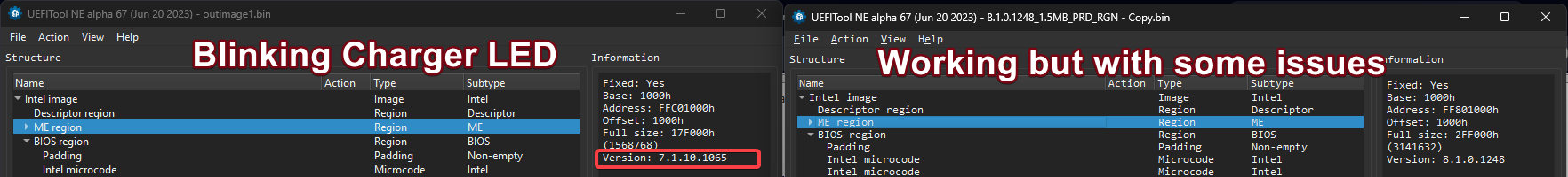

      I noticed the following with outimage1.bin which you provided:
      1. The bin image is 4096KB for the original MX25L3206E 4MB chip while the chip I am using is an 8MB chip (W25Q64FVSIQ)
      2. The bin image has an ME of 7.1 while 8.1 ME is required for IvyBridge support (i think)

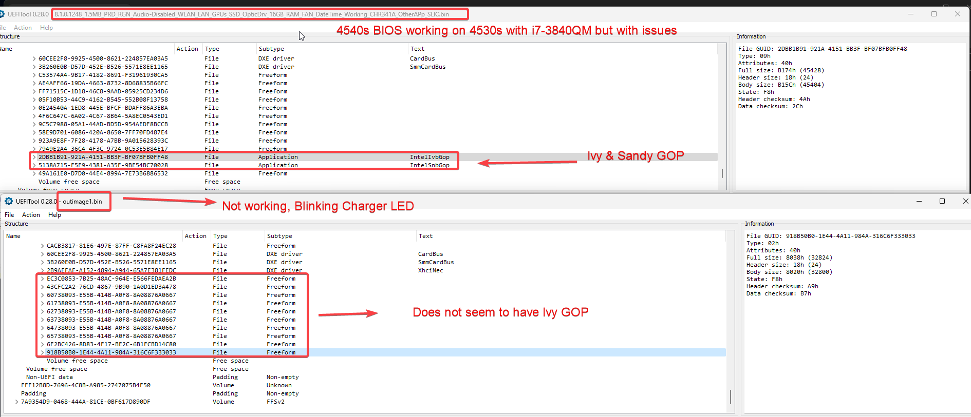

      3. The bin image does not seem to have any Ivybridge GOP driver ( I used UEFITool to check and I am not an expert so please excuse my ignorance in this regard).
      4. The bin image seems to have microcodes only for 000206Ax while i think, for 000306AXh is required for IvyBridge i7-3840QM
      Here by X i mean numerics for revisions
      Quick questions:
      1. Could you share technical details regarding what things did you change in this outimage1.bin you attached?
      2. Should I put the 4MB chip back and flash this image?
      3. Maybe it's a good idea to modify the 4540s image I attached in my message ( i am attaching it again for reference)
      Please note that Probook4530s had a 4MB chip originally which I have replaced and put in an 8MB chip to allow flashing of 4540s BIOS and that the attached "[4540s]8.1.0.1248_1.5MB_PRD_RGN_Audio-Disabled_WLAN_LAN_GPUs_SSD_OpticDrv_16GB_RAM_FAN_DateTime_.zip 8MB image" works on 4530s with an 8MB chip but with problems mentioned in previous posts.
      Side by Side Comparison (left[blinking LED] vs right (working but with issues))
      ME version 7.1 vs ME version 8.1 - 8.1 is required (i believe)
      000306AXh microcode is required for IvyBridge i7-3840QM
      IvyGOP is required which is present in 4540s BIOS but missing in outimage1.bin
      @peste
      The only issues with you (originally submitted) BIOS i.e. https://www.badcaps.net/forum/attach...9&d=1699204636 are the following issues:
      1. Keyboard is very slow
      2. Touchpad is very slow
      3. Audio must be disabled in BIOS only then windows 10 or windows 11 installs/boots.
      4. Win11/Win10 writes something to [4540s]8.1.0.1248_1.5MB_PRD_RGN_Audio-Disabled_WLAN_LAN_GPUs_SSD_OpticDrv_16GB_RAM_FAN_DateTime_.zip bios in the chip after Windows Updates and a result, laptop stops posting
      Can we fix these issues somehow? I am happy to use the 8MB BIOS ([4540s]8.1.0.1248_1.5MB_PRD_RGN_Audio-Disabled_WLAN_LAN_GPUs_SSD_OpticDrv_16GB_RAM_FAN_DateTime_.zip ) on an 8MB chip and not the 4MB one because I believe it lacks IvyBridge and ME support. Only if we could fix the above issues!
