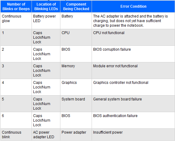

                        #131
                        Re: HP Probook 4540s - BIOS
                        This is a list of common HP blink codes. Please note that it doesn't cover all cases of malfunction.

                          #132
                          Hi ivastchip,
                          Thanks for your reply.
                          I've looked at the codes as well. The original BIOS had the Caps lock blinking continuously, indicating something to do with power. Other Bioses had the Caps lock blink 3 times, indicating memory issues, however this was happening even without memory stick inside.
                          In any case, I believe that whatever the issue is, it's not [necessarily] related to the BIOS, so I gave up on fixing it.

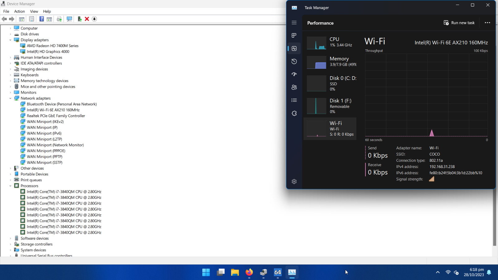

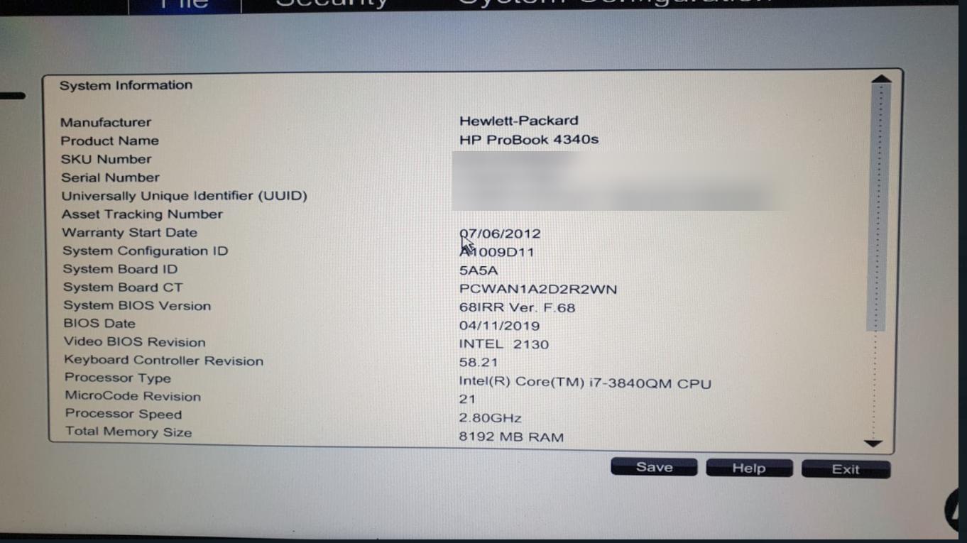

                            Hi, Sorry if i am reviving an old topic, but is it possible to modify the "8.1.0.1248_1.5MB_PRD_RGN" ROM to set "UEFI boot (without CSM)" as default?
                            Current it is set UEFI Hybrid which causes problem with Rufus boot and I would like to install windows from USB but Rufus complains that it needs UEFI native (UEFI without CSM) to work.
                            I am using this Probook 4540s BIOS on Probook 4530s (using an 8MB 25Q64 chip, to allow IvyBridge support - which works) but the Keyboard is extremely slow (maybe need to borrow EfiLowLevelKeyboard.ffs from 4530s BIOS?), mouse and touchpad does not work and settings don't save. So I am hoping you can help with this :'(
                            Desired Configuration if possible..
                            Appreciate your help. Thanks

                                English is not my native language so excuse my manners if I sound rude. Apologies in advance. :'(

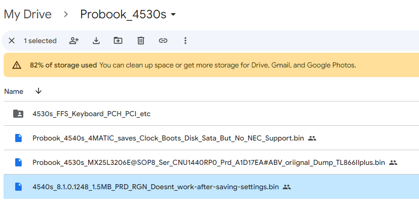

                                Yes, I have the dump of the original BIOS but the original BIOS of 4530s does not support IvyBridge because 4530s does not have Sandy-Ivy Support and does not have the necessary GOP drivers of for GPU.
                                Original BIOS (4530s Dump with Serial and PROD) + 2 4540s BIOS that let the system boot + FFS from 4530s that I have tried to inject

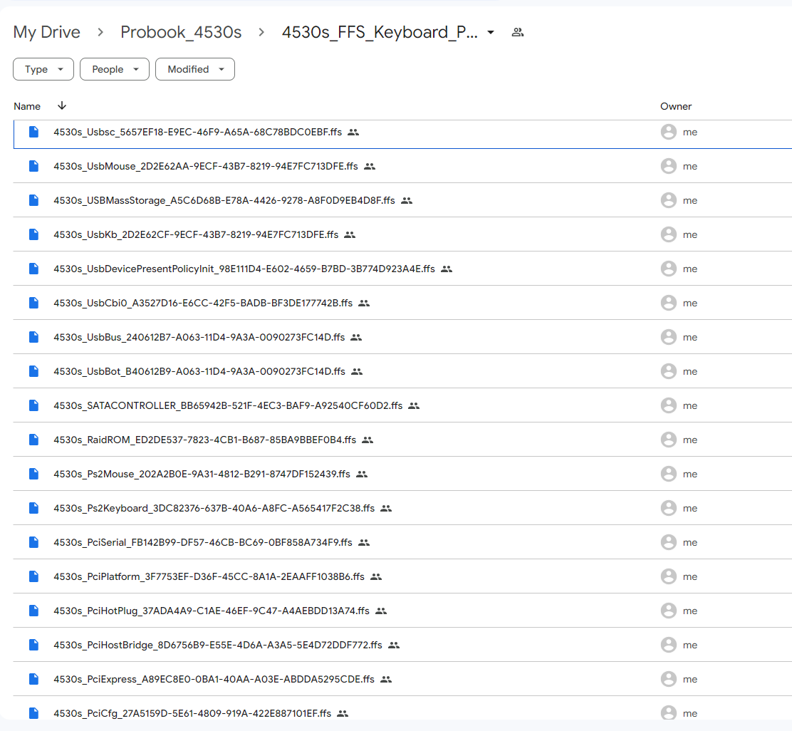

                                FFS Files extracted from 4530s using UEFITool
                                Problems with 4540s BIOSes
                                1. Keyboard is extremely slow in BIOS
                                2. Touchpad/Mouse does not work in BIOS
                                3. USB ports attached to the NEC/Renesas/USB3.1 side don't work
                                4. Saving BIOS only seems to work with the following BIOS(es)
                                HTML Code:
                                Probook_4540s_4MATIC_saves_Clock_Boots_Disk_Sata_But_No_NEC_Support
                                and
                                4340s BIOS
                                5. 4540s_8.1.0.1248_1.5MB_PRD_RGN_Doesnt_work-after-saving-settings.bin works but also has all the above problems plus CDROM does not work with it and after saving BIOS, the display disappears. fan runs on full speed after that...

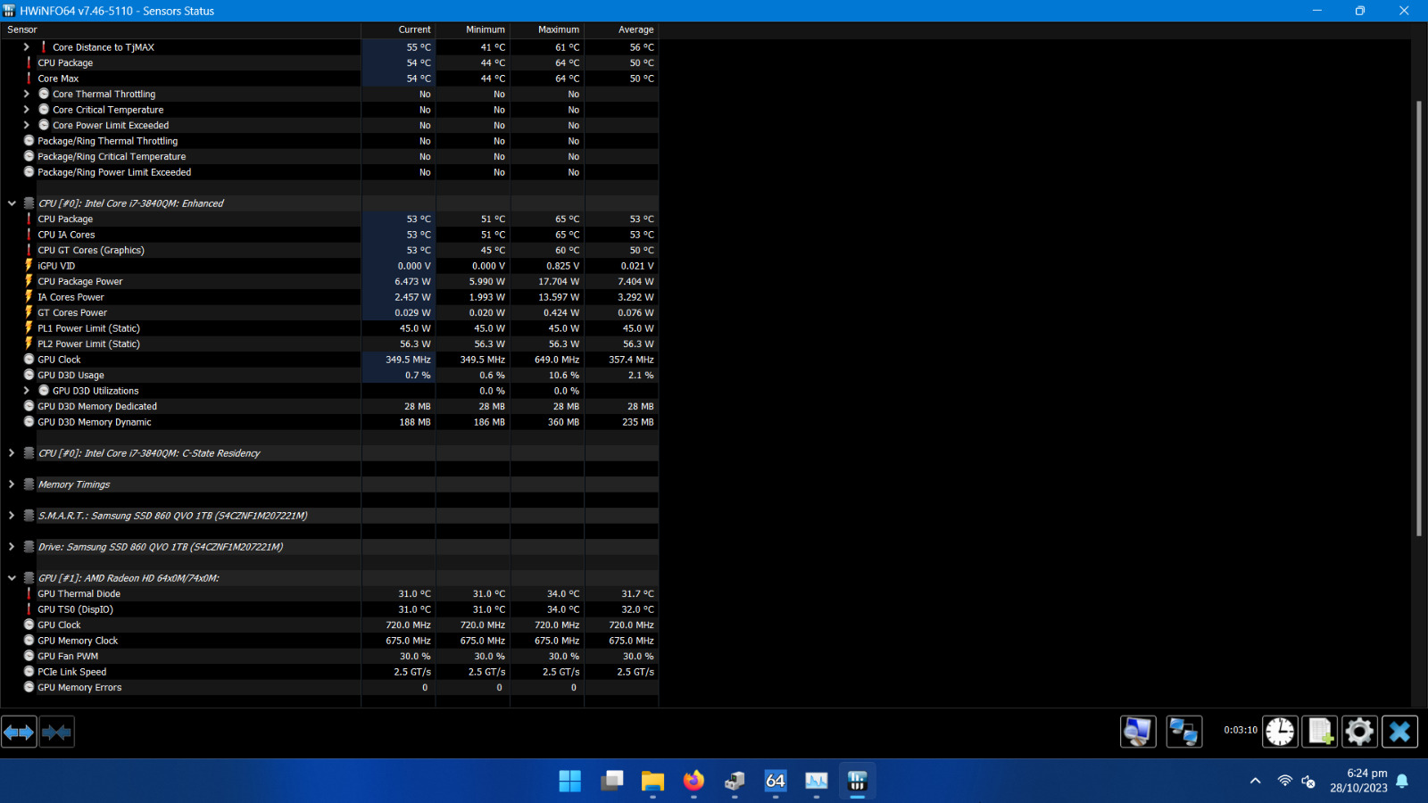

                                I have two processors. i7-2860QM and i7-3840QM. A new CR2032 cell is installed for CMOS data retention.
                                1. i7-3840QM - runs extremely cool! The display works but only with 4540s BIOS (copied shared above, originally shared in this thread). No Display with 4530s BIOS because of an obvious Lack of Support for IVY.
                                2. i7-2860QM - runs extremely hot , works with both 4540s and 4530s BIOSes and with WIN10/WIN11 it takes a very long time to install (3 hours) and boot (15-20 minutes), CPU usage remains high after boot
                                Thus my motivation to use i7-3840QM.
                                I have a custom rig to the cooling fin, fan for the PCH CHIP, CPU CHIP and the dedicated graphics Chip all set inside the laptop. so heat can be managed if at all with i7-3840QM.
                                I am a software engineer by profession and know my way (a little bit) around IDA pro, WinHex/Hxd and have been experimenting with UEFITool and following various guides to port the DXE Drivers (for SATAController, RaidDriver and EfiLowLevelKeyboard) from 4530s to 4540 BIOS. but any change/import to 4540s BIOS results in no-display on the laptop screen. 4540s BIOS gives display on Probook 4530s machine if I use the BIOS on an 8MB chip as it is.
                                I have a lot of 8MB chips to experiment with and TL866II+ programmer and I have flashed a few bios to laptops (no bragging, just sharing what I am open to doing... and learning!)
                                The BIOS with the PRD_RGN suffix is one of your Bios copies shared in this very thread.
                                I understand that this may be a bit daunting task and somewhat ambitious but if I can make this work, this can help potentially many others around the globe who have this (once popular machine) and I can make my 4-year-old take classes on this LOL (as an added advantage). Not to mention, I will be able to learn and potentially help others based on this experience.
                                With i7-2860QM or lower, I can barely run WinXP...
                                What I wish could work is
                                1. Use 4540s BIOS because IvyBridge and HD4000 graphics can be used with low-heat
                                2. Can use Windows 10 or Windows 11 (already have a SATA3 SSD)
                                3. If possible, EfiLowLevelKeyboard (from 4530s) could be imported and injected into 4540 BIOS (if that solves the extremely slow navigation in 4540) BIOS
                                4. Import Raid Controller DXE Driver from 4530s
                                5. Sata Controller from 4530s (if that is better and more compatible)
                                6. DXE Driver for NEC/Renesas so that USB 3.1 Boot can work in UEFI mode
                                7. Ability to save the settings in BIOS (if its possible)
                                I have attempted creating variants of 4540s BIOSes for all these (from 1-6 points) using the UEFITool (using ExtractIs and ReplaceIs & verifying using UBU Tool) but the resulting modified "4540s BIOS copies" don't give any display on 4530s and cause full fan speed (indicating the BIOS didn't load properly?). Only the original copies of 4540s shared in this thread/mentioned above show Display on Screen with IvyBridge.
                                Maybe, I am using an incorrect approach? Any guidance regarding the correct approach will be greatly appreciated!

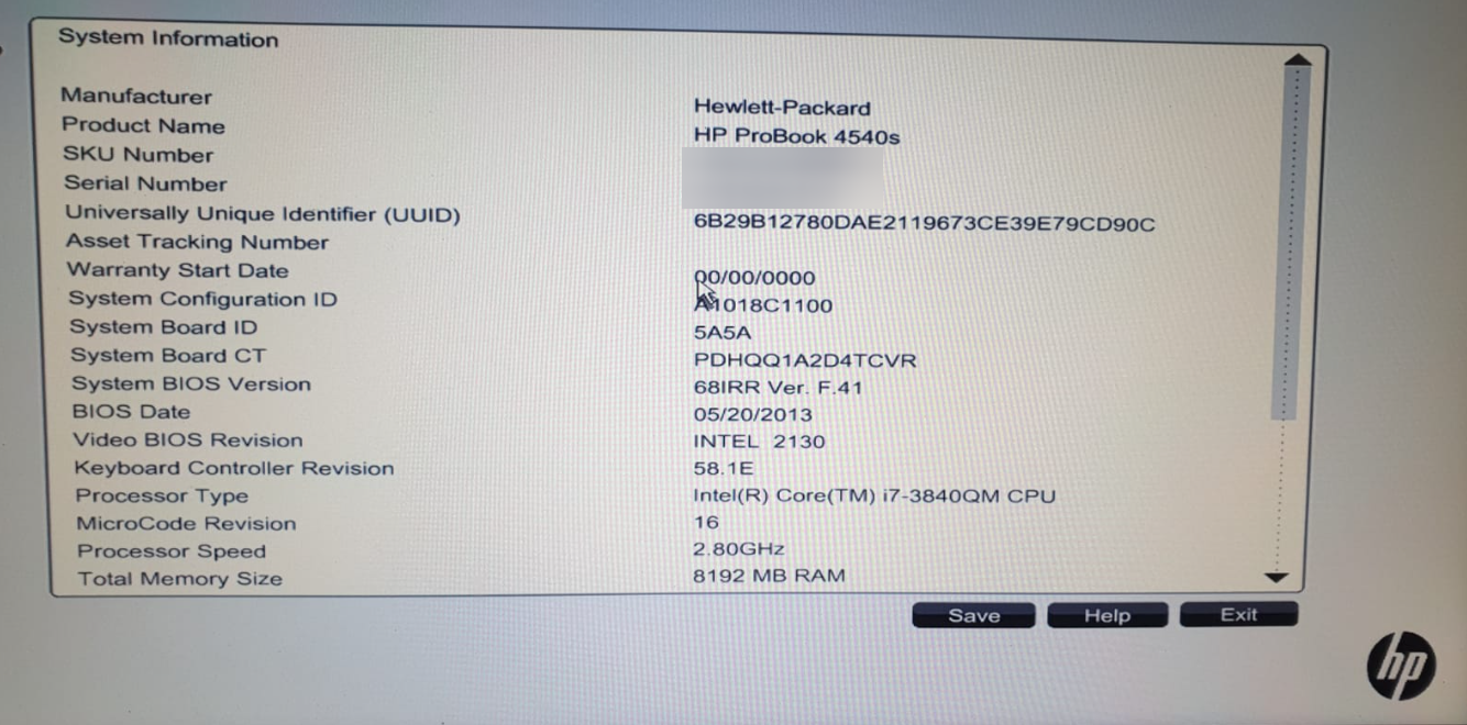

                                4504s Screenshots from the two 4540 BIOSes.
                                1.4540s BIOS
                                2. 4340 BIOS that also works but with the same problems as above
                                I hope it's not too much to ask (or maybe it is...) :'(

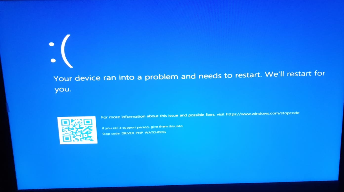

                                      I have made some more progress with my experiments.
                                      At this point in time, I only want to have the SataController of the 4540s firmware replaced with the one present in 4530s.
                                      If that is done, I hope, I can install Windows 11 and bypass the “Driver PNP WatchDog” error
                                      My understanding is that, with the current state, (Driver PNP WatchDog error) it should be possible to install any other OS such as Linux or maybe older version of Windows… but I hope to be able install windows 10/11. So I am wondering if only the above-mentioned change is possible…
                                      @peste Do you think, that a single change, is possible?

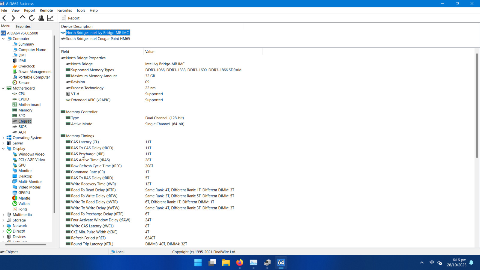

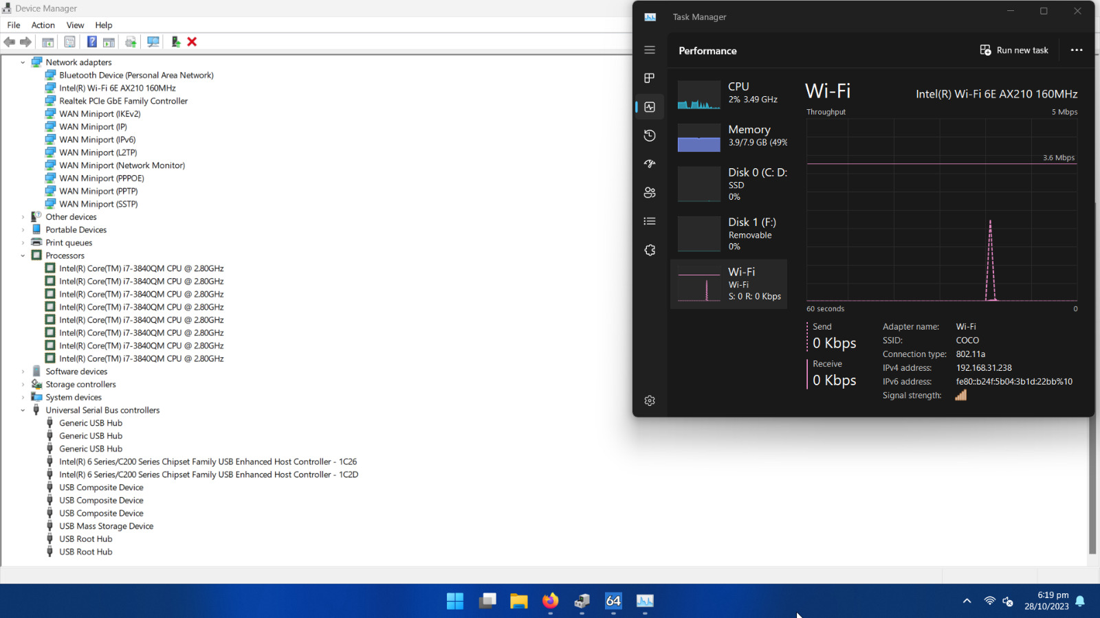

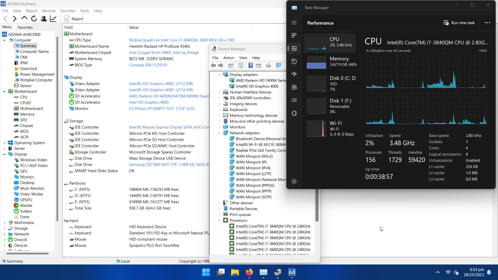

                                        I have made some progress by flashing your firmware quoted above on 4530s and except the Audio, Power Monitor Circuit, Keyboard, Touchpad and the left-hand-side USB ports, everything else seems to work.
                                        Audio had to be disabled in BIOS otherwise Windows 10/11 clean install from USB/DVD fails with Driver PNP WatchDog error on BSOD
                                        Another issue is that Windows 11 seems to write something to this firmware (see quoted message) and it stops loading/POST-ing and BIOS needs to be flashed again.
                                        I have some questions:
                                        1. How can we prevent "Windows 11 Update" from writing to BIOS?
                                        There is no firmware entry in Device Manager so I can not disable it there.
                                        Disabling Driver Downloads in Windows seems to have no effect.
                                        2. Is there a way to make BIOS chip read-only? I am using WIBOND W25Q64FVSIG
                                        2. Is there a way to import the Power Management Module/Power Monitor Circuit from HP Probook 4530s's BIOS?
                                        3. Is there a way to import the Keyboard Controller (KBC) from HP Probook 4530s's BIOS?
                                        5. Is there a way to import the Touchpad Controller firmware from HP Probook 4530s's BIOS?
                                        I am attaching the BIOS firmware from HP Probook 4530s as well as the 4540s's one that you have provided (which I am currently using).
                                        Kindly respond and help if you can. Thanks
