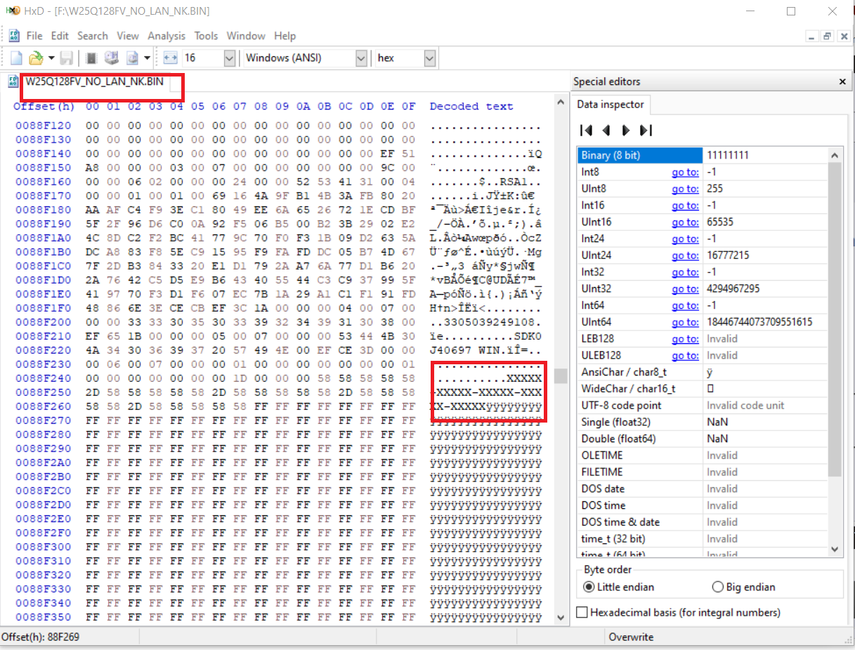

          I found at this link there is in HEX 0088F200 Windows KEY.
          I neet to transfer my one. Do you think it's just about to copy 0088F200 - 0088F260 to add key to bios?

            In the file w25q128fv_bad.bin there is no windows key.

              I have other damaged board from L570 with key. I want to move key to this board. Could you help making XXXXX- and i will paste my key later? Don't want to use public key or make my one public.

                You can copy it in ok ,everything after the right arrow >

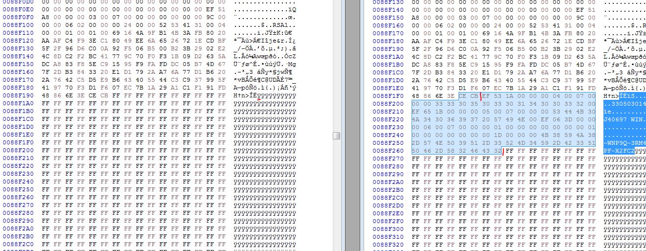

                  This didn't work out. It shows no OA2 key.
                  I was looking that newest BIOS hide CD-KEY, maybe it's necessary to downgrade BIOS to older version and then add key or this operation require to change bigger part of BIOS.
                  i've tried downgrade BIOS to 1.42 (in such i see KEY, but 1,57 start hiding keys).
                  edit:
                  i found also at 0019BDC0 somethink about WIN key. Need to analyze WIN and NON-WIN BIOS...

                      i don't see any option to add Win key in Lenovo disk. There are just some motherboard related keys to add, or i'm blind
                      Attached is working BIOS, started-up after ME cleaning, but still LAN don't work on this one.
                      Do you know how to combine both BIOS to have WIN key and LAN working?

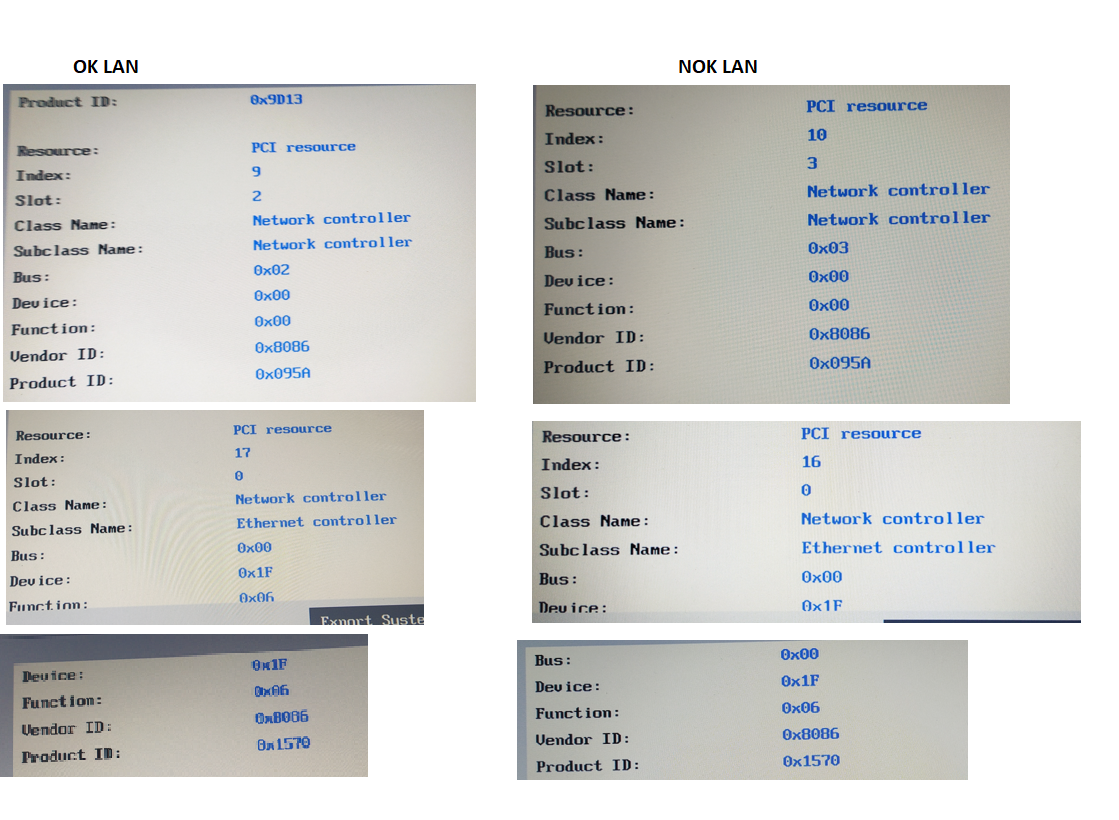

                            I compare Bios with OK LAN and NOT OK LAN in Lenovo Diagnostic Tool.
                            Looks like there is other index / slot of PCIe, so maybe BIOS is adressing wrong hardware?
                            EDIT:

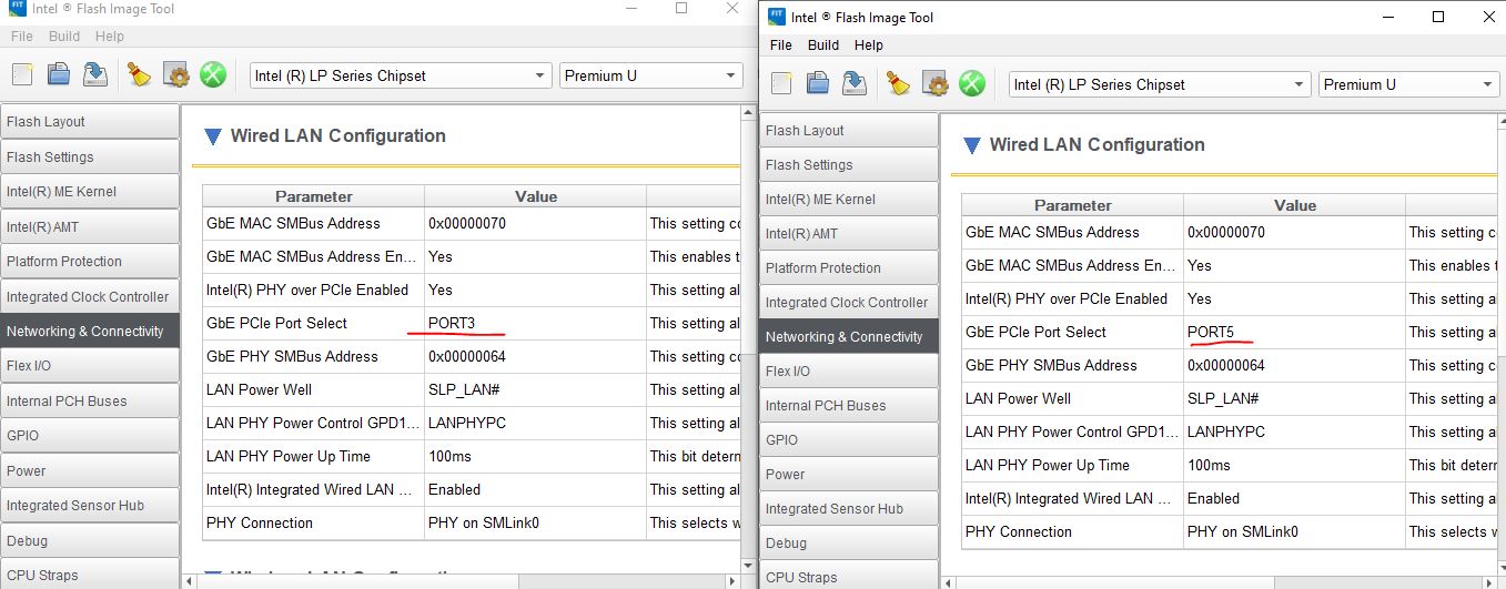

                            Fond this possile to change in FIT, attached pic.
                            will change and maybe will work.
                            EDIT2:
                            After changed in FIT PORT5 to PORT3 LAN work again
                            Thank you for all hints and support!
