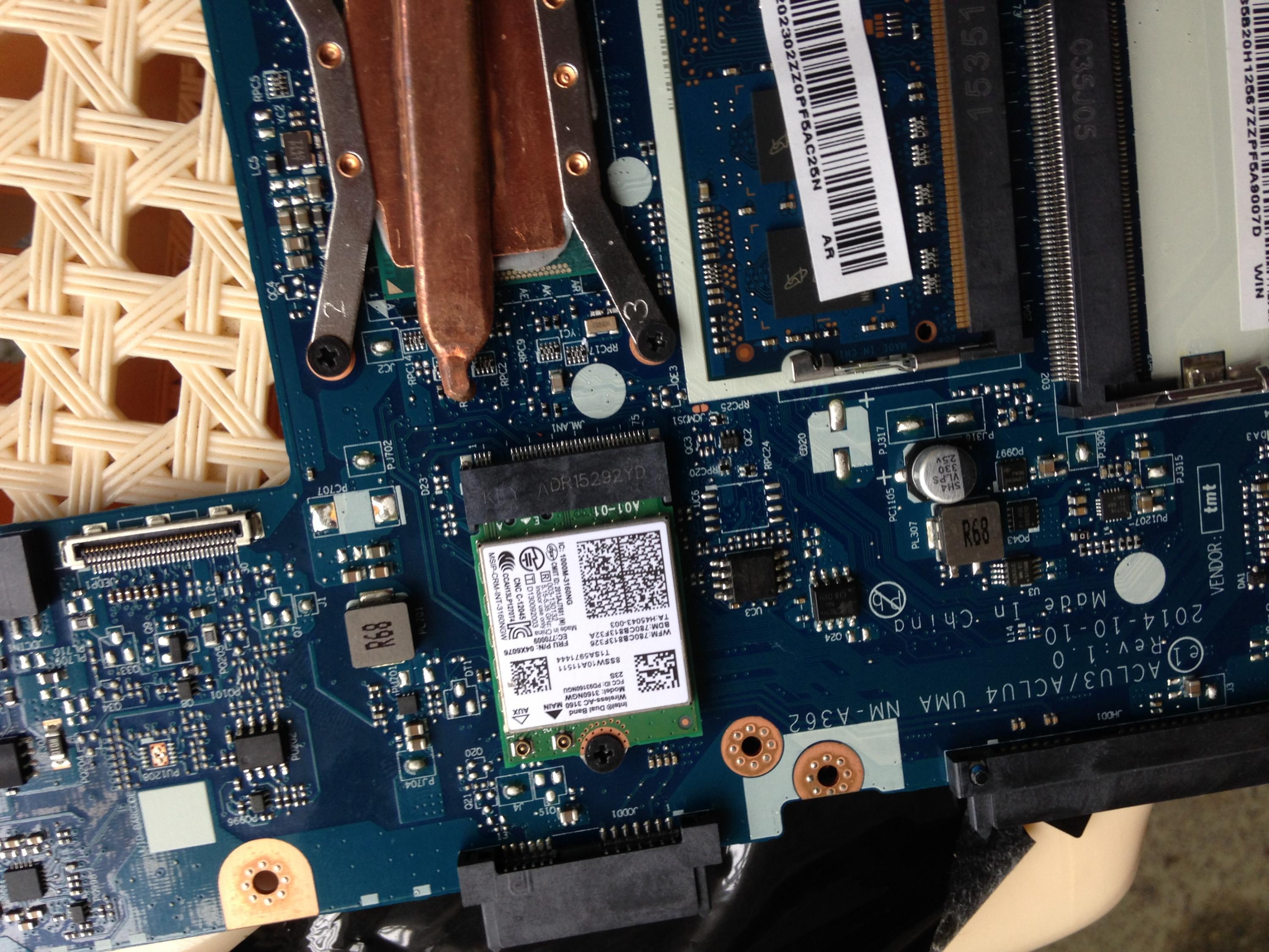

    Hi everyone I need a working bios dump file for this model Lenovo G40-80 notherboard id:ACLU3/ACLU4 UMA NM-A362 REV 1.0 thanks in advance

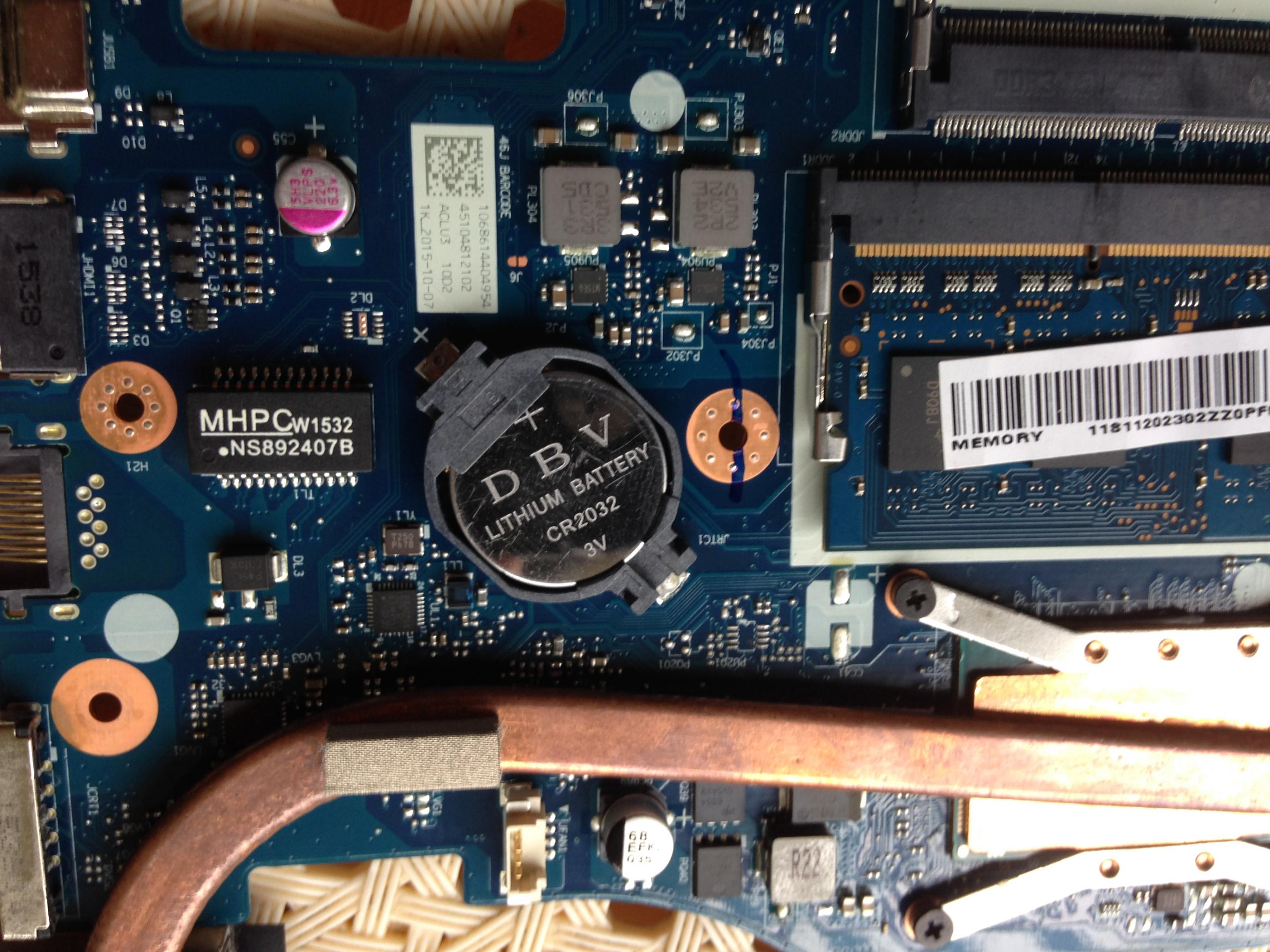

    The problem with this laptop turns on and boots fine in windows aftet i shut down cannot turn on again But if you remove cmos battery and put it back it turns in fine after shut it dwn the same issue i need to remove at put back cmos battery to turn on.please help

      Ill aready done update the bios but evertime i shutdown cannot turn on again i need to remove cmos battery to turn on the laptop.please help

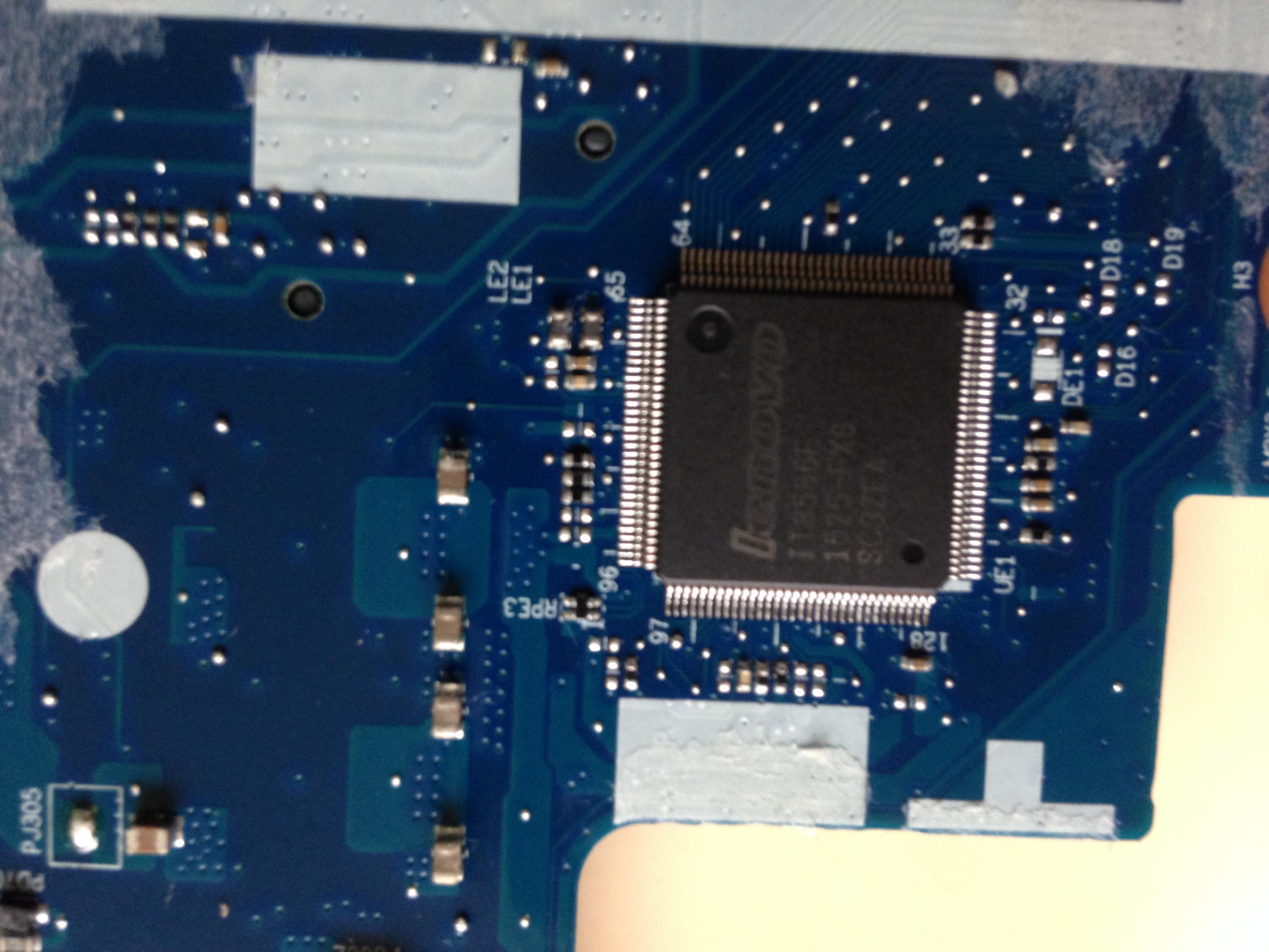

                            Romulo, try and find the switching pin on SIO. Just connect that pin from SIO to power switch. It will resolve your case. This is not a bios issue.

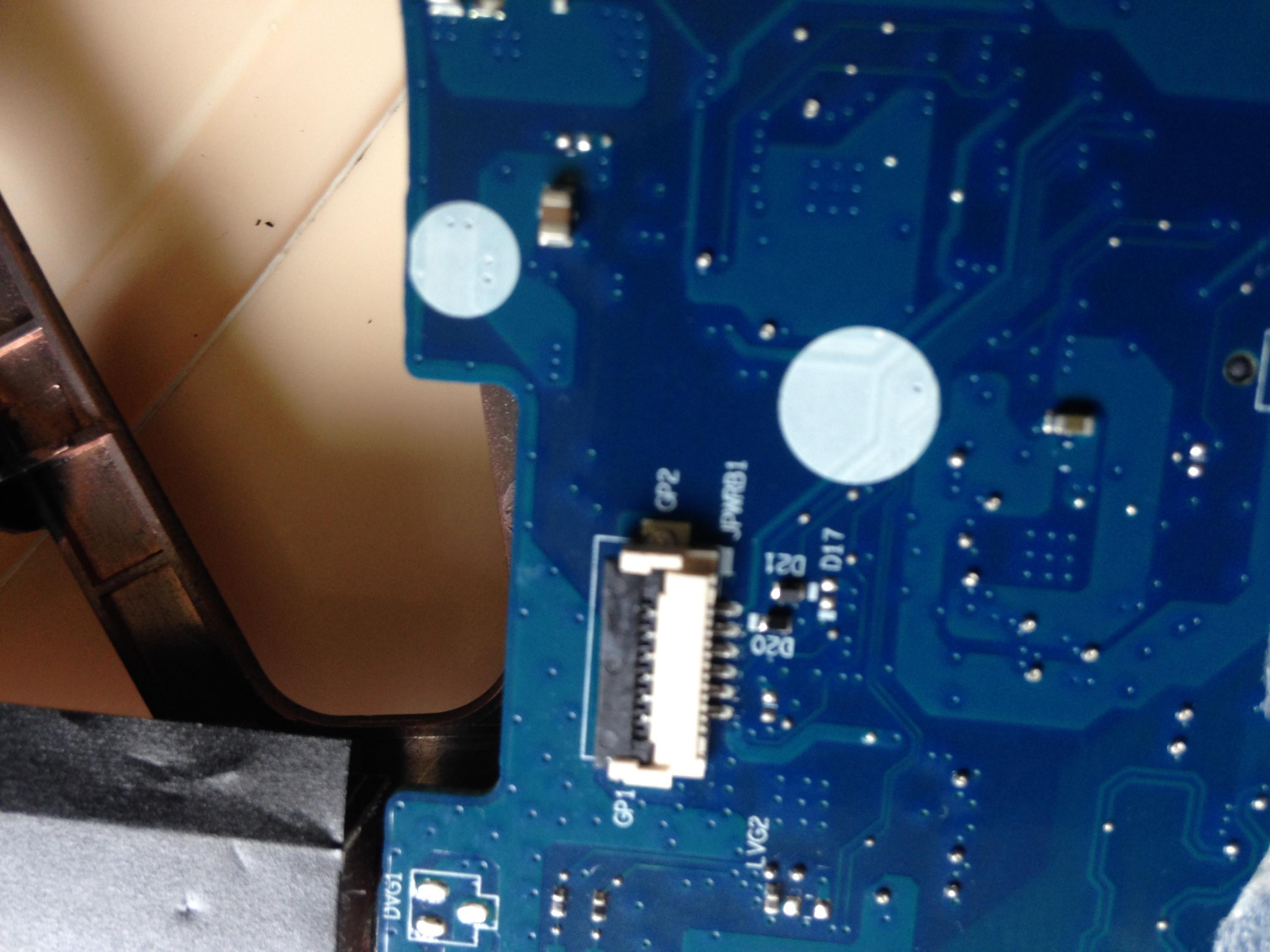

                              Agree with mcplssg123, check on power button (swicth on/off) should be 3.3V have been present. After pressing it become 0V and back to 3.3V.

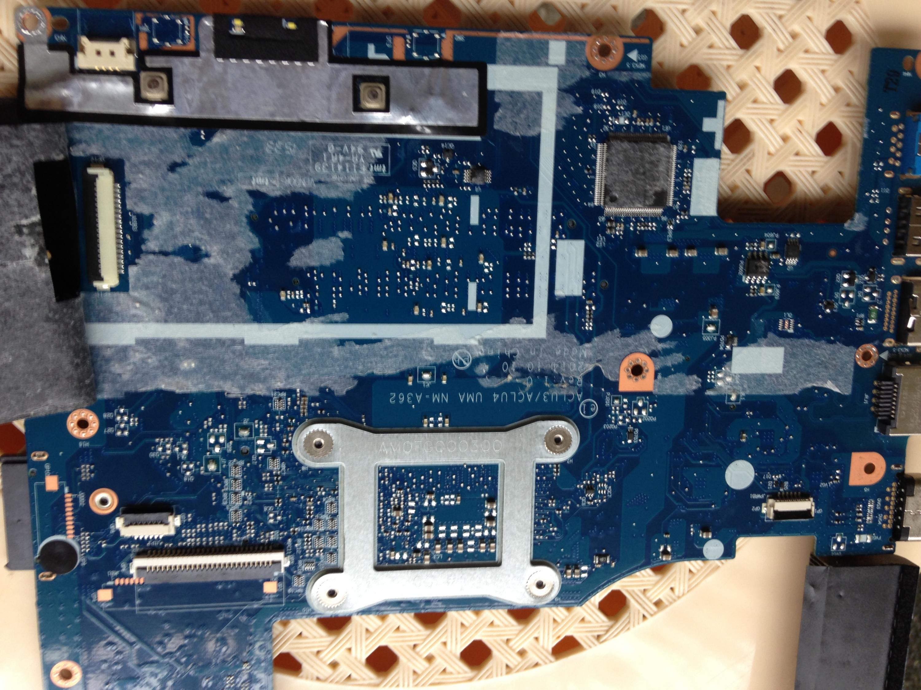

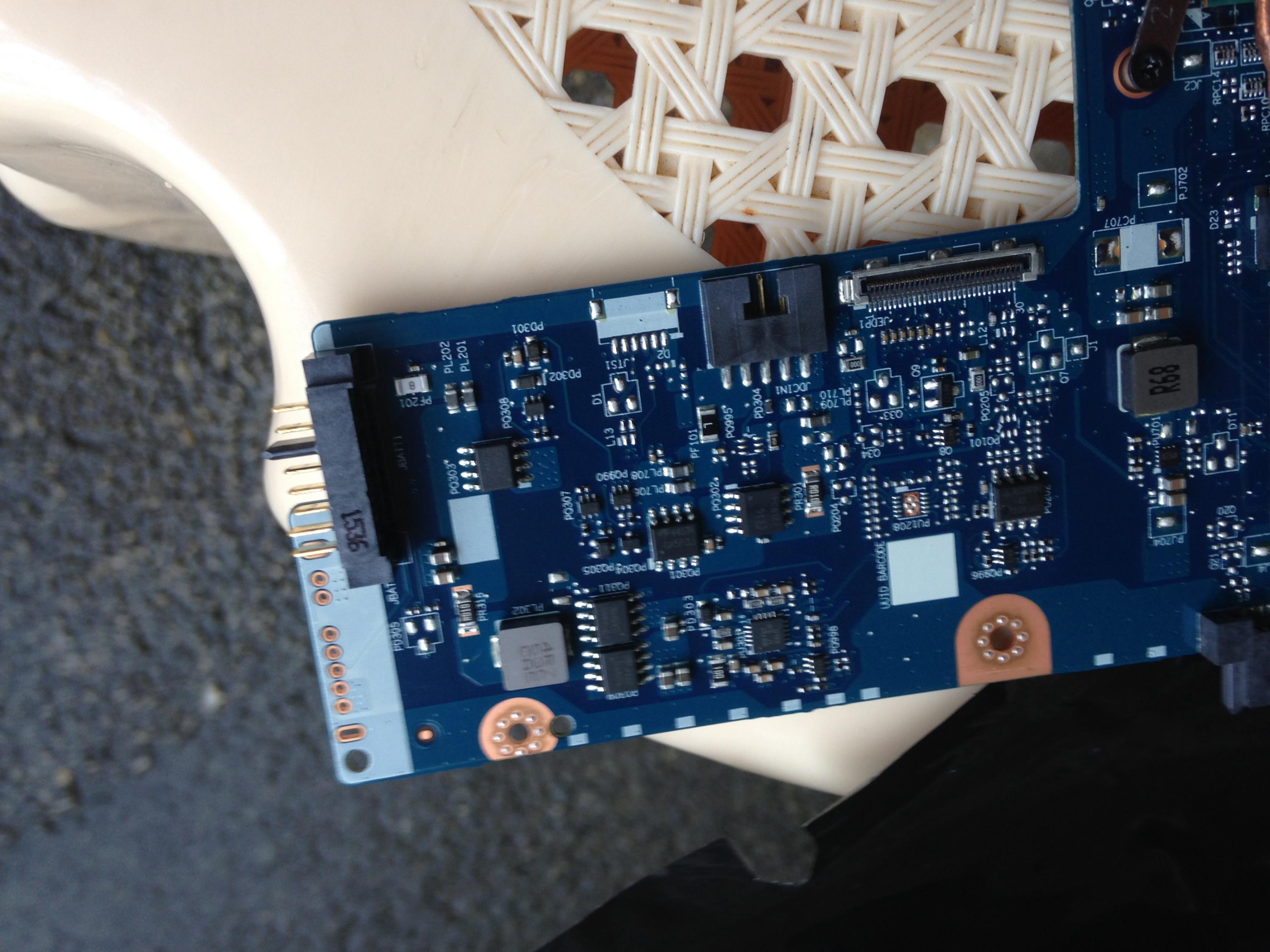

                                thanks for the response mcplslg123 could you please show me where to find and connect this switch?I have attached the full image of the board. please help me

                                        Finally solved the problem i flashed back from the original bios back up file and the find sio pin short to 3.3v power switch and test the laptop on without cmos works fine and put back cmos battery works fine and test for hours now wrking fine thanks everyone for the help
