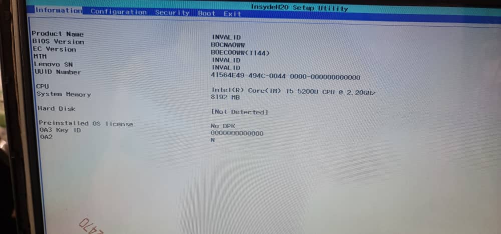

    Re: Lenovo G40-80 bios
    Originally posted by Romulo
    Finally solved the problem i flashed back from the original bios back up file and the find sio pin short to 3.3v power switch and test the laptop on without cmos works fine and put back cmos battery works fine and test for hours now wrking fine thanks everyone for the help
      Originally posted by peste
      bios extracted from Lenovo site update
      DMI 29A000 - 29C00F
      tried this file but cannot load windows even can install new windows it just stay on boot screen,,,,,,inside bios i found some thing strange....display is still late after 15 seconds
