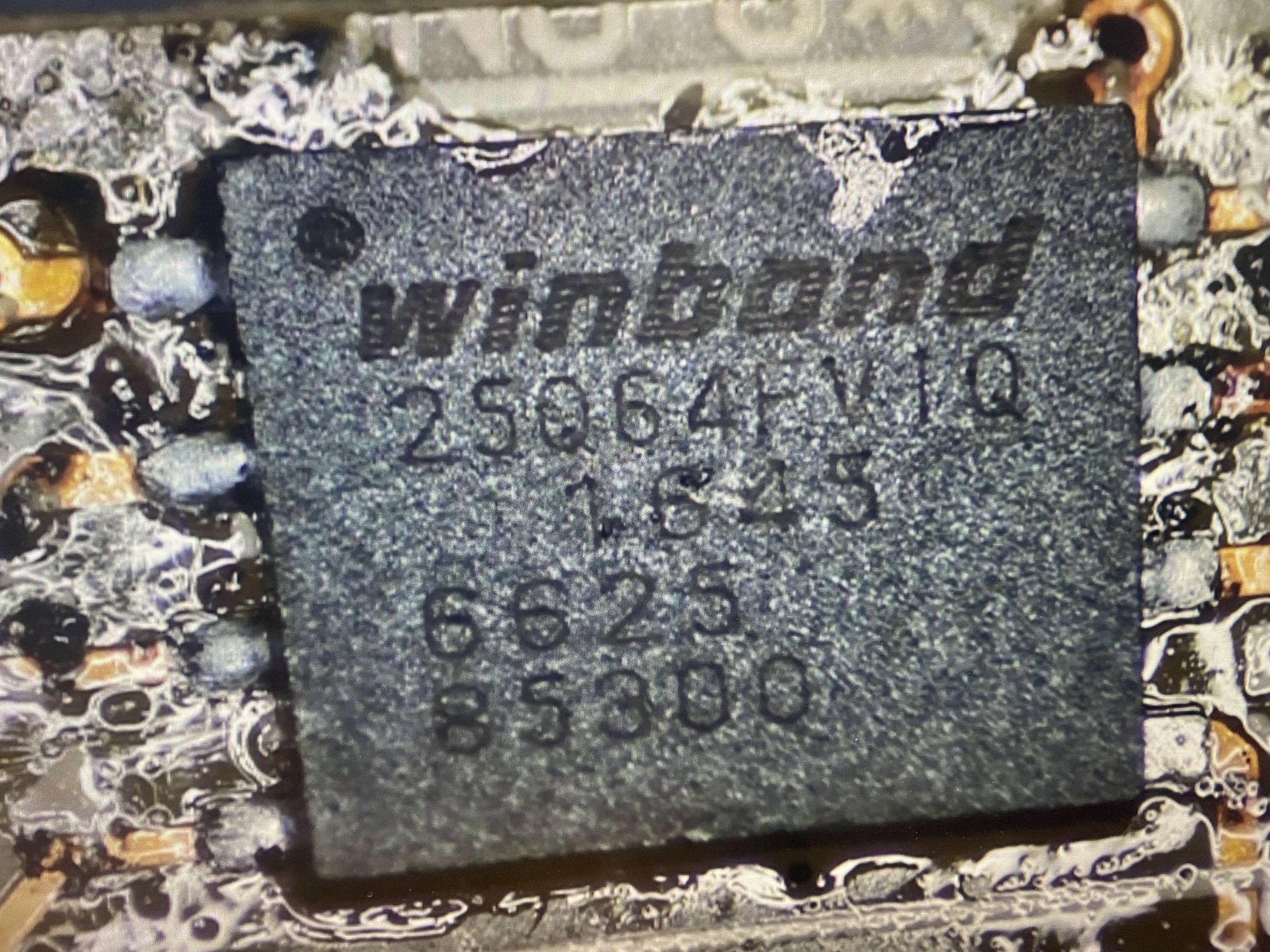

          Re: Need bios dump for Elitebook 850 G3
          Originally posted by Ferimonka
          Hi there. Please help unlock bios password.
          HP EliteBook 850 G3
          Serial number : 5CG71130MW
          I see you guys have 16GB bios, but mine is 8GB, Is it OK? There is similar chip close to bios so can it have two bios chips? Thank you for help.
          you probably still have a bios chip on the board... look for it and post the content...
          • Ferimonka
            • Nov 2019
            • 40
            • United Kingdom
            #85
            I have the same laptop as this guy on video and followed his guide. The other chip name is not Winbond but something with three big letters. Are you sure the chip on this board is 16GB? Thanks.https://www.youtube.com/watch?v=1dKgPwP3cw0
            • hoaca388
              Badcaps
              • Jan 2022
              • 12413
              #86
              Why don't you take a picture of that chip and post it here.
              • peste
                • Dec 2016
                • 13728
                • ROMANIA
                #87
                how do we know everything that is on all the motherboards?? take out the chip, read it and see... nothing is written on it..
                • Ferimonka
                  • Nov 2019
                  • 40
                  • United Kingdom
                  #88
                  Thank you for your help. I'll post a picture of the bios in to let you guys help me with this. Many thanks in advance.
                  • Ferimonka
                    • Nov 2019
                    • 40
                    • United Kingdom
                    #89
                    Here is the picture.
                    • Ferimonka
                      • Nov 2019
                      • 40
                      • United Kingdom
                      #90
                      I just realised I took the wrong chip. How easily we can be wrong.
                      • hoaca388
                        Badcaps
                        • Jan 2022
                        • 12413
                        #91
                        WINBOND 25Q64FVIQ , it has 8MB data.
                        • TAKiO
                          • Aug 2018
                          • 2
                          • Ukraine
                          #92
