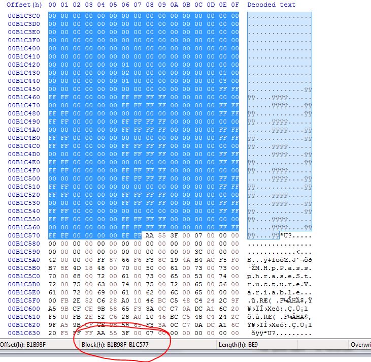

                        Can someone unlock this 850 G3 bios dump - i've tried the hp unlocker which produces an unlocked file but the power on password is still there after reflashing and refitting the chip.
                          • 20966
                          #72
                          Re: Need bios dump for Elitebook 850 G3
                          Open the bios with a hex editor, fill the area selected between the offsets in the picture with zeros.Then use the RCUnlocker
                          HxD hex editor https://mh-nexus.de/en/hxd/

                            #73
                            worked a charm thank you!
