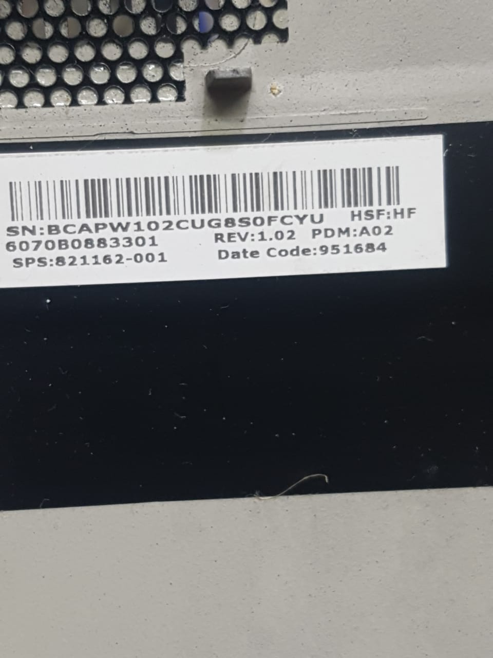

                  the soldring is ok , voltage ok , i tried the original locked bios , it doing the same thing , black screen and caps light and speening fan
                  i have saved the original bios by ezp2019+
                  first time , before programming i could start laptop

                    If the device was working before you touch the BIOS Chip, it should works fine after Programming back the Original BIOS. Otherwise you may have moved any components nearby the BIOS Chip, you choose the wrong settings when Programming the Chip or the Chip has burned.

                      I checked, there is a resistance of 33 ohom which left its place because of the hot air, I put it back, and everything works fine, so the bios is good, no more password
                      thank you very much, it's a pleasure
