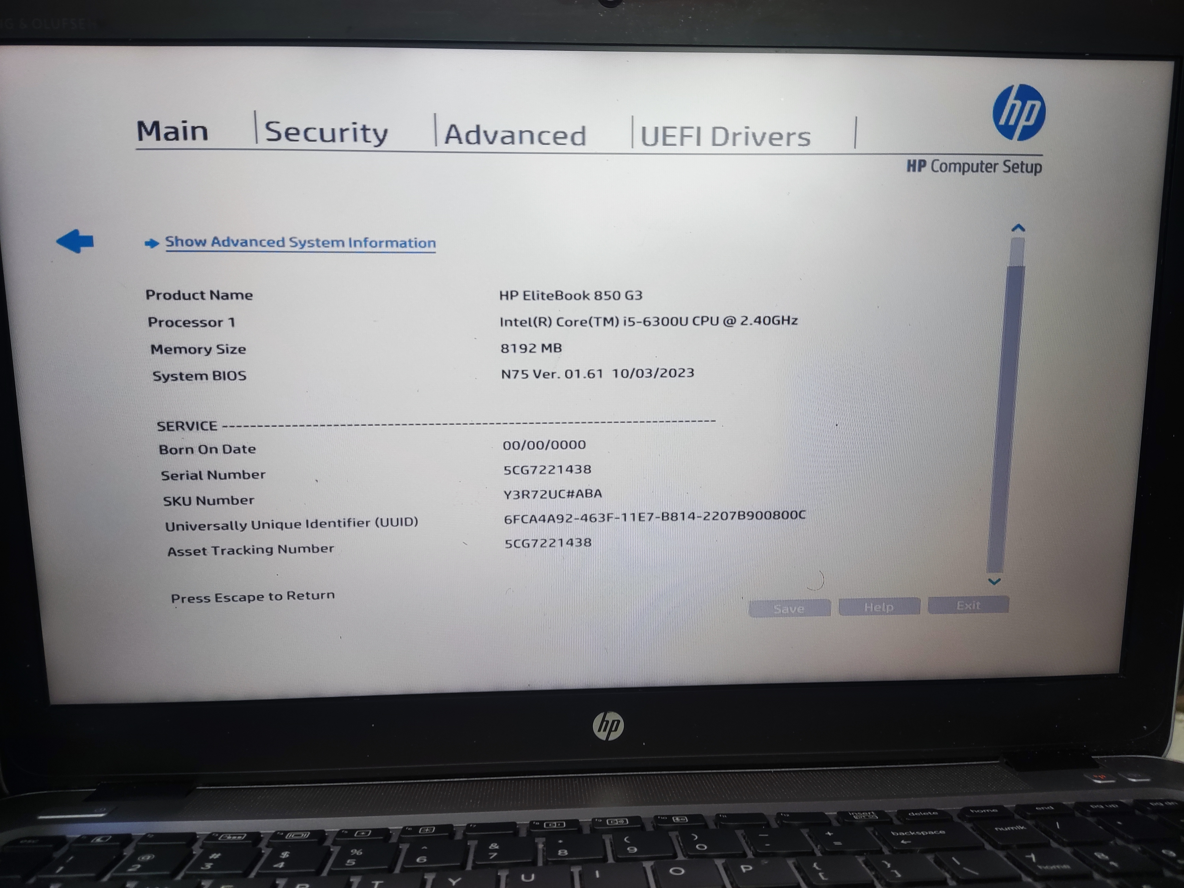

                    Originally posted by seifaldenn View Post
                    I don't know, his book is not available
                    The serial number is on the bottom of the laptop : 5CG7221438
                    Become a Badcaps supporter
                    Thanks to all supporters.
                    • seifaldenn
                      seifaldenn commented
                      Editing a comment
                      Thank you, it works and the latest version ❤️🩹

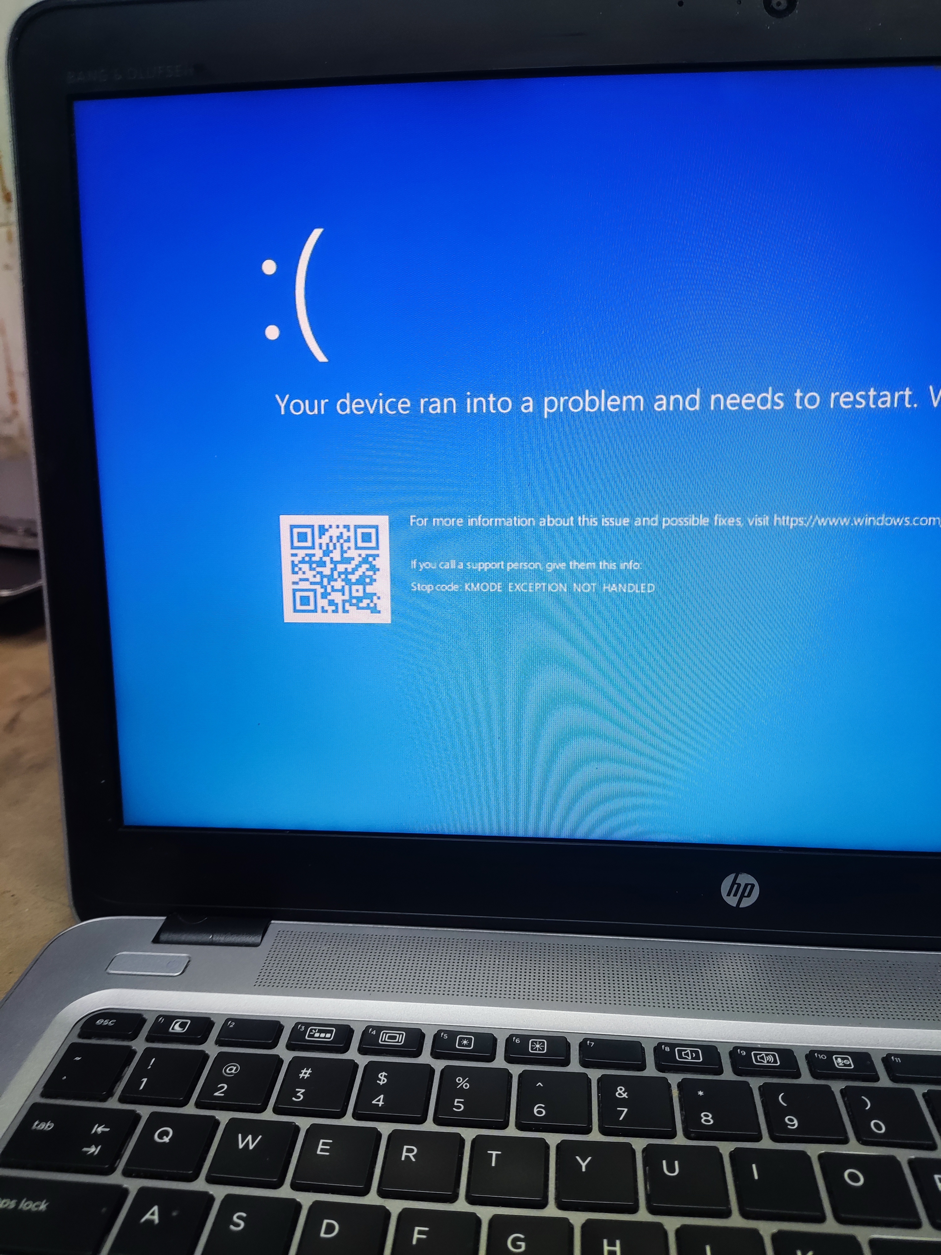

                    • seifaldenn
                      Editing a comment
                      The device freezes and restarts when entering USB to download a new version
                    With the appearance of a blue screen when entering Windows or Windows Mini USB or Restart, I changed the RAM as well.
                    • seifaldenn
                      Editing a comment
                      I connected to the Internet trying to update the Bios from Bois. It was updated to 1.60 and the same problem
