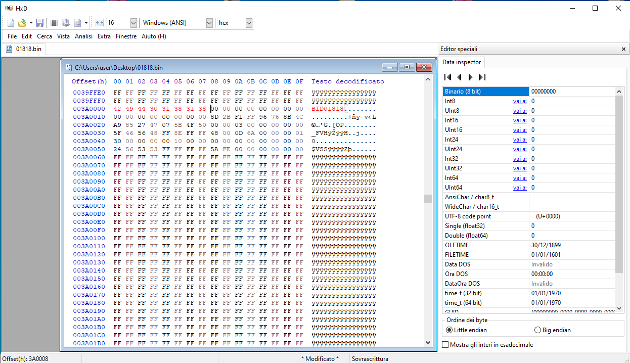

      #42
      Re: HP DV6-7005SP 48.4ST10.021 Goya Balen Bios Dump Needed
      Originally posted by poweron
      I did well?
      No.
      Read SMDFlea's post carefully one more time.
      And after that read this tutorial too, will be useful for you. Same principle.

          #44
          yes thank you, I have no experience in this regard, it will be hard to succeed
          The first picture posted with BID01818 is just showing your bios ID. Use the offsets in the second picture. In HxD close that "Editor Speciali" screen by clicking on the x ,it will only confuse you ,and closing it will give more screen space

            #45
            let's see if I understand, I have to select the block in the old and in the new bios according to the offsets you posted then I have to copy the blue area of the old in the new then I am stuck, is that right?
              • 22293
              #46
              yes, copy from old,paste-insert into new using the same offsets

                #47
                yes ok, once I have copied the old into the new one, can I save it and can I write it on the chip?
                  • 22293
                  #48
                  yes.

                        #51
                        let's see if I passed the exam .... this should be the correct bios
                        give me confirmation so I write it on the chip
                        Thank you

                          #52
                          ok, all this thanks to your precious help, but it remains for me to understand the reasoning to do to know on the basis of which criterion I choose one type of offset rather than others, would this operation be a reconstruction of the bios?
                          Different brands and models bios files are not the same, and of course the DMI information is located in different places, as well as the criteria for finding its location in the file.
                          And yes, it can be defined as a reconstruction of the bios, or more precisely adding the necessary specific information in it.

                            #53
                            Thank you
                            Great. Job well done!
