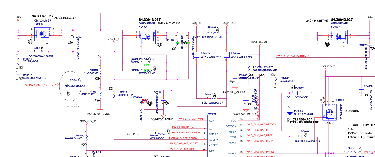

                                  hi im working with this model so BURNED first mosfet PU4006 Pchannel (replaced it) but mi mistake second mosfet is PU4004 also Pchannel on schematic but i replaced first all 2 mosfet (PU4004 and PU4006) without looking PU4004 is P or N channel. with N-channel PU4004 machine start Ok but problem is PU4006 to HOT. With PU4004 P channel i have 1v on output and machine not charge is normal with 1v.
                                  • gcomputers
                                    • Apr 2013
                                    • 509
                                    • Albania
                                    Re: HP DV6-7005SP Bios Dump Needed
                                    any idea?
                                    • mcplslg123
                                      • Jun 2015
                                      • 7262
                                      • india
                                      Voltage measurement on PU4004/4006 mosfets??
                                      • gcomputers
                                        • Apr 2013
                                        • 509
                                        • Albania
                                        with Nchannel pu4004 have 19v a D+S gate 24 so normall voltage and machinre start Ok but PU4006 warm to much
