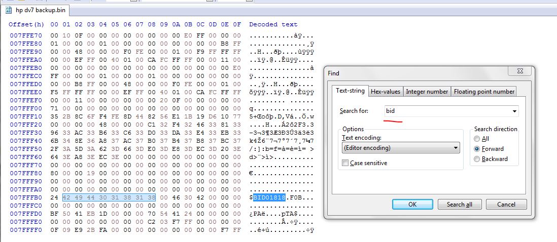

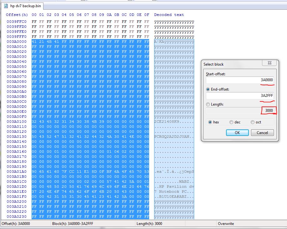

                                        #39
                                        Re: HP DV6-7005SP 48.4ST10.021 Goya Balen Bios Dump Needed
                                        this
                                          • 22279
                                          #40
                                          Originally posted by poweron
                                          this
                                          Your BID is BID01818 ,use the virgin bios from post #24 ,copy the DMI from your backup and enter it into the new bios using the offsets in the picture.
                                          HxD hex editor - https://mh-nexus.de/en/hxd/
