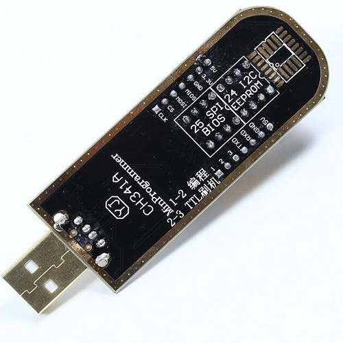

            • Mazorca
              • Jan 2017
              • 463
              Re: dell inspiron M531R-5535 bios dump needed
              I have tried the above bin files, first two from imranomi did not work, one was too small, other correct size but programmer would not open. The third one opened and I was able to program it in, however, it still asks for the power-on password.
              Yes, I did try all the passwords possible from bios-pw.org and none worked.
              I reprogrammed the laptop to its original BIOS bin:
              Is the password elsewhere? The laptop shows an AMD BGA chip next to the bios chip.

                Which kbc it uses?? If it is programmable kbc, then password may be stored there like kb9012 etc.

                  According to the schematics, it is indeed a KB9012QF-A3 LQPF128 14X14. How would I reprogram it? I have a TL866A.
                  I found this youtube video, and he says that I need an RT809F. Looks hard, but if things were easy, any fool would do them.
                  https://www.youtube.com/watch?v=SSeqlM3_LW8

                        • 21145
                        You can use a bus pirate, or a cheap ch341a programmer.
                        http://dangerousprototypes.com/docs/...ith_Bus_Pirate
                        • Mazorca
                          • Jan 2017
                          • 463
                          Thank your for the advice. I will order the ch341a programmer.
                            • 21145
                            If you prefer windows over linux you can use flashrom on windows.You`ll need the kb9012 patch as well, further down the page.
                            https://winraid.level1techs.com/t/gu...rammer/32948/3

                            • Mazorca
                              • Jan 2017
                              • 463
                              I had forgotten about this computer, customer never picked up and now I am finally trying to "fix" it. I have the ch341a programmer but I am not sure about the data input and output pins. According to the first website using a bus pirate, MISO = DO and
                              MOSI = DI. Problem is that my programmer has MOSI and MIOS. Just to make sure, is MOSI still DI and MIOS=DO?
                              I am using the windows program from the win-raid forum too.

                              • smali
                                • Sep 2014
                                • 287
                                • Pakistan
                                the password is stored kbc ....kb9012
