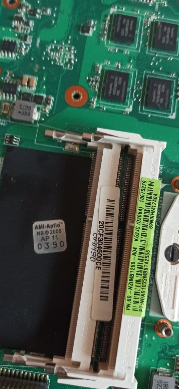

      Post a picture of the white/green barcode sticker on the ram slot .

        Here it is.
        The green sticker:
        PN:60-NZIMB1200-A04 K52JC (0206A) 10675279
        PT:N0AS1033MBB0142566 69N0IHM12A04
        The wite one:
        20CF304600CE - I suppose this is the MAC address I find it two times in the dump
        By the way the bad BIOS version that was trying to load is ver.212

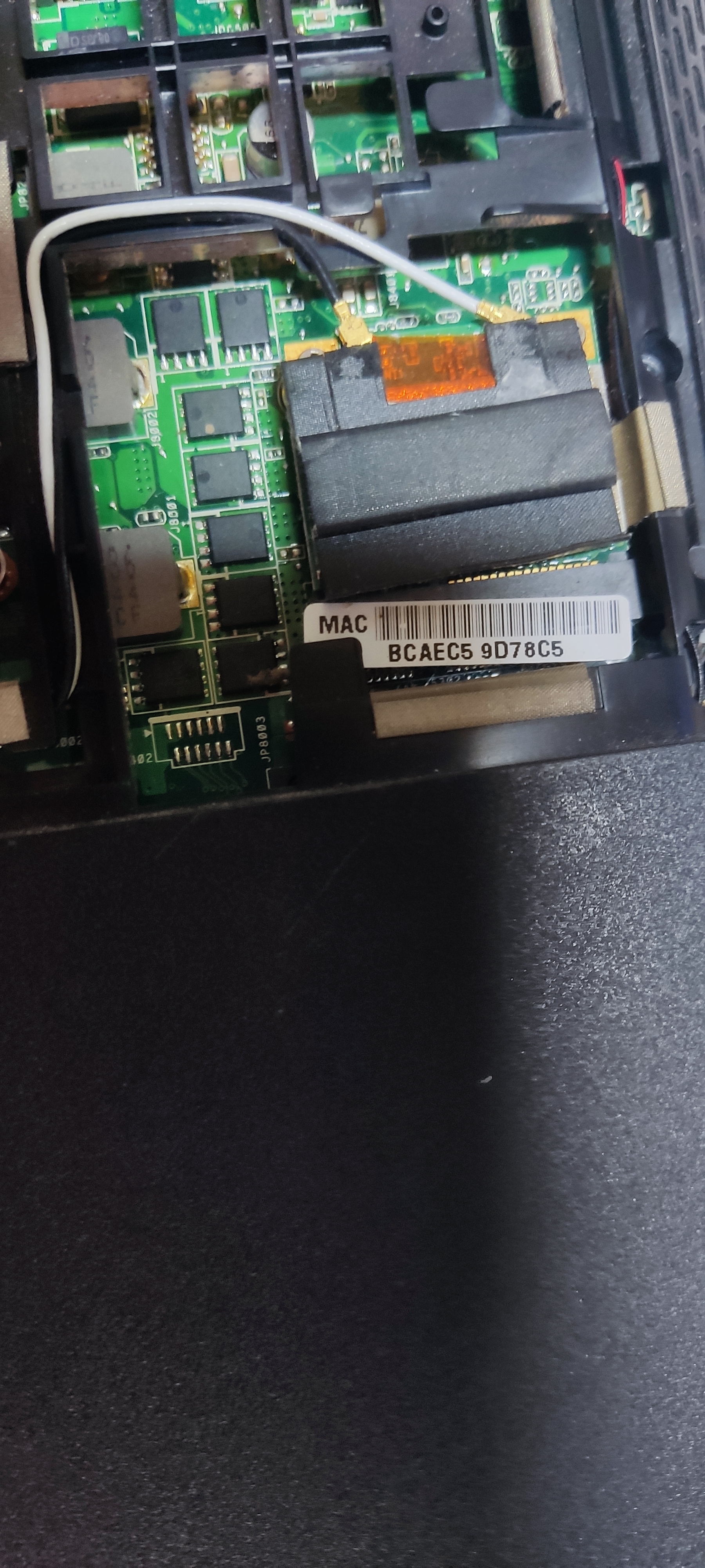

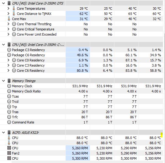

            Hello Guys,
            Thank you very much I read through the whole thread and it made a brekthrough with my Asus K52JR Rev 2.2 motherboard. When I got the machine it turn on with full fan speed and a full black screen, but after flashed the BIOS with the first shared *.ROM https://www.badcaps.net/forum/showpo...20&postcount=4
            It started working immediately.
            Despite of that, couple of issues still existing for me too. Based on Sensors all the temperatures are good, but for some reason the ACPI shows ~90Celsius which invalid, and due to that the fan is on full speed all the time. (Already tried with different Fan, issue is the same)
            Also after the BIOS flashing I think the MAC Address also modified from the original . Now Ethernet port not functioning
            If that possible, could you please help me to create a proper dump for my machine what I can try?
            I'm sharing the original dump (I dont know that was correct at all, machine wont worked with it.)
            Also sharing the barcode from the MAC if it can help.
            Thank you very much for your help in advance
            If any further info needs, please let know.
            Appreciated in advance

              Originally posted by jerro77
              Hello Guys,
              Asus K52Jr

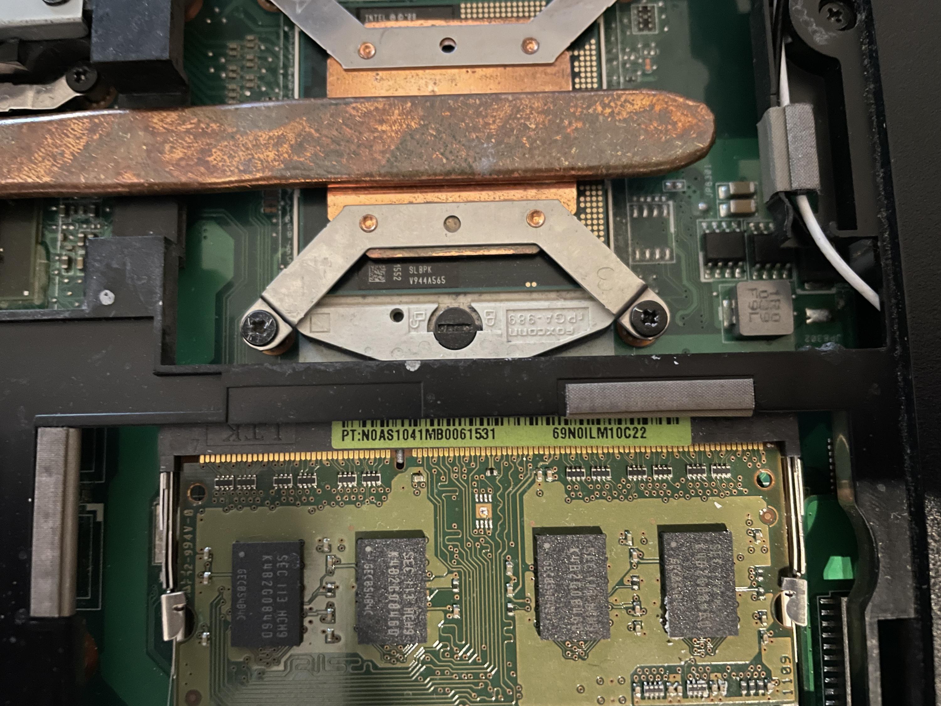

                        good morning Here I am posting everything I have unfortunately they brought me the PC like this thank you very much in advance

                          Don't post pictures unless asked....write with the keyboard..

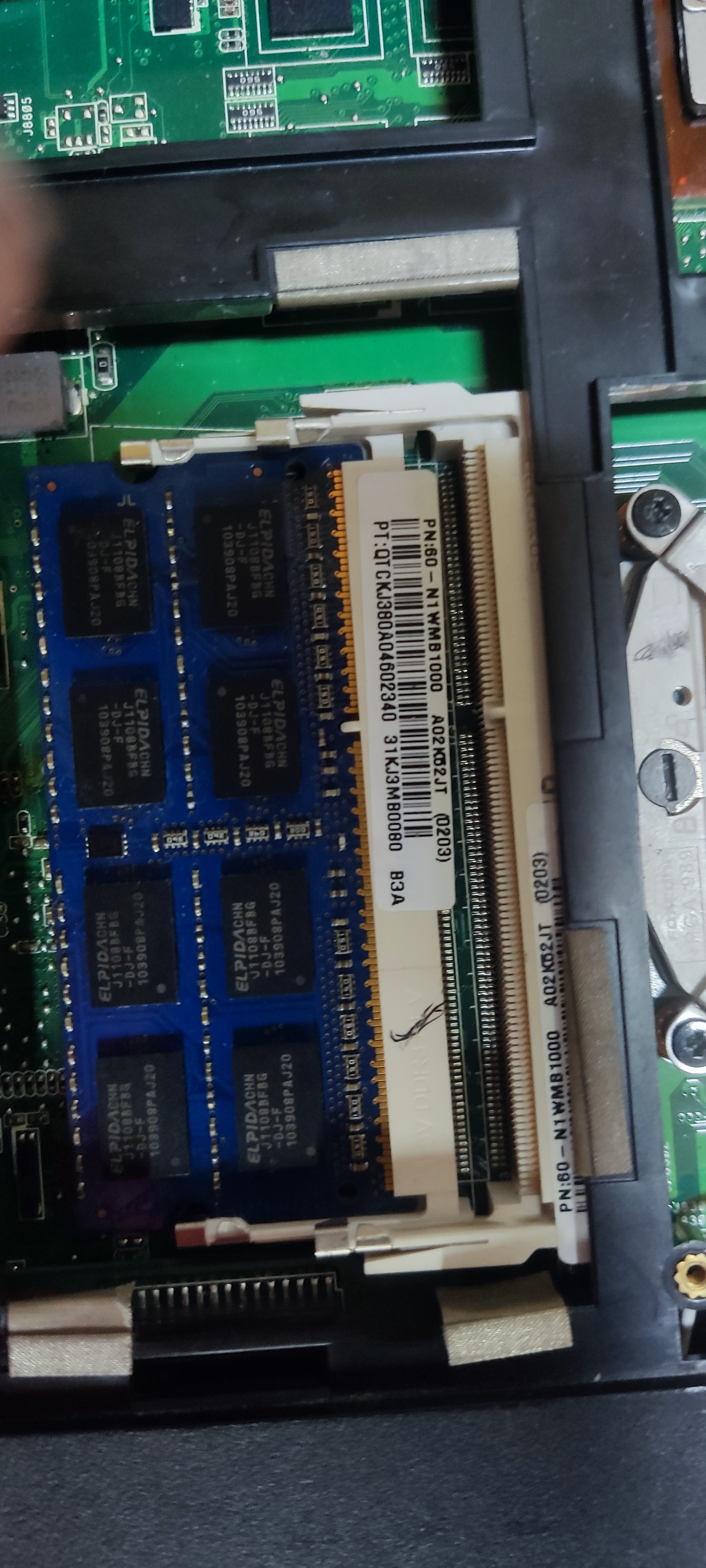

                              Post a picture of the green barcode sticker on the ram slot

                                good morning forum unfortunately on my motherboard there are no green stickers but the barcode on a white sticker now I'll post it have a good day and thank you very much in advance
