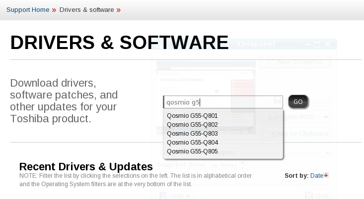

    i dont see a q50 at tosh,
    only f55-q502,503 etc.

      stj , its not q50 , its G50
        Re: qosmio g50 dumps urgent anyone ???
        all bios flashes on toshiba web support for qosmio g50 and g55 contain only bios patches, not whole bios so it can only be acquired by dumping from another working laptop

            STJ im from portugal , so you might find it on "PT toshiba support" , as ala borbe mentioned i think its a bloody patch , since i downloaded it and dont find nothing usefull there

              all g50 same bios
              http://www.toshiba.eu/innovation/dow...jsp?service=EU
              notebook -> qosmio -> qosmio G -> qosmio G50 -> --all--
              and click search
