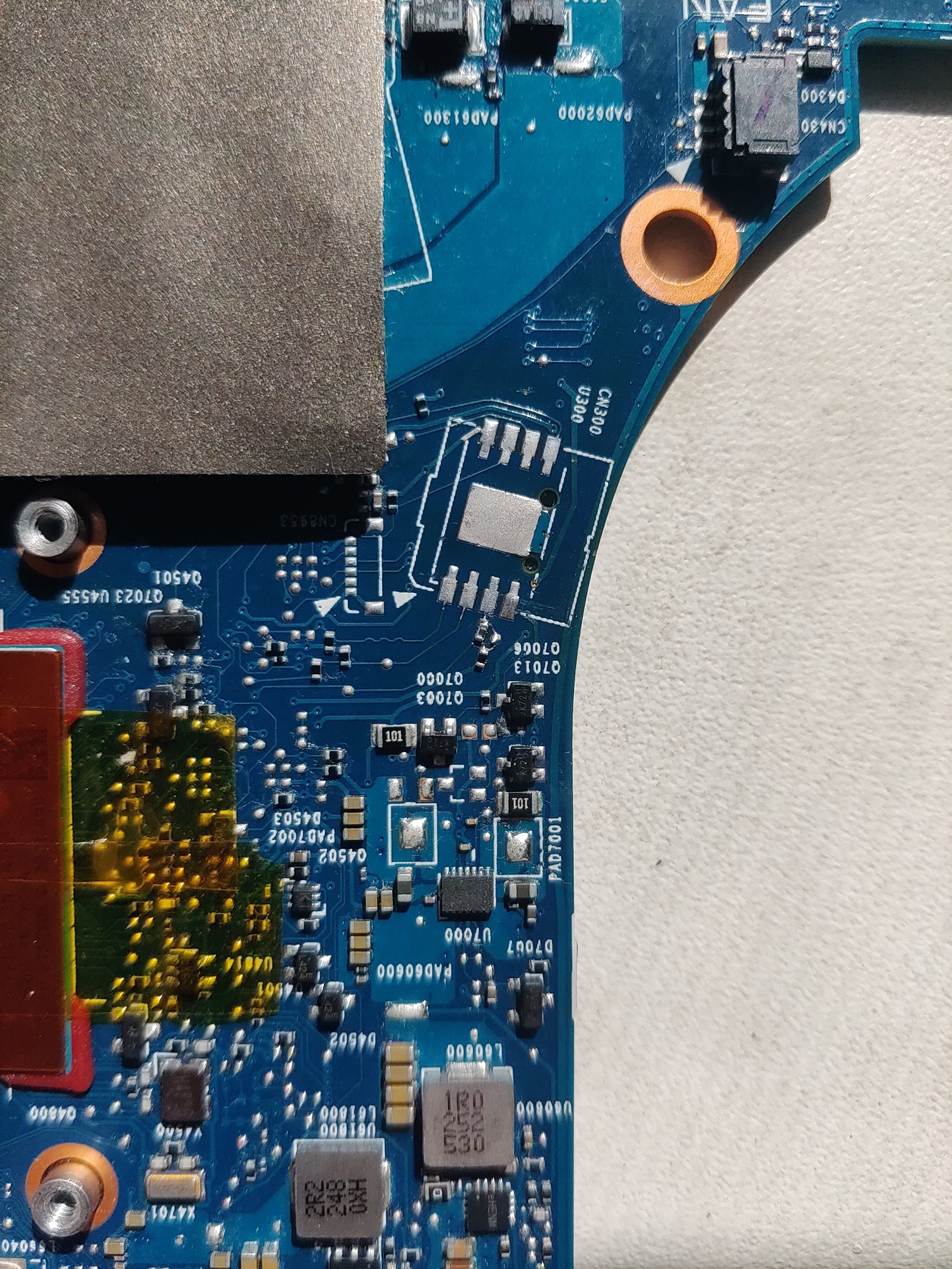

    I completely destroyed the BIOS chip while trying to remove it from the board. The package came out and the silicon cracked \[ Do chips need 400˚C heat to be removed from board nowadays?]
    I would appreciate if someone could also post a picture from the bios area, as I blew off a resistor which I'm not sure where to put back. I couldn't find the boardview for exact board model.

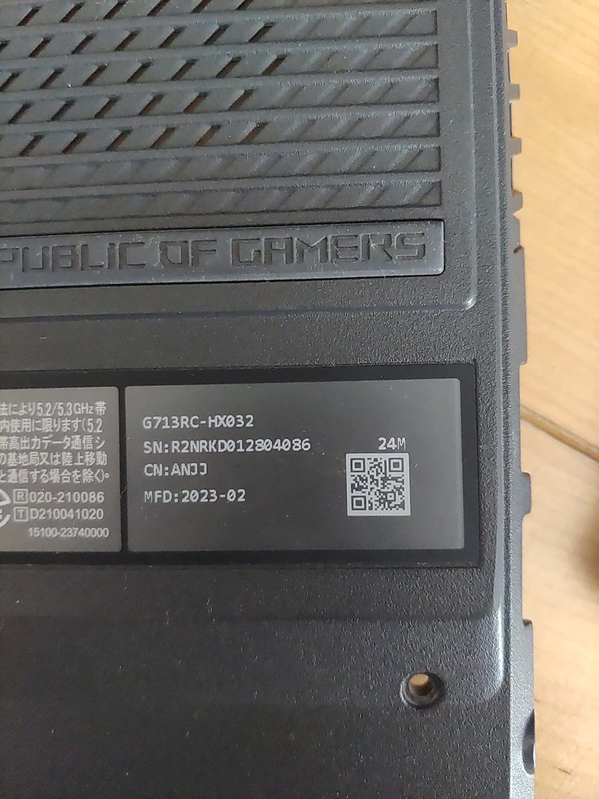

    Post a clear picture of the QR code sticker on the board, or scan it and post its content, this is for BIOS identification
    ASUS is a bit weird, sometimes laptop model in the back cover doesn't match BIOS model name, or board model number

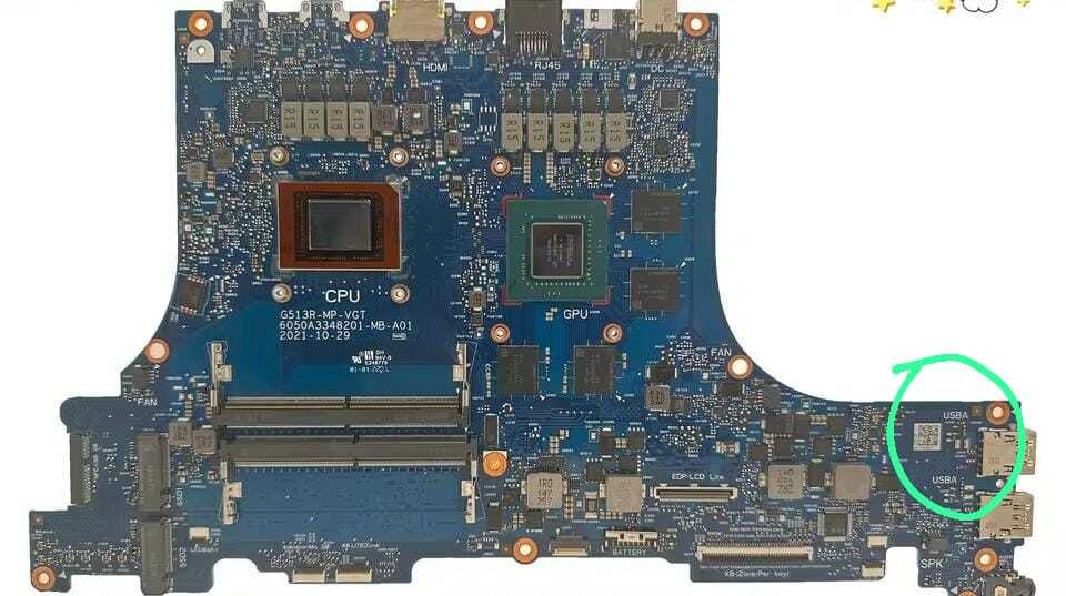

    As for resistors near the BIOS area, hope this picture helps, it's from 6050A3348206-MB-A01. from another thread (not mine)

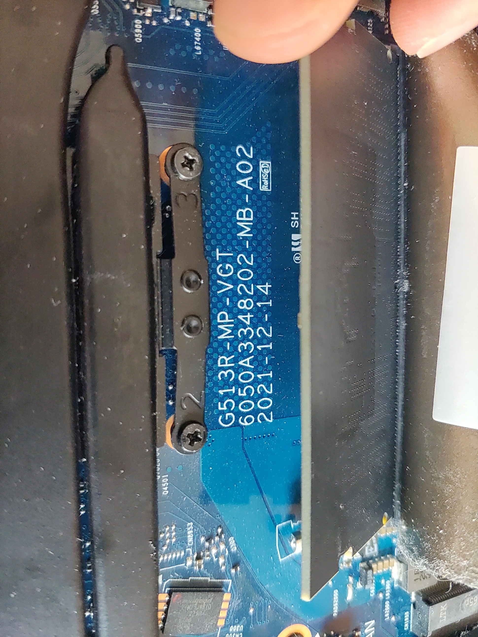

      Thanks for your reply,
      Here is the sticker also the board number attached.
      The QR links to: https://qs.asus.com/R2NRKD012804086
      The resistors I kicked out are just under the heatpipe, therefore are not visible on the picture you sent, but I appreciate the effort. I attached the current placement I have.

          I meant this one, near the USB ports on the motherboard

            Here is the content:
            B1731MC002I,R104NRKD000CFLMB,G713RC,60NR08F0-MB2210,200,C87F546556B5
            May I ask how is it useful?
            Thanks for your help.
              ROG Strix G17 (2022)_R713RC
