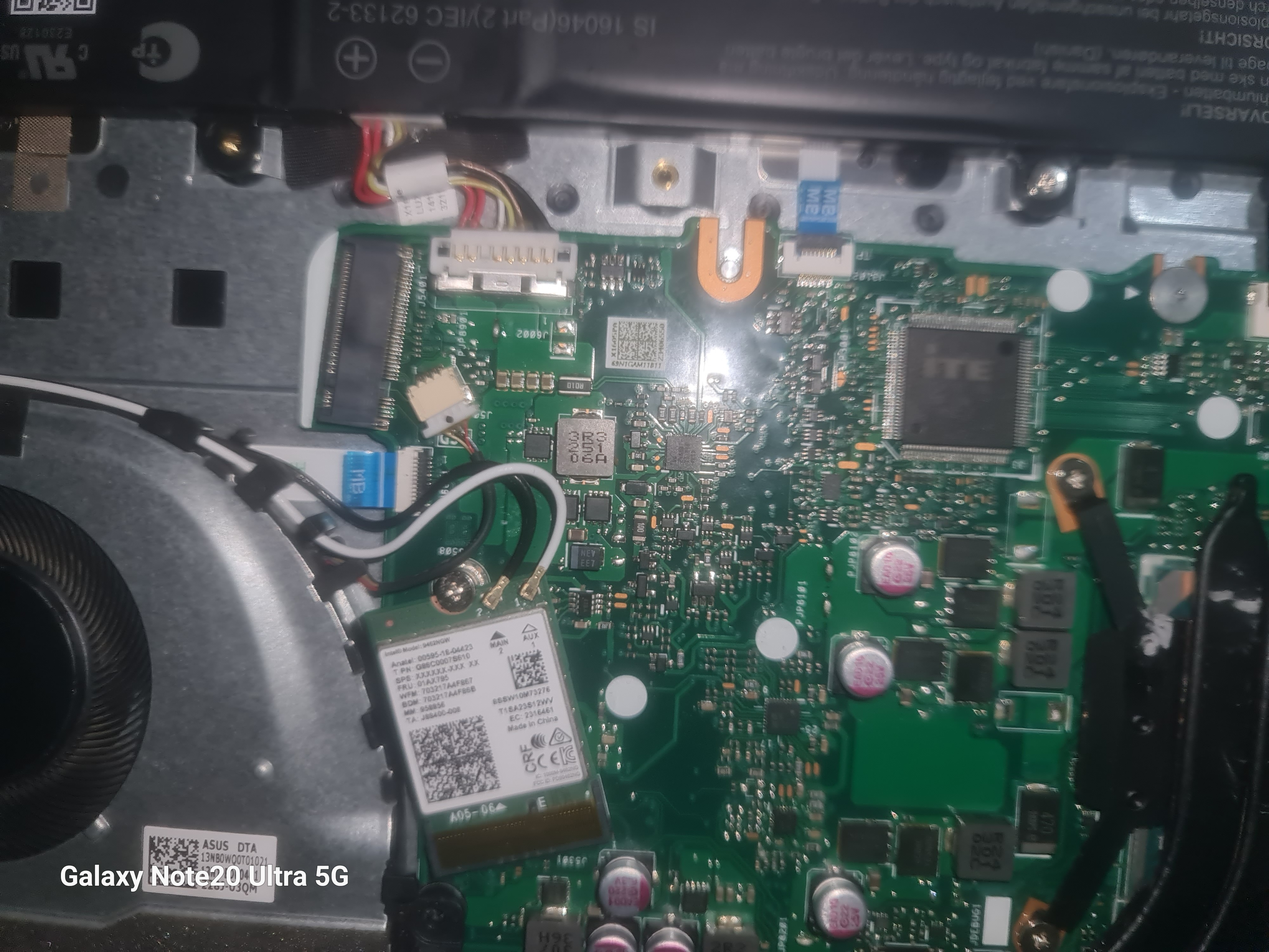

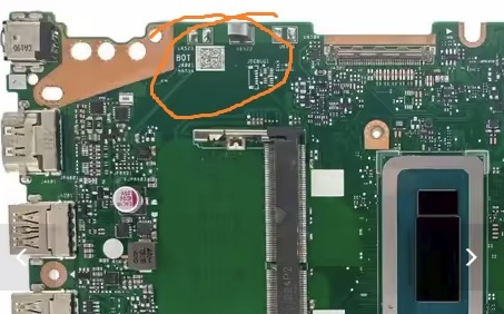

              Hi, can you find and scan the QR code on the motherboard and post what it says

                    Does the laptop power on and has display? If not, post a clear picture of the QR code sticker on the motherboard, as with the BIOS backup you provided laptop won't display anything

                      hello i have tried the best pic my camera can take i hope it helps
