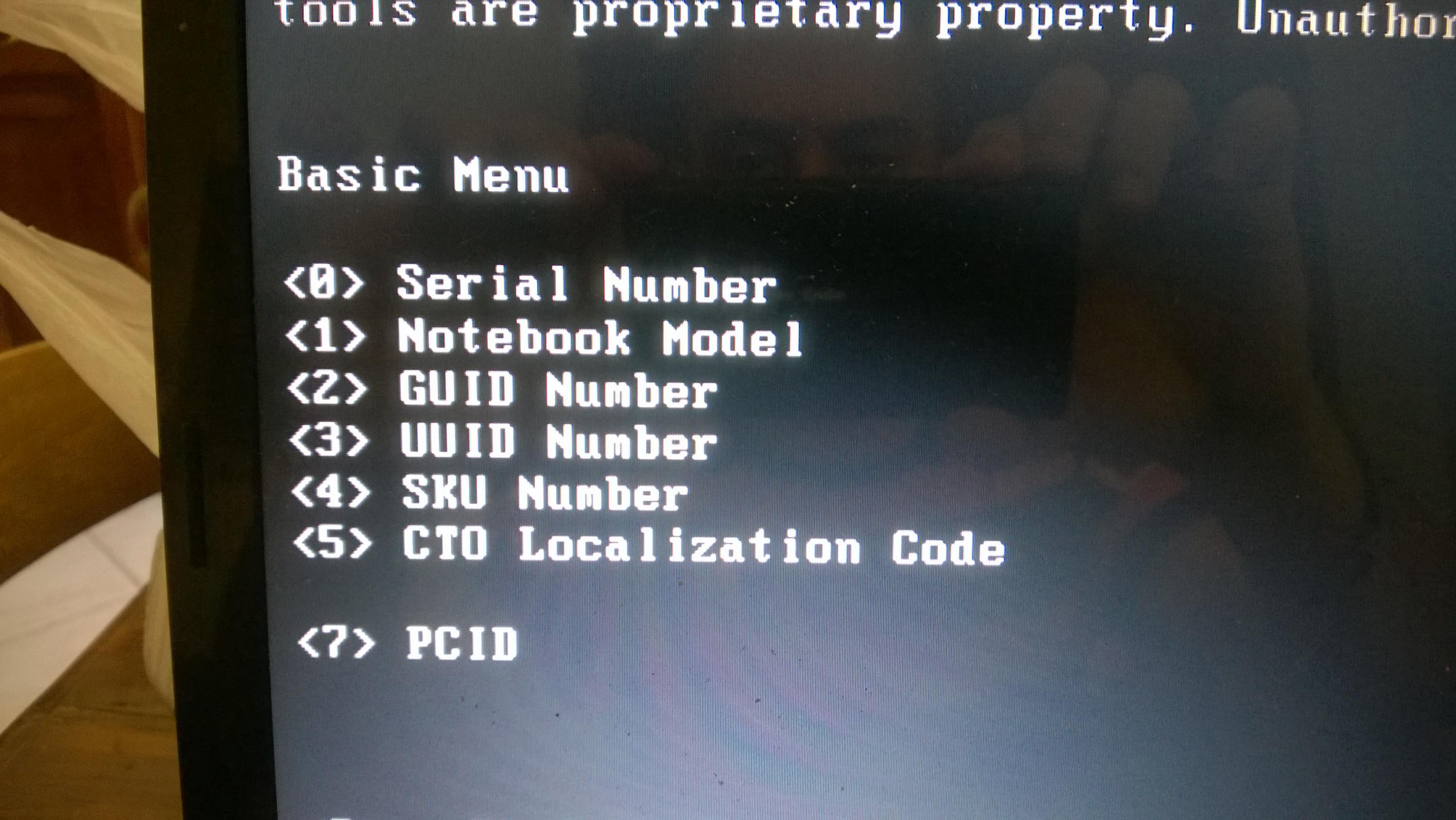

      Hi mate, You can use DMI tattoo tool to put back s/n and other details into BIOS
      Use MS DOS (it can be any bootable DOS program) copy the DMI tool file into a pen drive
      Boot the system with MS DOS - select the drive (pen drive) using command line
      eg: CD D: (or) just D: and enter
      Once inside the drive go into DMI tool folder
      Type: NBDmifit
      The software tool take u through the option where you can put the serial and other details back
      Cheers

              These, along with the hp 625s, tend to lose their BIOS when the NB craps out, so it is sometimes necessary to reprogram BIOS after reballing, before it will show video.
              The serial numbers and MAC addresses can be written then with the HP 'tattoo' utility as posted above.

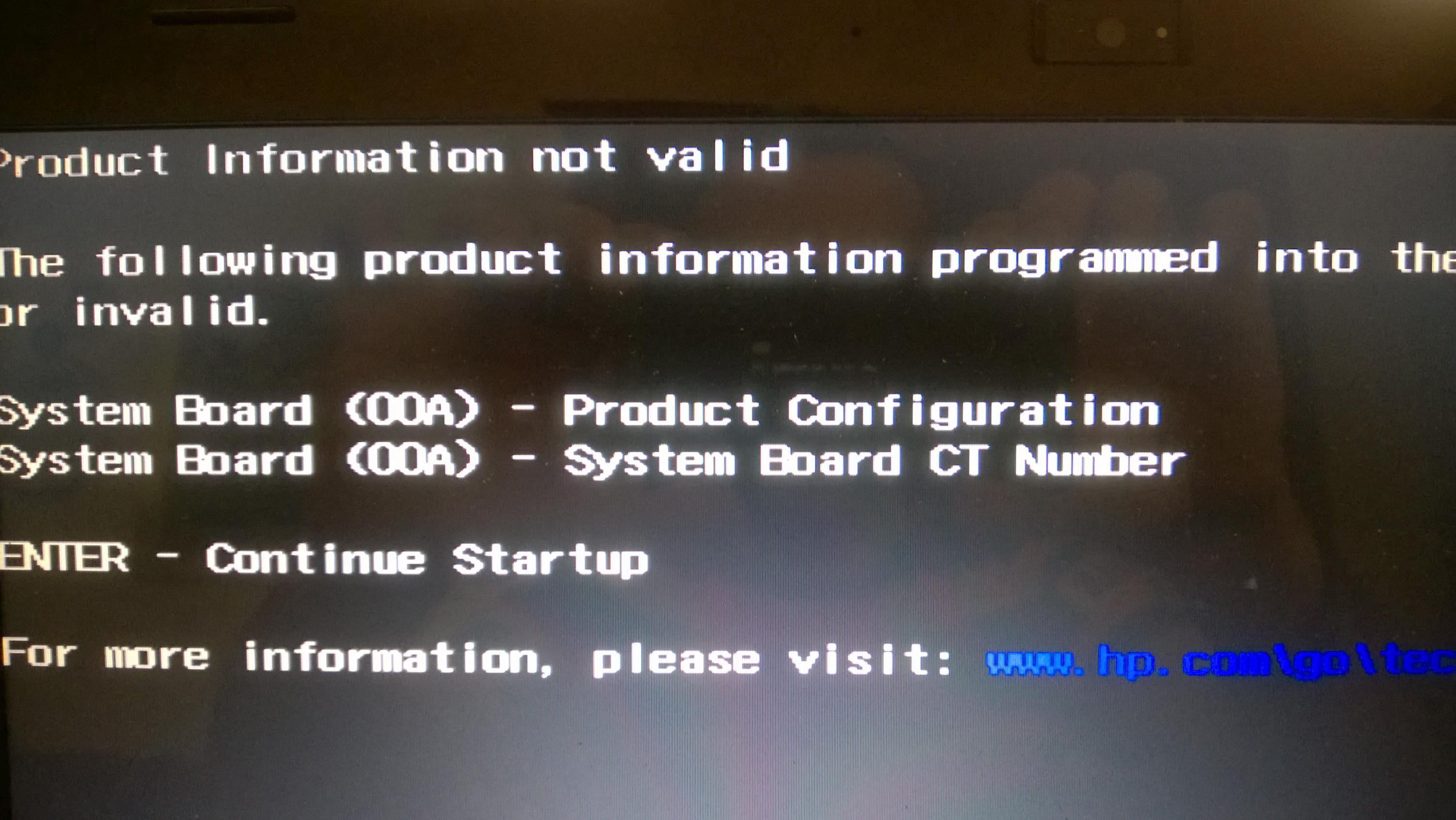

                      hi, i have fixed my g62 after video and nb reballing. ive update to latest bios too, but now i have those missing number and code.i've already put some of the numbers, but for example picd wont get correct telling me wrong data format (i have read it from bottom of notebook) and now when i power on pc , it ask for product configuration and system ct, but in the dmi utility cant find that value.
                      • dellxps15
                        • Feb 2014
                        • 1598
                        • italy
                        Re: bios hp cq61
                        fixed by putting random value (a my value ere horter then the much pace required to be filled ith thi verion:
                        edit: need new keyboard a "w" and "s" dont ork annymore....
