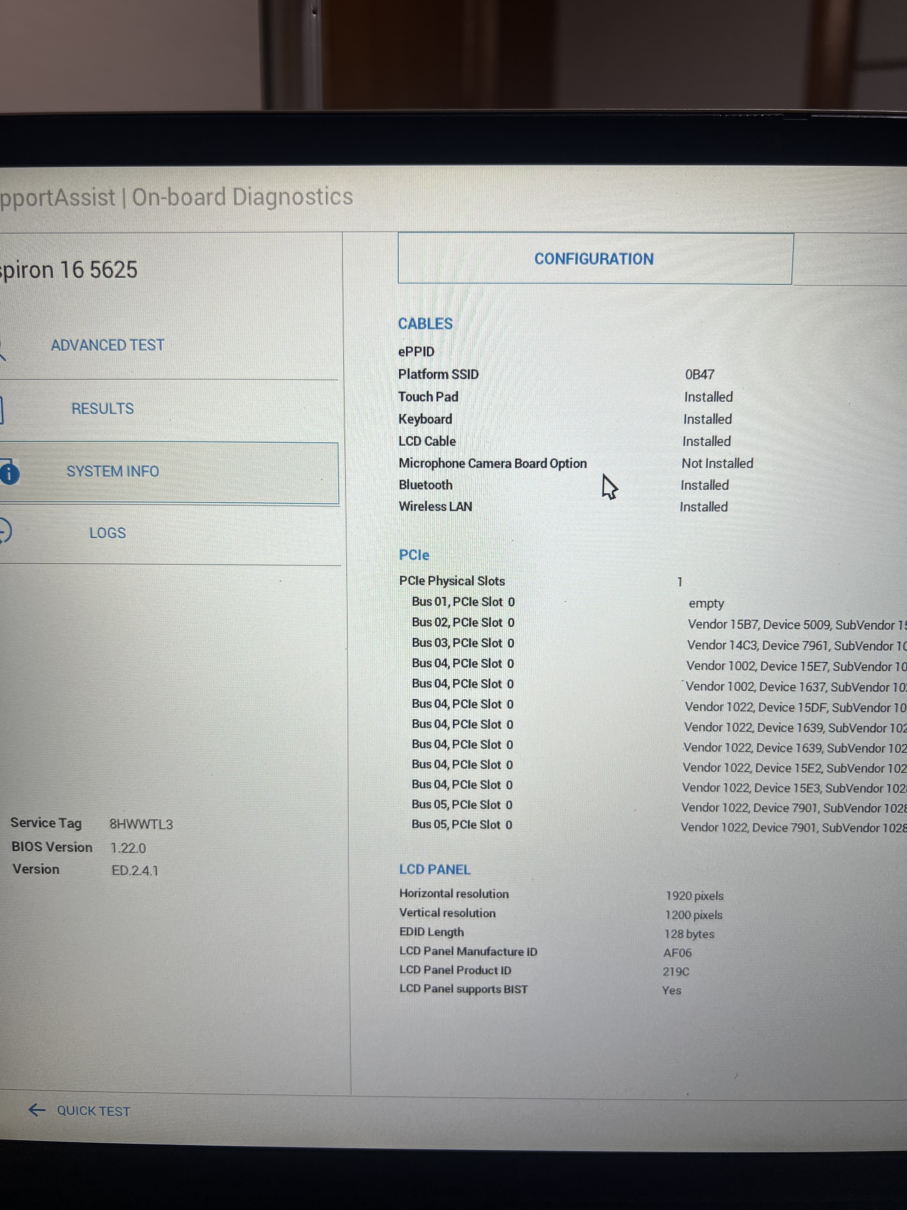

                Hello everyone! Can someone help me? My Dell Inspiron 16 5625 laptop when turned on the light is on, the fan is spinning but the screen is not on. I tried to download the Bios with Service Tag BFTHJL3, unlike my machine above, it starts but the Camera is not recognized. Can someone fix the original Bios file for me?
                ST: 8HWWTL3
                Reg Model: P117F
                Reg Type No: P117F005​
                  ST: 8HWWTL3
                  Reg Model: P117F
                  try

                    Originally posted by bbanana
                    try
                    thank you so much! i am at work now, so i will try it tonight and report back to you!
                      hi, thanks for your help, however when i finished updating, entered the correct ServiceTag but still can't find the camera, the fan spins abnormally strong. Can you help me again?
                        other version of your model, try and good luck
                          Hi, I just tried the file you just uploaded, but everything is still the same. Is it possible that I am doing it wrong?
                          • nguyenhuuducntu
                            • Apr 2025
                            • 35
                            • Japan
                            After updating the bios, do I need to do anything else?
                              no need do anything, just write your servicetag and save, press Alt+F if in manufacturing mode. that's bios from official for your model, if camera didnt show you should check connector, cabble, camera,...

                                    I removed the screen, checked the camera, the device is still original, the connection cables are clean and sturdy, it is unlikely to be a hardware error. After updating the bios, the device shows the logo and then a line appears at the top of the screen for about 1 second like manufactoring Fn + X or something and then enters Windows.
                                      This model use AMD CPU, so easier than Intel CPU (repair old BIOS)
                                      so, the BIOS from Dell Support is good with servicetag, or you can try to downgrade the BIOS version to check.
                                      sometimes hardware can issue from BIOS update…

                                        I also thought about downgrading Bios, but when I downgraded using USB, the current bios locked it and did not allow downgrading. I do not have the bin file of the previous bios version! Can you help me?
