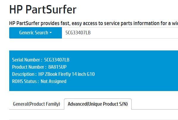

            • XFastest
              • Mar 2025
              • 4
              • Taiwan
              I NEED TO UNLOCK BIOS HP Elitebook G10 THANK'S
              SN:5CG33407LB
              ProdID:8A815UP#ABA
                • 22315
                #29
                SN:5CG33407LB
                ProdID:8A815UP#ABA
                Post moved to Firefly 14 G10 topic. It`s not an elitebook.
                • XFastest
                  • Mar 2025
                  • 4
                  • Taiwan
                  #30
                  My Bad , it's HP Zbokk Firefly 14inc G10 ~Thanks~
