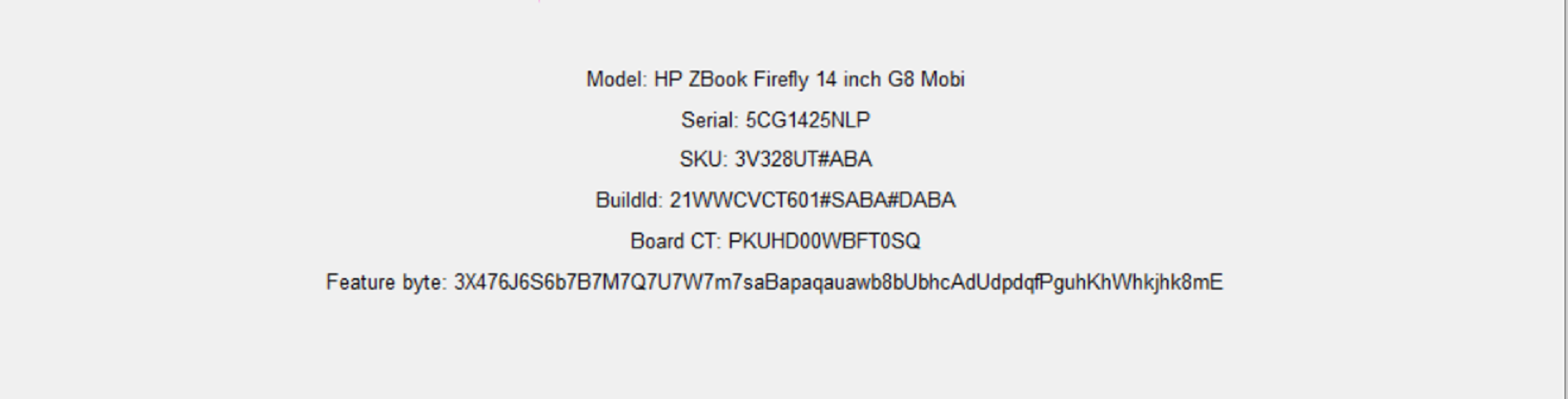

                              • black0hackers
                                • Jul 2020
                                • 369
                                Re: HP hp zbook firefly 14 g8 25Q256 (32mb)
                                Some one can remove computrace this file? thank you all!
                                SN : 5CG1425NLP
                                    Your feature byte missing some digits at the end.
                                    Originally posted by Vesko356
                                    all donations are welcome,
                                    • Vesko356
                                      VIP Moderator
                                      • Aug 2018
                                      • 4386
                                      • Bulgaria 🇧🇬
                                      They are not missing - it's just the row of symbols is so long that it doesn't fit in the place.
