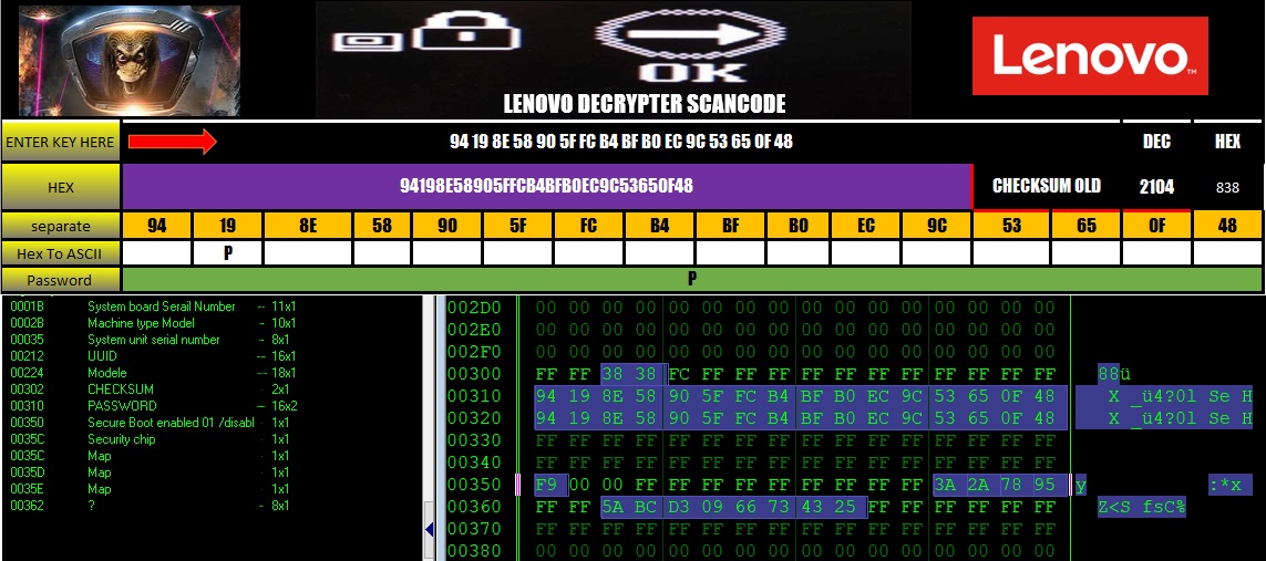

                    posibility to recover the Password in RF08 on T420
                    hello ,
                    is there a possibility to recover the Password in the chip RF08 on T420. I have a batch of 100 Pc, if I could find a solution to find the password.
                    • RethoricalCheese
                      • Mar 2013
                      • 1519
                      • Estonia
                      Re: posibility to recover the Password in RF08 on T420
                      Arduino, thinkpadeepromreader.ino and IBMpass. I have done it before but I forgot what model it was. Last 3 times I tried, it did not work for some reason.
                      T420 has that eeprom on bottom side sadly. Takes a bit more time to use the shorting method.
                        I have the dump but failed to decode
                              Originally posted by smiley60
                              Hi bro
                              did u find the way of password recovery in lenovo t420?
                              not find solution for that, password is crypted
                                  so reflash the bios or ec chip
