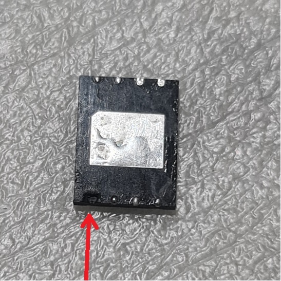

          #84
          Any solution to this fellas?
          It's a 25LR512MEYIG and that's the Vcc Pin I guess
          I just wanna be able to read the chip to post here along with ST and the other info
          • ymifdal
            • Jan 2022
            • 120
            • Morocco
            #85
            I guess I'ma just try to decap the chip tomorrow and look for the internal VCC pad lol
            I’ve done this before on other damaged chips that come damaged but never did a WSON8
            • vidvansh
              • Mar 2025
              • 27
              #86
              I has the same issue with the same chip. i think they purposely build it this way so no one can work on it.
              I has to buy new chip to make it work
              • ymifdal
                • Jan 2022
                • 120
                • Morocco
                #87
                Yes they're making it kinda hard to remove by placing the ic in some tough places
                I did order another IC too I'll just try to build a new bios by then since I can no longer read the old chip
