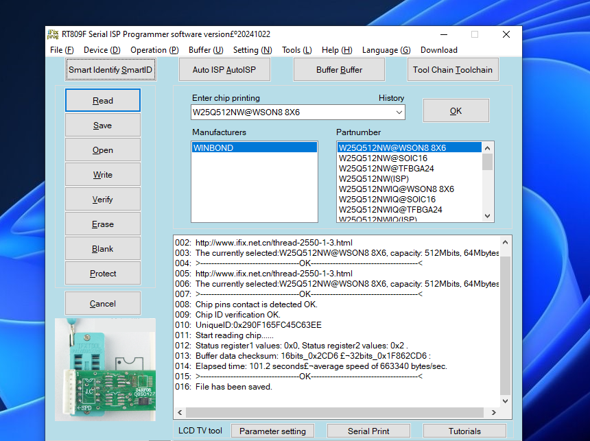

          "gigadevice 25LR512MEY, i use RT809F it can't device, so i dvice by 25Q512jv".I think this is the reason why it does not work.
          • azanwaqas771
            • Feb 2019
            • 50
            • Pakistan
            because his orignal ic is 1.8 and you use 25Q512 is 3.3v
            • black0hackers
              • Jul 2020
              • 370
              5450 bios W25R512NW. i use W25Q512JV@WSON8 8X6 to read with 3.2v, it working

                      i try this one and it worked, ic 1.8v and need to upgrade RT809 lastes version to identy
                      LA-N381P
                      ST: JFBLFW3
                      DELL PRE 3490

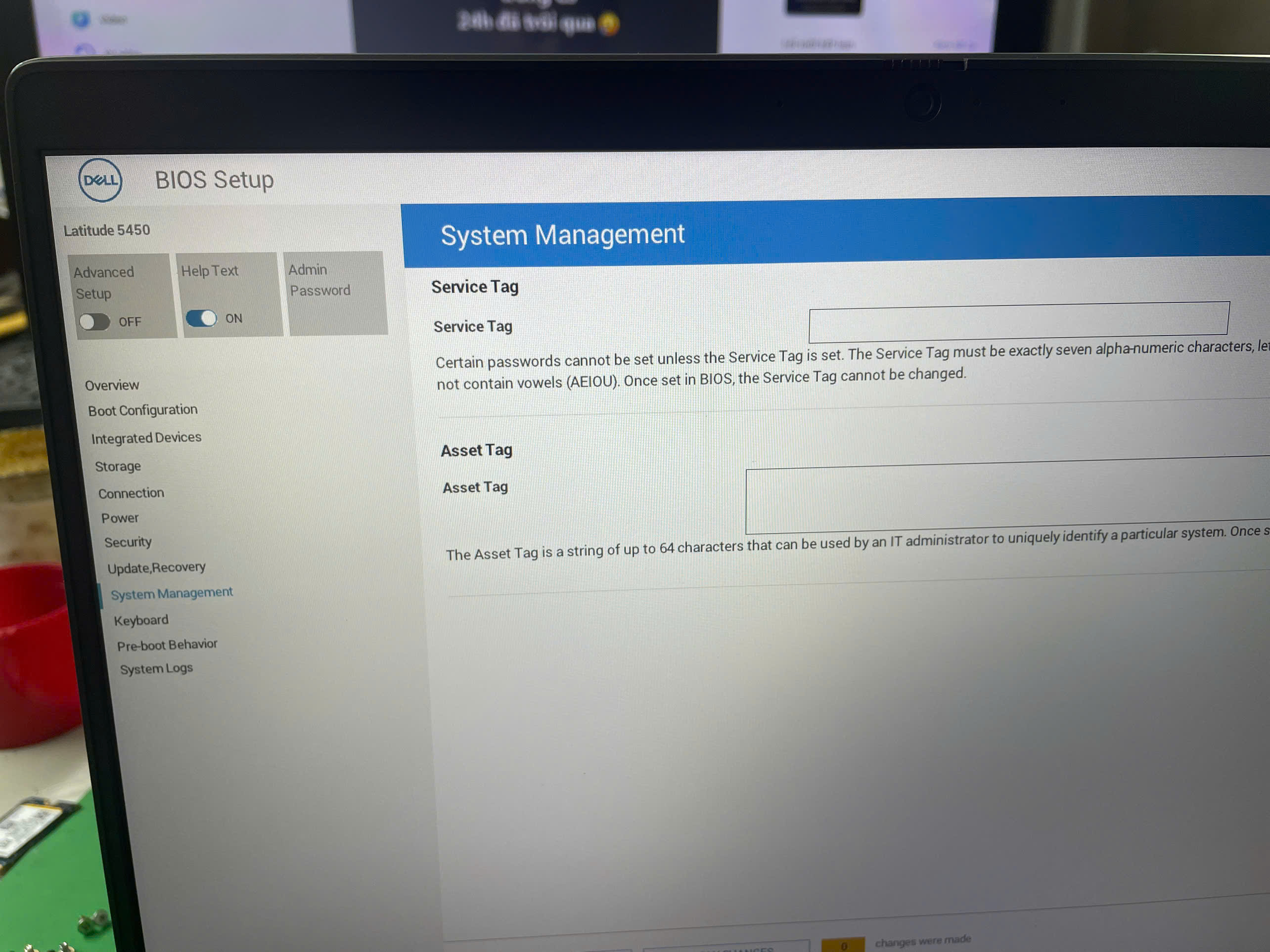

                          Hello I’m trying to see if someone can help with a modify bios for My dell latitude 5450 Business laptop
                          I pick it up at a Erecycle place
                          But it has Absolute enabled
                          But there is no bios passwords set at all
                          I currently have it on Linux
                          But I really want Win11 on it
                          If Install windows it work fine tell drivers update and then boom locks out
                          Please help

                            YOU MUST provide your old dump​

                              Hello, did you use which tool to read this chip? The RT809F already has this chip on the list, I made 6 files of the file and nehum are the same.
