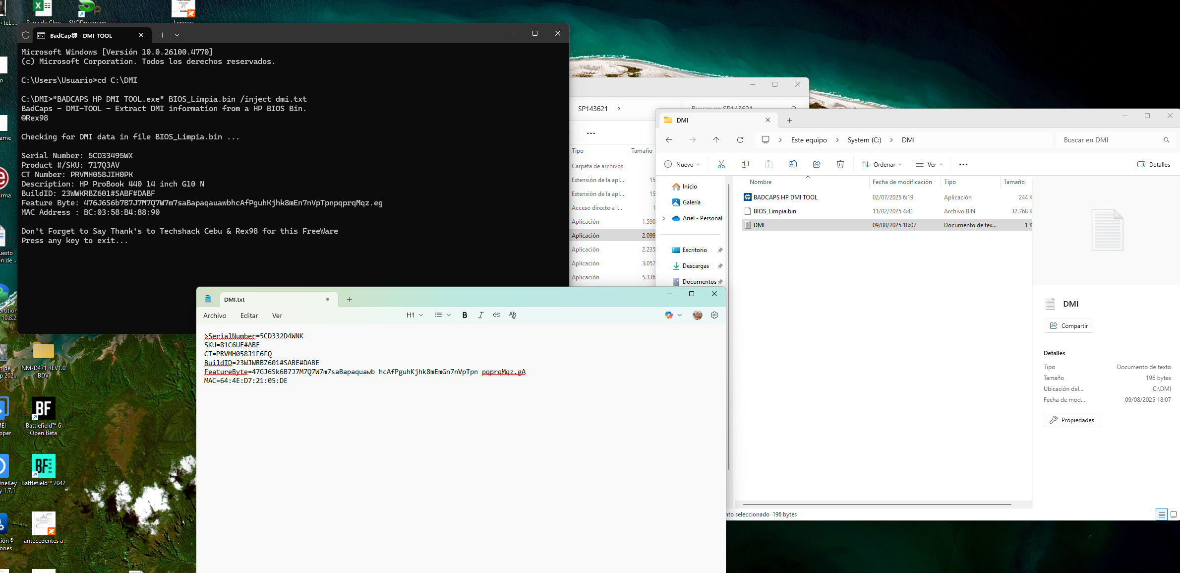

                      Can you help me? I'm not able to inject the extracted DMI into the clean BIOS.
                      • volinakis
                        • Jan 2021
                        • 2871
                        • N/A
                        #92
                        "Fill in your DMI with HP Bios Config Utility" - install BCU, use cmd as admin, cd (change directory) where BCU was installed and use cmd line " biosconfigutility /get:1.txt
                        Open 1.txt and fill empty fields with extracted DMI, save file as 2.txt (in Docs, then move it in BCU folder) then use cmd line " biosconfigutility /set:2.txt
                        • Ariel Arrizabalaga
                          tech
                          • May 2024
                          • 16
                          • España
                          #93
                          Thanks, I've solved everything and it's working perfectly.
