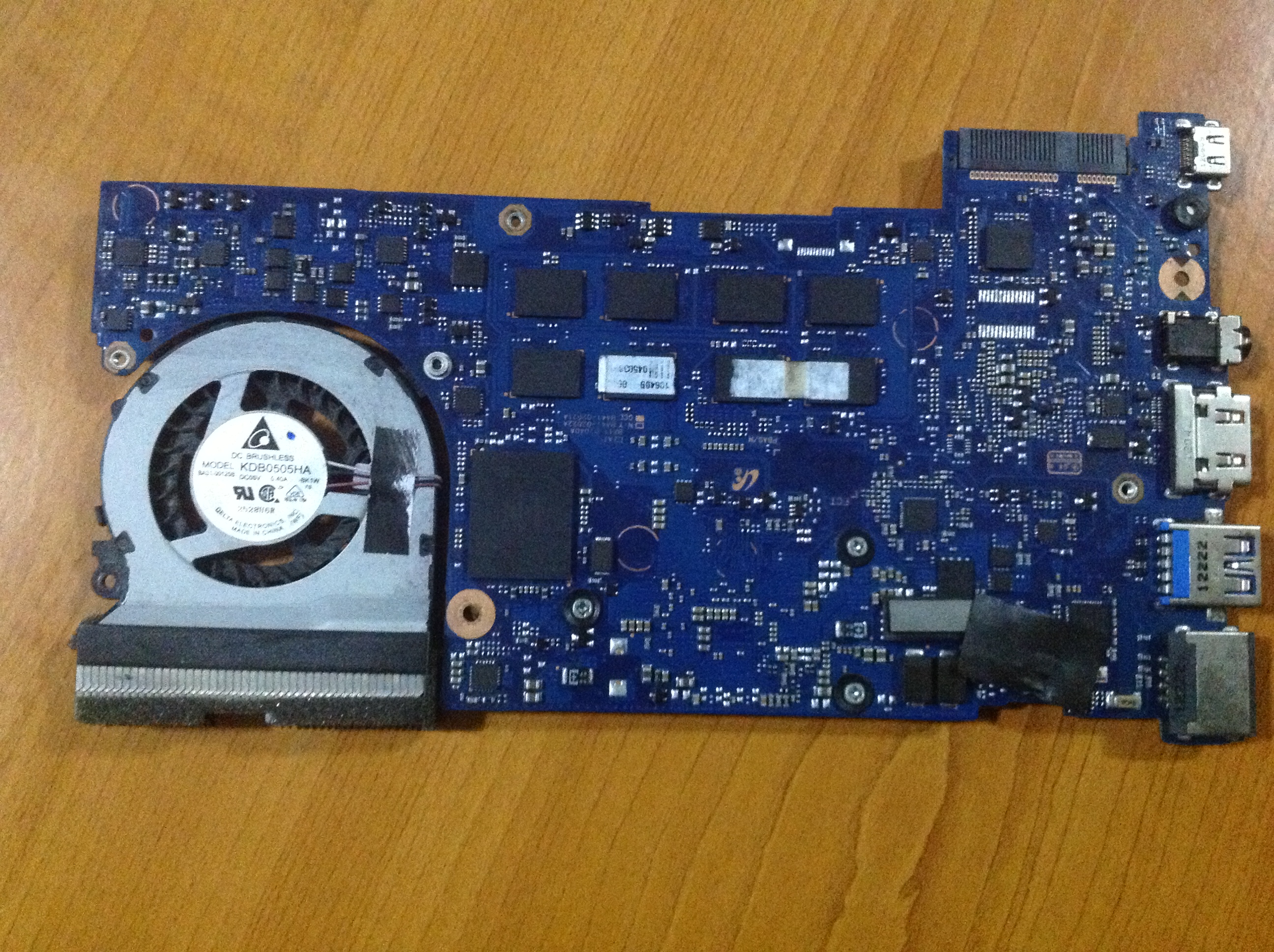

    Here's the image.... I haven't touched the board, still waiting for customer confirmation.

      Please can you upload dump for your board . Check the one post in this thread but not working. Got one working but with admin password .

          Re: Samsung NP530U3C BIOS dump file
          from working machine with win7
              thank you very much it's working now.
