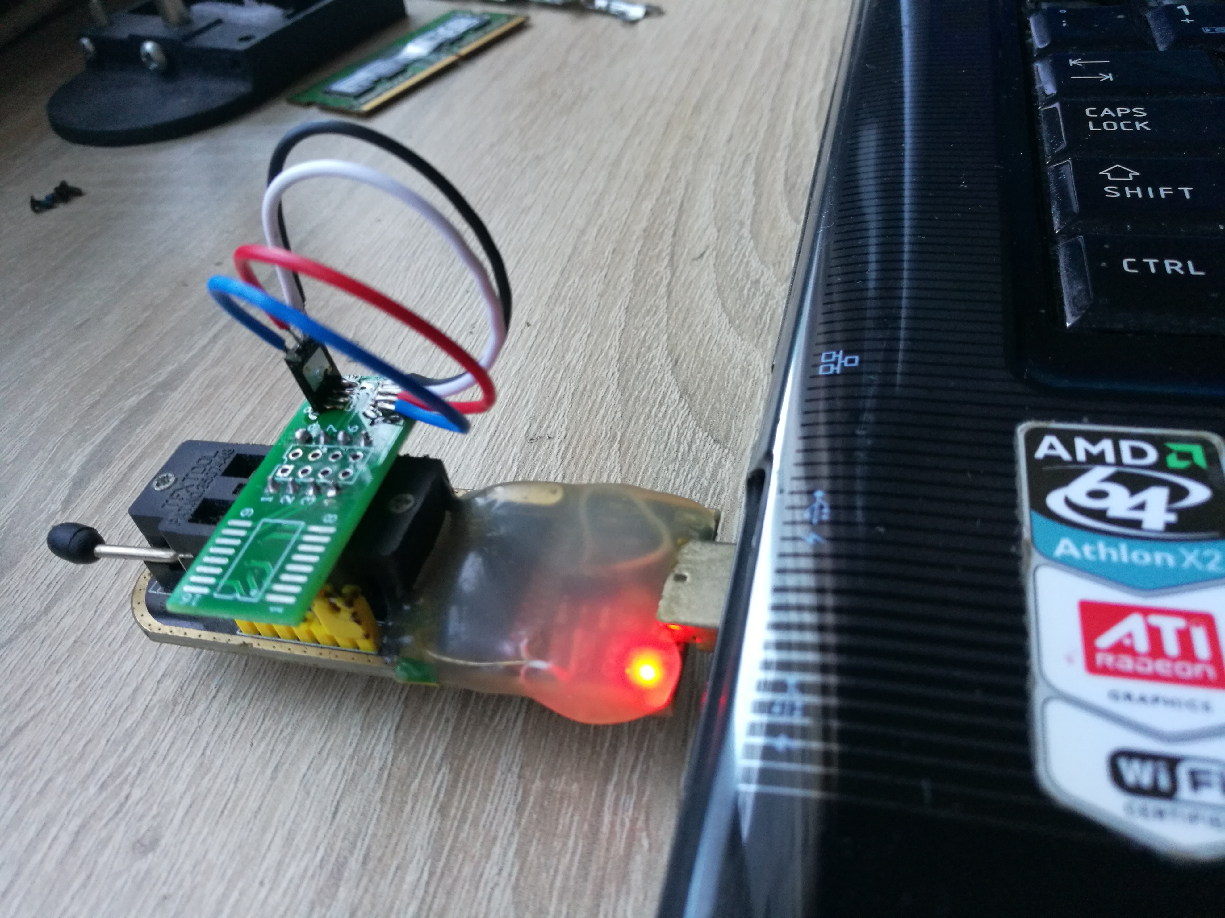

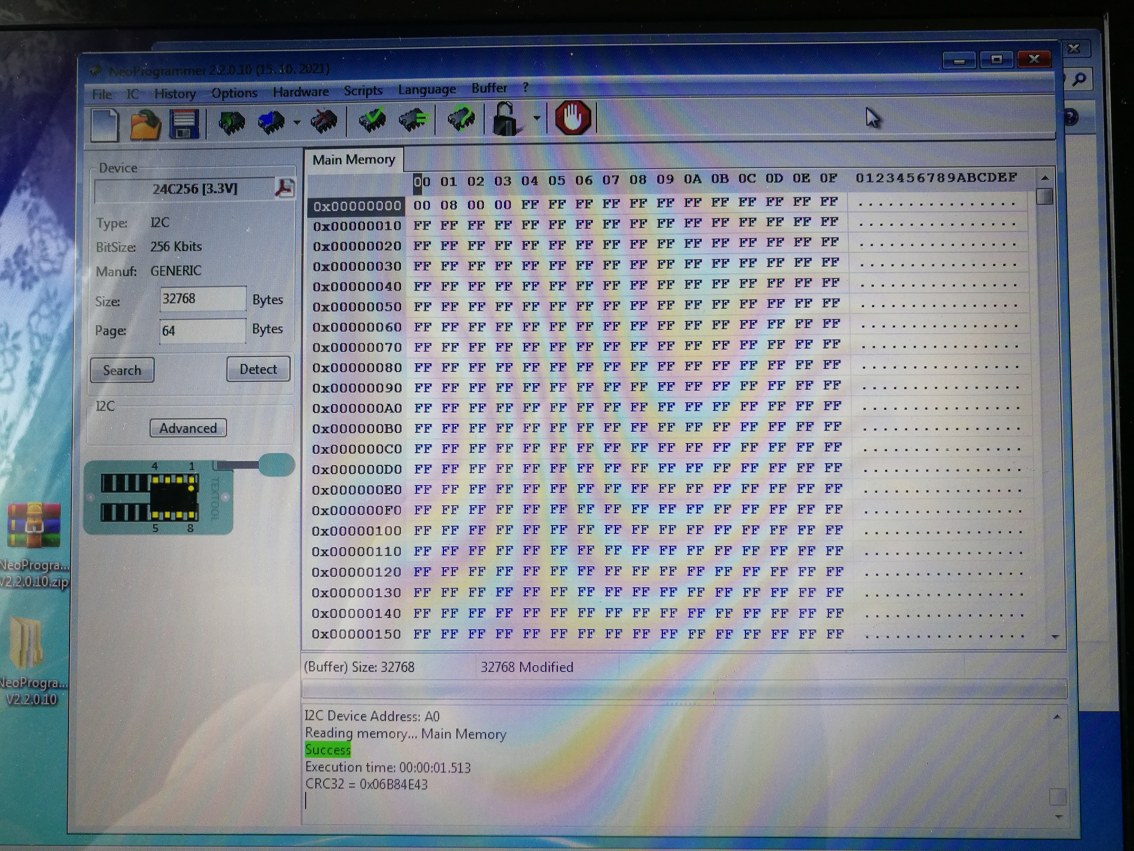

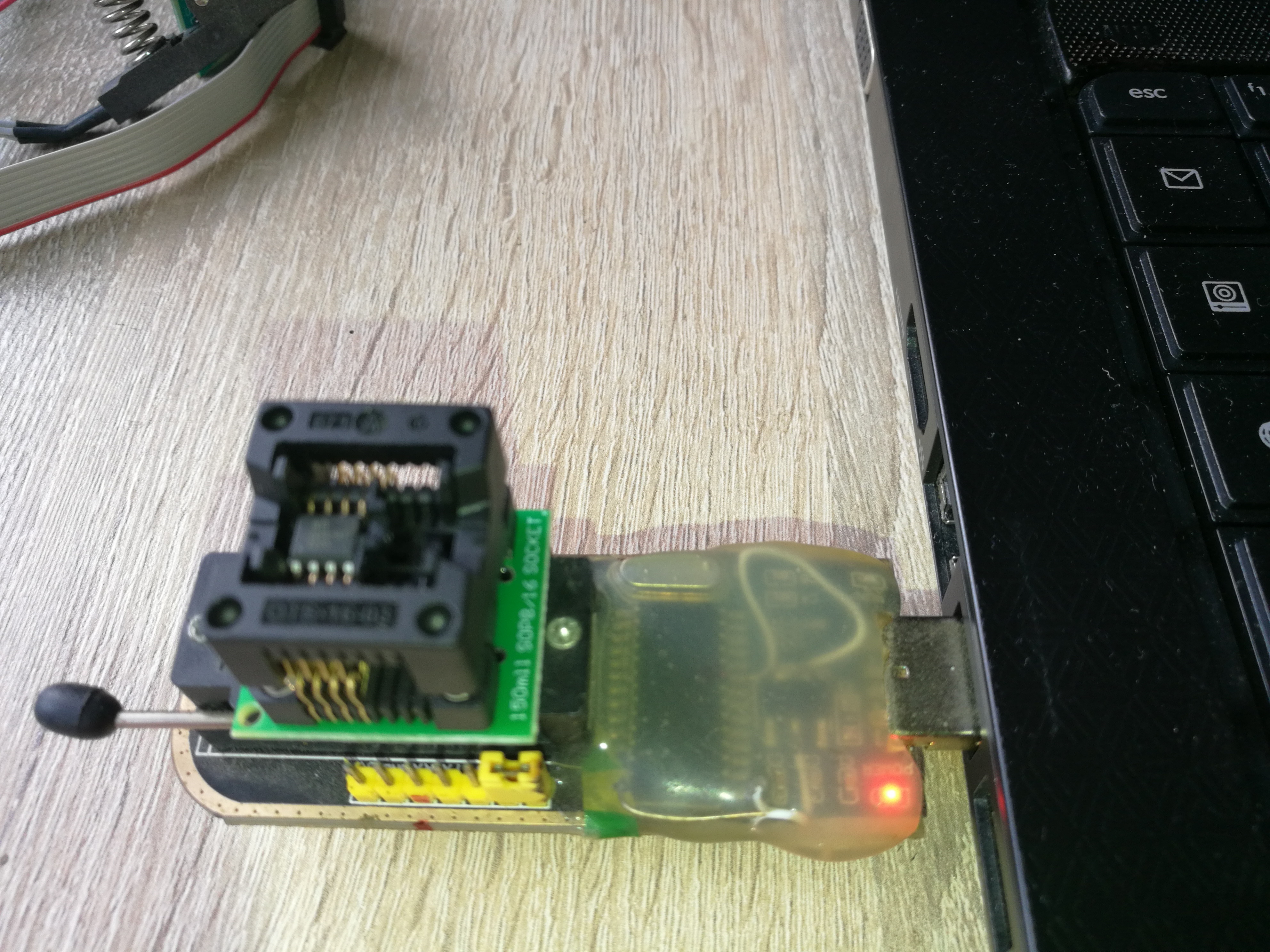

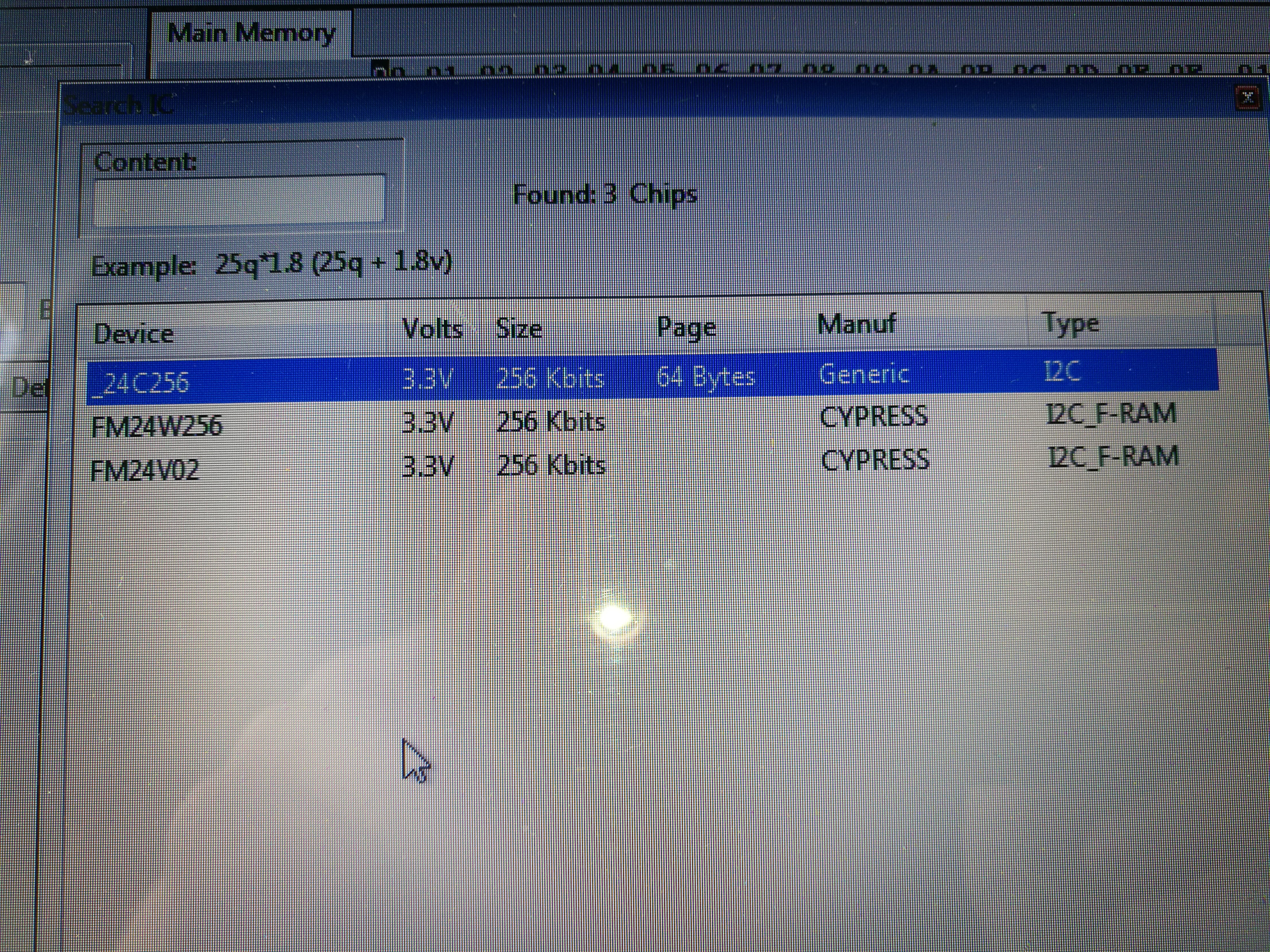

                                    Here is the firmware for PD controller U15 CAT24C256WI-GT3_SO8. Extracted with Neoprogramer 2.2.0.10 from laptop:
                                    BIOS: Giga device, GD25R256EYIGR
                                    Lenovo Thinkbook 15 G4 IAP
                                    S/N: MP2EK6MY
                                    MTM: 21DJ009RCK
                                    MO: MPNXB330709A
                                    Motherboard: HLXA4 LA-L931P Rev:1A
                                    Hope I did it right.
                                    Hope it helps.
                                        S/N: MP2EK6MY
                                        MTM: 21DJ009RCK
                                        MO: MPNXB330709A
                                        Hope it helps.
                                        The RESULT is all back to NORMAL., I was really thinking to discard this board. But anyway all came back to 20V & get the perfect display. Thank you very much.
                                        • bsloboda
                                          • Mar 2020
                                          • 8
                                          • slovakia
                                          #60
                                          Fantastic. Happy to read that. Did you flash the bin provided or you repair it other way?
